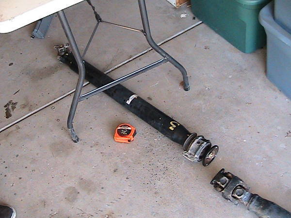

    • Rear Drive shaft (installed)

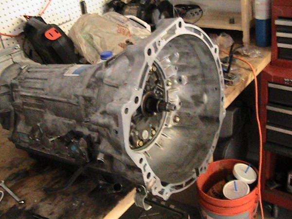

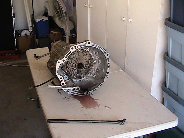

    Update:

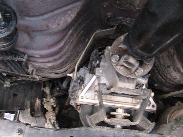

    Disconnecting sensors and shifter linkage..
    Removed the driveshafts

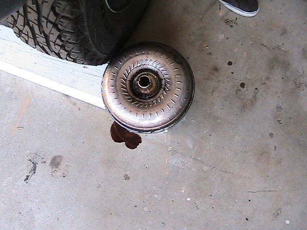

    Dropped the transmission out (finally, took all day) and removed the torque converter

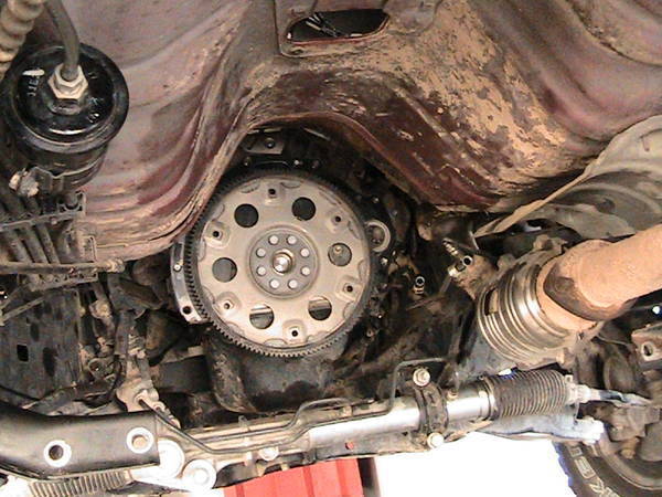

    Torque converter
    Empty under there.. and the big ass gear
    2wd transmission cross member

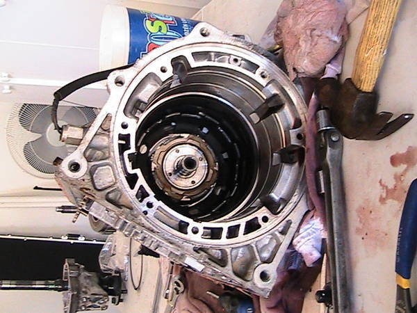

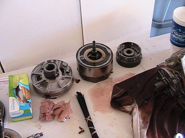

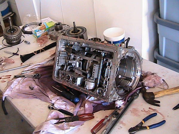

    Removed bell housing, pan and valve body
    Removed the rest of the internal parts
    empty tranny..
    the guts of the automatic..

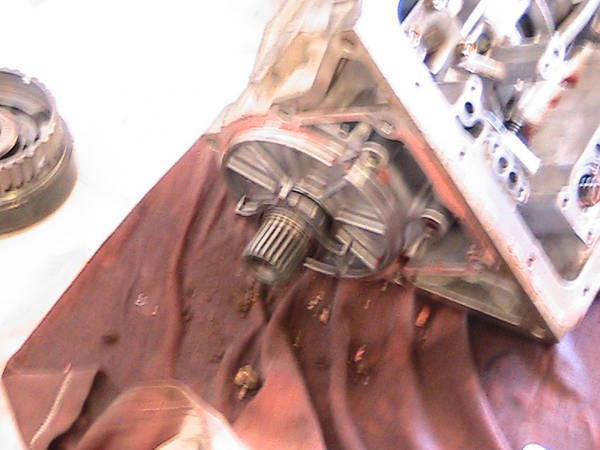

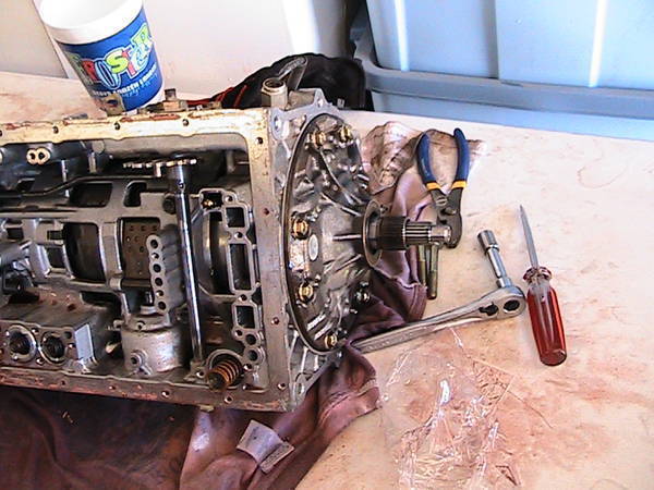

    2wd tail housing and output shaft
    4wd shaft installed in my transmission

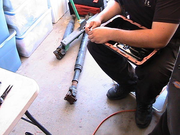

    reinstalled all the internals, new filter, and cleaned up the seal of the old pink sealant
    scraping it off of the pan..

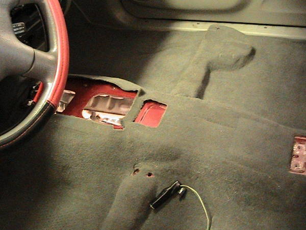

    pulled out the seats for easy access, and cleaned it up! then pulled the shifter out.

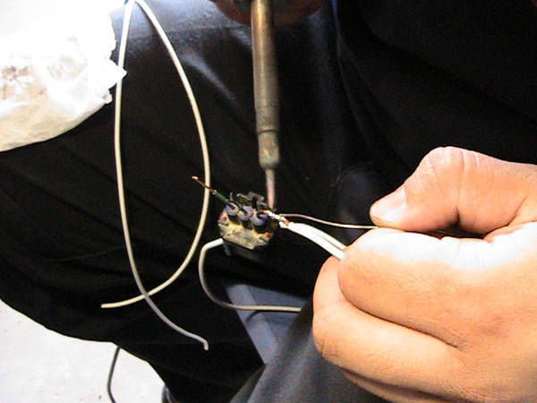

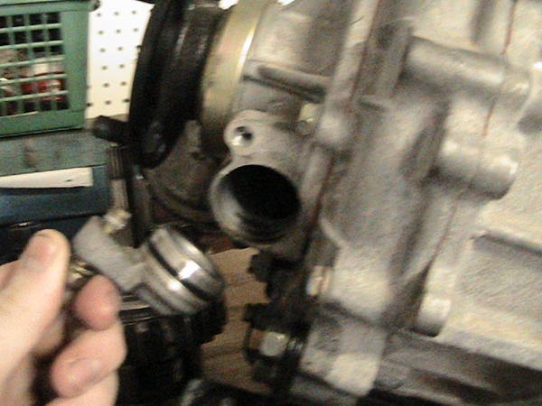

    can't determine why there are no freakin speed sensors in the 4wds so i have to buy one to go where this plug was
    extending the wires for the speed sensor
    installed the bell housing
    all ready to go back into the truck :D
    And after Sorting out the speed sensor, which fixed my shifting,
    The final problem was that my fuse for the gauges was blown!!!
    me and brian think it shorted when he cut the wires..
    so disconnect your battery!!
    But now the transfer case is installed on my truck,
    and Everything works perfect :D
