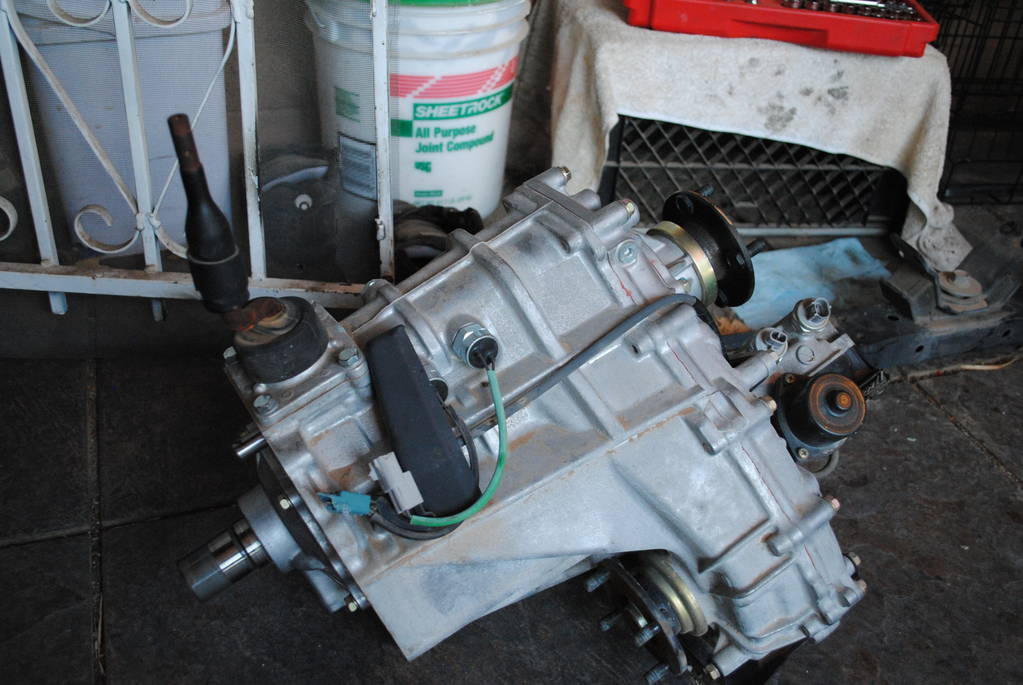

  18. Mar 26, 2012 at 1:03 AM
    #118
    tacopyro
    tacopyro Forever learning...
    Sep 3, 2010
    #42664
    91
    SoCal
    01 Taco Pre SR5 V6 - 4WD
    Roll n Lock Cover and Stainless Step sides. New Mods. AFE Air Filter, PS Mag-Filter, Bilstein HD rear and 5100s Front. Michelins LTX MS2. Taurus E-Fan with FK50. Tundra Brake Upgrade. External Tranny Cooler. HO-Alt CS144 Mod, OMD Leaf Springs. Bull Bar. 4WD VF3AM Transfer Case, ADD/Manual Hubs. Supercharger with URD 7th injector. 4wd conversion complete Future Mods. rear sway bar, box the rear frame. I Love my Taco!
    Hi!
    Hope you dont mind me bringing this thread back, but i've been searching for a couple of weeks now and i couldnt find an answer on how to wire up the transfer case.
    I noticed in the pic that you have the transfer case with the Actuator, I'm wondering ... how did you wire it up?
    I have an 01 prerunner and have most of the parts for the conversion except a transfer case and f/r drive shafts. the one you have seems to be the most abundant one available so i wanted to go with that option. in anticipation, i already have the shifter knob :D
    also, did you have to swap the ECM? add a 4wd ECU ? change /add wiring?
    its quite curious that the forums dont have this info.
    (if they have it, i havent stumbled over it yet)
    Im hoping to write it up later for others as reference if they want to do the same...
    Thanks!
    CK
  19. Mar 26, 2012 at 1:19 AM
    #119
    G scott04
    G scott04 [OP] ...
    Jan 17, 2011
    #49443
    4,876
    Garrett
    Mesa
    04 PreRunner
    Damn it I just accidentally deleted my longer response, anyway, yes the info is damn hard to find. i ended up going all manual so I didn't have to worry about any actuators, I bought a second transfer case with the j shifter. But anyway no you don"t have to mess with any computers or ecm's or ecu's, you just need a simple switch. and whatever transfer case you choose, Go manual hubs up front.
    But no worries I have a diagram I was given from ttora. one sec
    And yeah my bad I haven't updated this thread, Been answering questions as they come along in pm's. maybe once I fix my stupid gears up front and wire the light ill update
  20. Mar 26, 2012 at 1:25 AM
    #120
    G scott04
    G scott04 [OP] ...
    Jan 17, 2011
    #49443
    4,876
    Garrett
    Mesa
    04 PreRunner
    If you would like to wire it here is a pic of the inside of my actuator and what each contact does:
    And here is what the e-locker wiring looks like:
    Now you're going to have to do some bench testing to put it all together. 'Common' is wire #7 on the e-locker diagram. 'Motor 1' and 'Motor 2' will be wires 5 & 3. I can't tell you which, you'll just need to experiment. 'Limit 1' and 'Limit 2' will be wires 1 and 2. Again, I can't tell you which without testing it. Don't worry about wires 4 and 6 on the e-locker diagram unless you want to wire the 4WD light. Concentrate on getting the actuator working with a DPDT switch first.
    What you are trying to accomplish is to allow the actuator to turn in one direction until it hits the end of the limit contact going one way. Then, when you flip your DPDT switch in the other direction, you want to reverse polarity to the motor making it spin in the opposite direction until it hits the limit switch on the other side.
