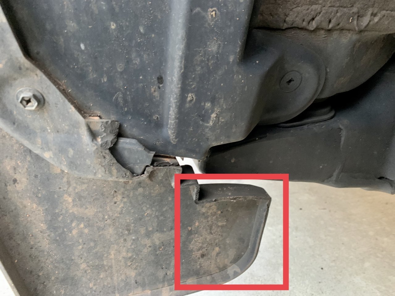

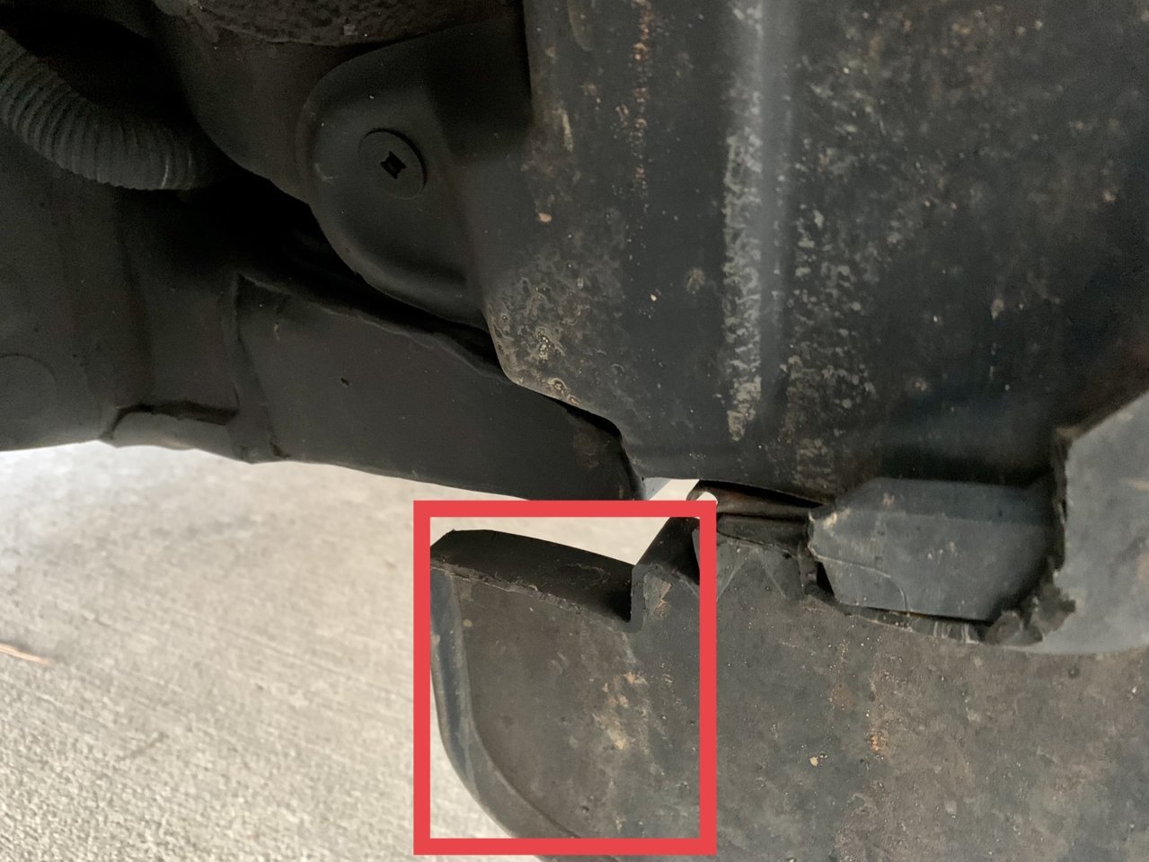

    The smaller STMaxx.
    No hardcore wheeling. Just general Tom foolery from time to time. Had them fully stuffed many times and never had any issues. Well at least not on the cab mount/mud flaps. I’d rub on the front bumper/plastic in some situations. Just never bothered to address it.
    Below is my current set up. Same model mud flaps as I had on the 2nd gen, with similar dremel action. And my wheels are the same spec as the previous set, but on 265/70 currently. I’ve also got a semi mild CMC already. Should be adequate for 285/70 or 255/80. I will likely have to cut off the red boxed area on the flaps if I go to the 33ish range tire.

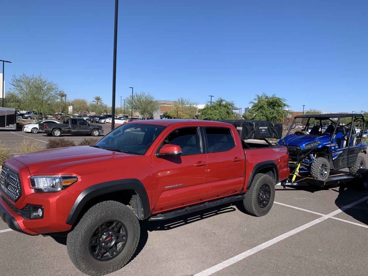

    255x80x17 on real 4Runner Pro wheels. Had to cut some plastic front and back of wheel well and heat-gun/2x4 flatten the random protruding shapes of the fender liner. Have alignment with +2.4 caster, stock control arms and 1.5” “lift”. I’ve flexed in every tire orientation possible. No rub. No CMC.
    You can zoom in and see the aft fender trimming I did.
    Terrible gas mileage with 33” E rated tires is a given

    You bastard! Driving around with your SxS hooked up...looking like some fun to be had!
    Was seating on a 4 seater next go around, mainly for a longer wheel base and a place for the dog!
