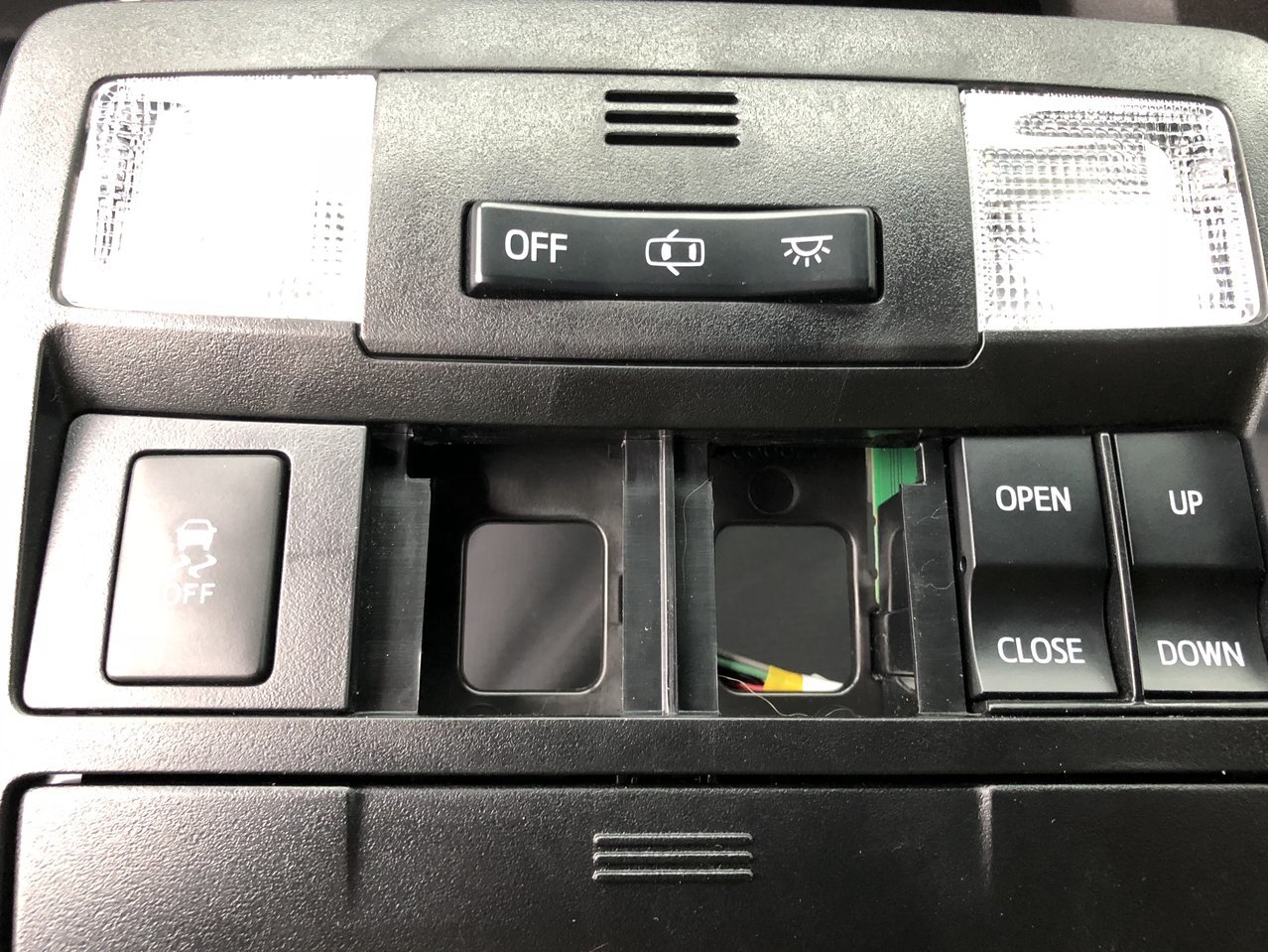

  2. Jul 29, 2024 at 8:38 AM
    #202
    Southwest Tacoma
    Southwest Tacoma Well-Known Member
    Mar 5, 2020
    #321331
    396
    Southwest
    2020 Super White SR DCSB

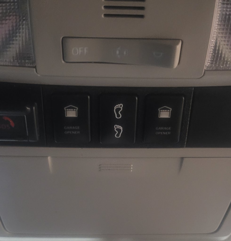

    That is a dual function swich. The top is for the drivers side footwell lights (left foot) and the bottom is for the passenger side footwell lights. (right foot). After these were installed, I added footwell lights under both back seats too and they are now wired to the passenger side switch.

    These are the lights I used.
    BRIGHTEST Light Bolt - Flush Mount 12V LED Light for Bumper, Grille, Cars Interior, Dash, Ambient Lighting, Motorcycle w/SLEEK Aluminum Housing & Screw Nut (11 mm Black, Cool White LED) https://www.amazon.com/dp/B01ADHUXGU
    The swich I had custom made on Amazon. I sized the images of the feet, uploaded them and customized the button selection.

  9. Aug 8, 2024 at 12:48 PM
    #209
    ADKMTNMAN
    ADKMTNMAN Active Member
    Jul 21, 2010
    #40557
    31
    Upstate NY
    2017 Tacoma 4 Door Quicksand
    I agree... I think I may re-route mine to the over head console as well. I think its easier access to it and looks a lot better there

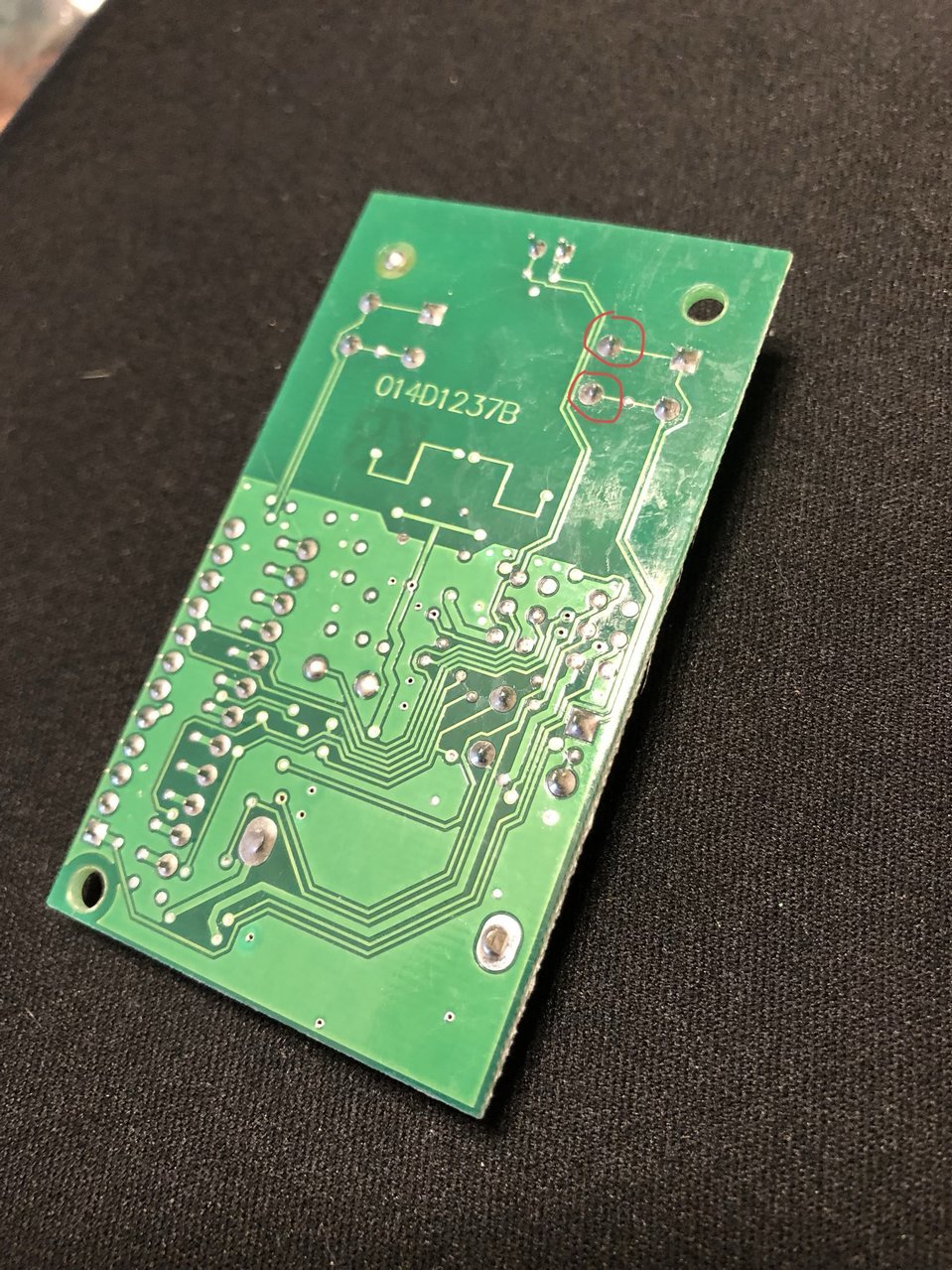

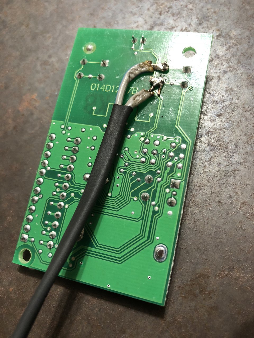

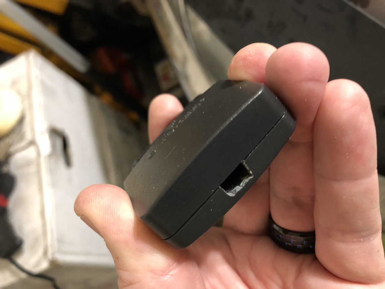

    I have the same style and brand clicker as you and am getting ready to do this mod and am trying to confirm if I need to solder my wire below the circle like it appears on your or right on top of it like you did on the right hand side.

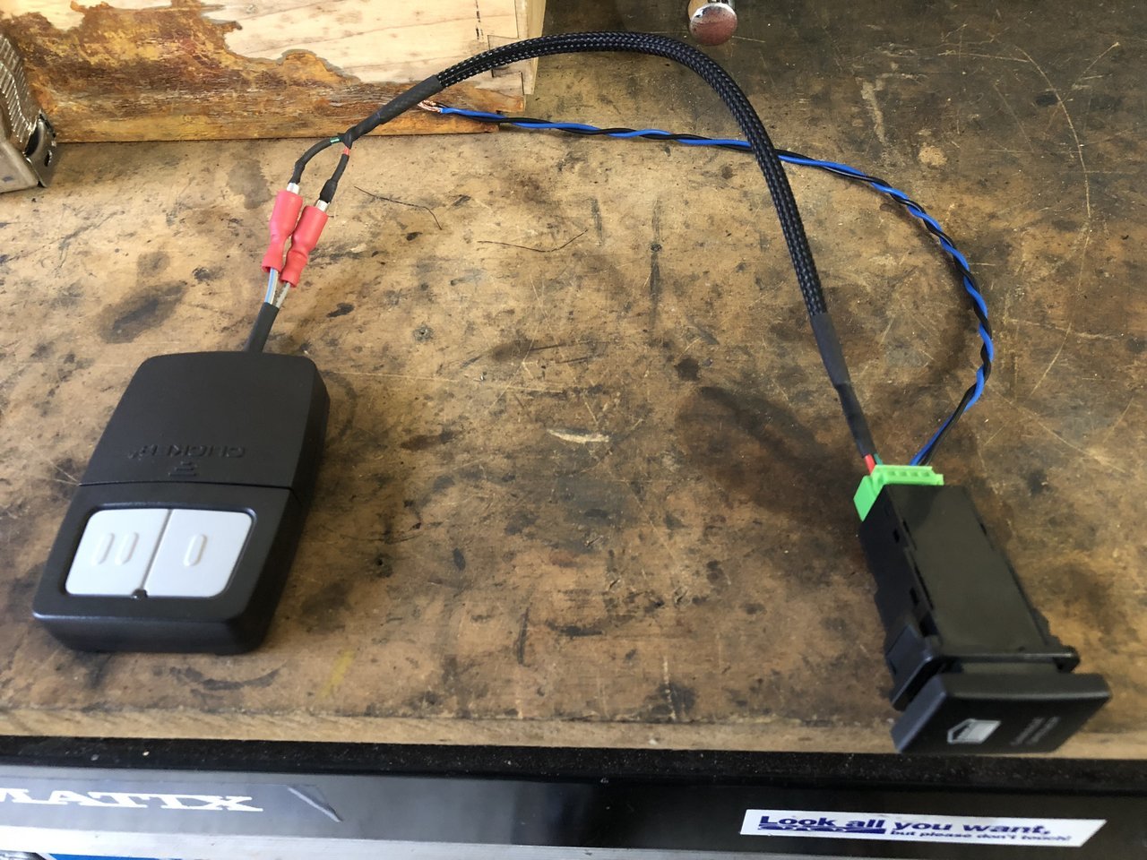

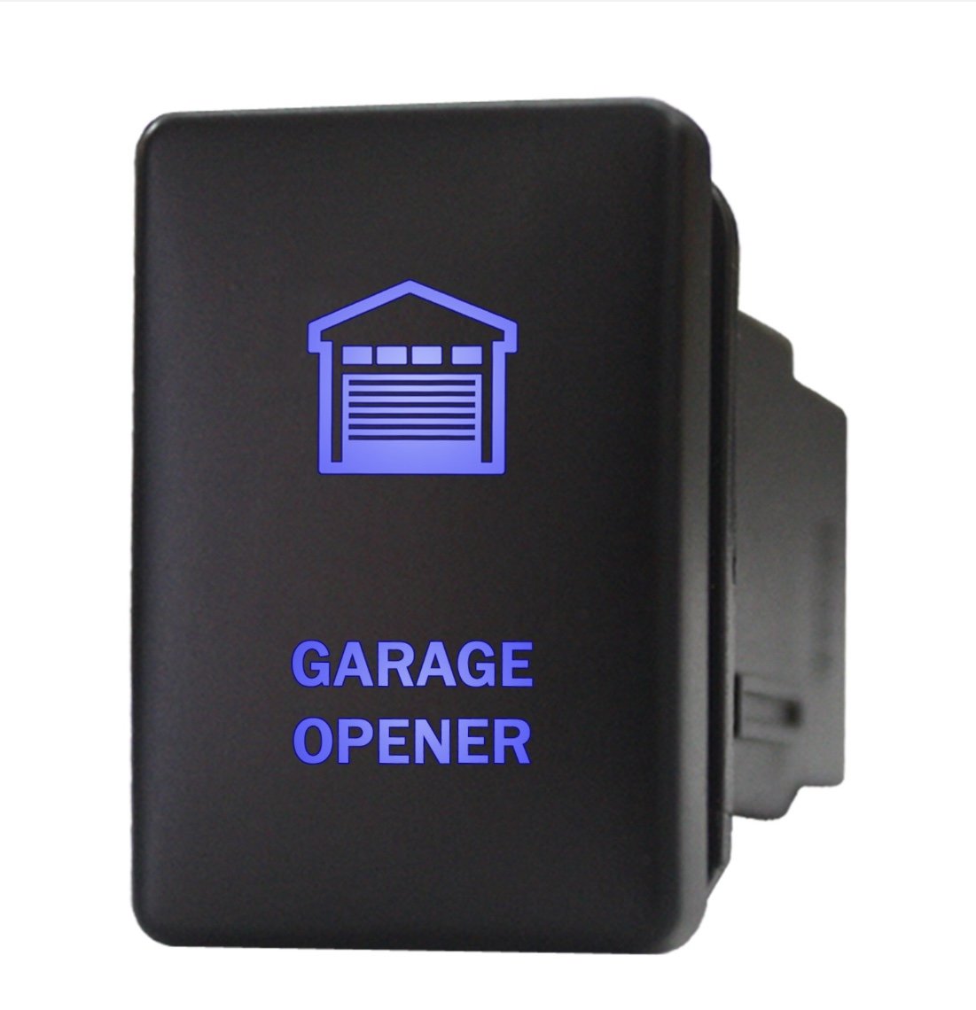

    Hey All,
    I just got my second remote in, so if I bugger the other one up I’m not left without a way to operate the garage door. And I also received my switch from Air On Board, and it shows a relay and 1amp diode, relay with 86, 87, 85, and 30 on it as contact points, as well as a fuse. Can ANYONE help me out an tell me if 1) does anyone sell the relay, diode, and fuse needed? 2) if not can someone point me to where I can get these items, and lastly 3) which ever option I have received said parts, can someone step me through where and how to connect these items together. Also, I thought I read where someone installed there’s minus the battery so it would not have to be exchanged once it went low or dead. I do know that the 12v has to be stepped down so as to not overload the remote because it operates on 3v. But the lights of the switch runs off the 12v system of the truck. Anyway, I’d really appreciate any help I could get, thanks..
    Rip
  12. Sep 10, 2024 at 12:13 PM
    #212
    oostroma
    oostroma (Boomer)
    Aug 21, 2017
    #227497
    4,262
    Ontario
    2017 TRD OR access cab- BBP colour
    TRD emblems, tinted windows, OEM running boards, AVS vent shades, RMAS upgrade, LED lights in front and rear, interior LED lighting upgrade, LED lighting in bed, touch control dash mount for LED lighting, auxillary 12v and USB jacks in bed, replace all speakers with Infinity, custom mod with Bose tweeters, TRD Pro illumination mod...
    IMO, I think you are making this more complicated than needed. The battery in the remote will last for several months, if not a few years.
    As far as needing the relay, all you need to do is solder a wire to the 2x contacts in the remote and run the wire to the switch. The switch just needs to close the contacts temporarily. No power required for this. Only power needed is to illuminate the LED in the switch.

    If you want to use truck power, buy a 12V garage remote. You don't have to use resistors or anything. I went thru all the thoughts you are going thru and just kept it simple. Mine is hard wired to ignition sourced power and then the buttons on my overhead switch panel.

    Then why does it say use a relay and wire it connecting to this point (XX) and this wire to (XX) on the relay and the other two to (XX & XX) not to mention it says you need to wire a diode in.? I wished I could watch a video of someone stepping through this….
  15. Dec 16, 2024 at 5:24 PM
    #215
    DSRamsey13
    DSRamsey13 Well-Known Member
    Aug 26, 2019
    #303324
    692
    '23 TRD Pro Solar Octane
    Center console organizer.
    I’d like to help you… where does it say “relay” and “diode” and stuff? Tried to do a quick check from your post and from the original post. Should be as easy as what @oostroma states above in his post.

    The switch is just mirroring the button function on the remote.

    Okay, I have a remote that has no underside with any circuitry at all, it’s all on one side, so I would connect one wire to the front side and the other wire to the back side circuit. Just basically making that switch mute and the new switch I’m installing the one true switch. But I have 2 questions:
    1) can you note make a jumper or connect the wire for the light to another switch beside it on the “lighting” wire without having to install a dedicated power wire and add a diode to step down the voltage?
    2) is there a way to make the fob wired into the truck’s power instead of relying on a battery that would eventually have to be replaced?
  20. Jan 23, 2025 at 7:20 PM
    #220
    RippNU1
    RippNU1 I keep telling the voices in my head…..”NO!!!”
    Mar 5, 2024
    #445294
    37
    Bama country baby!!
    Super White TRD Offroad
    LED Headlights LED Taillights JL Stealth Box Audio Control LC-2 MTX Jack Hammer Sub Amp Garage door opener with battery omit
    Yes that is true, but the lighting circuit and wiring to eliminate the battery would be advantageous to those with little electronic backgrounds.
