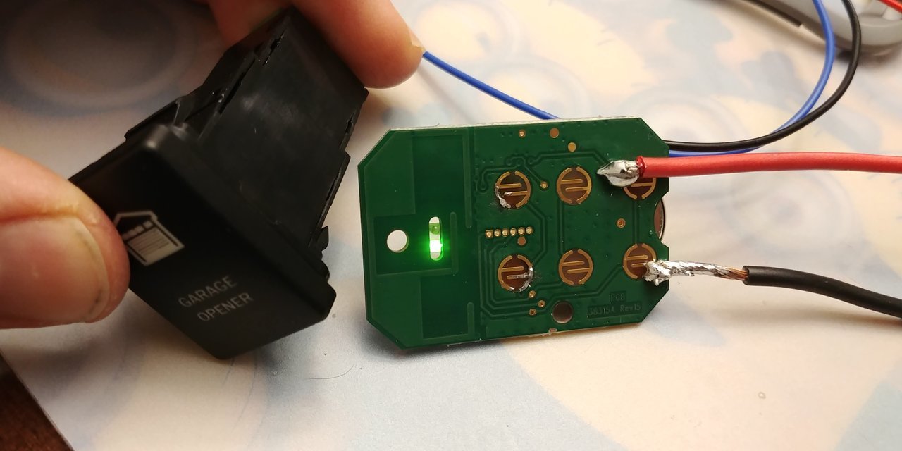

    Yup, test it by shorting across the contacts with a paper clip.

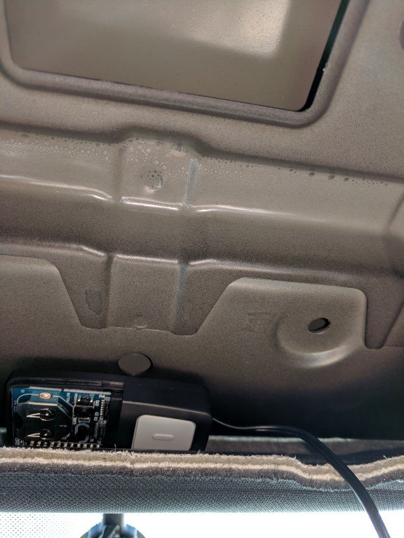

    Two questions: The link to the garage door switch isn't working. Can someone repost? (I searched but can't find one site the OP provided.
    2. Has anyone see a double rocker switch with garage door printed on it? Thinking this could be a good option for those who want to have the ability to open more than one door. Thinking something like this but with Garge Door "1" and "2" printed on it.

    Go to Air On Board and you will see Toyota switches there. There are two sizes, yours and one that is more rectangular instead of squareish.

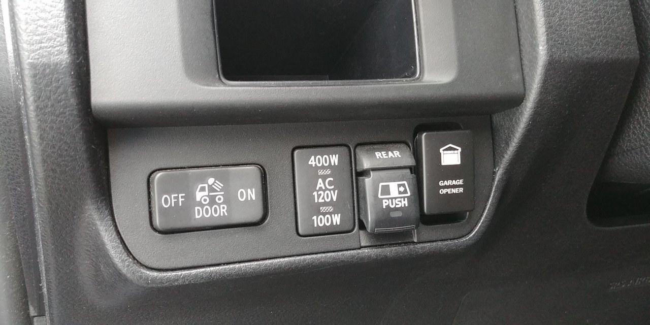

    Kudos to the OP for the slick OE looking solution

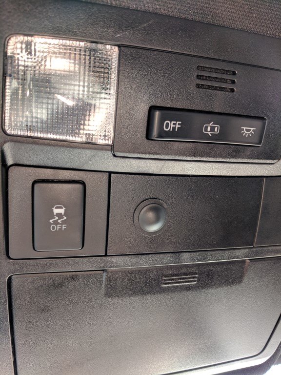

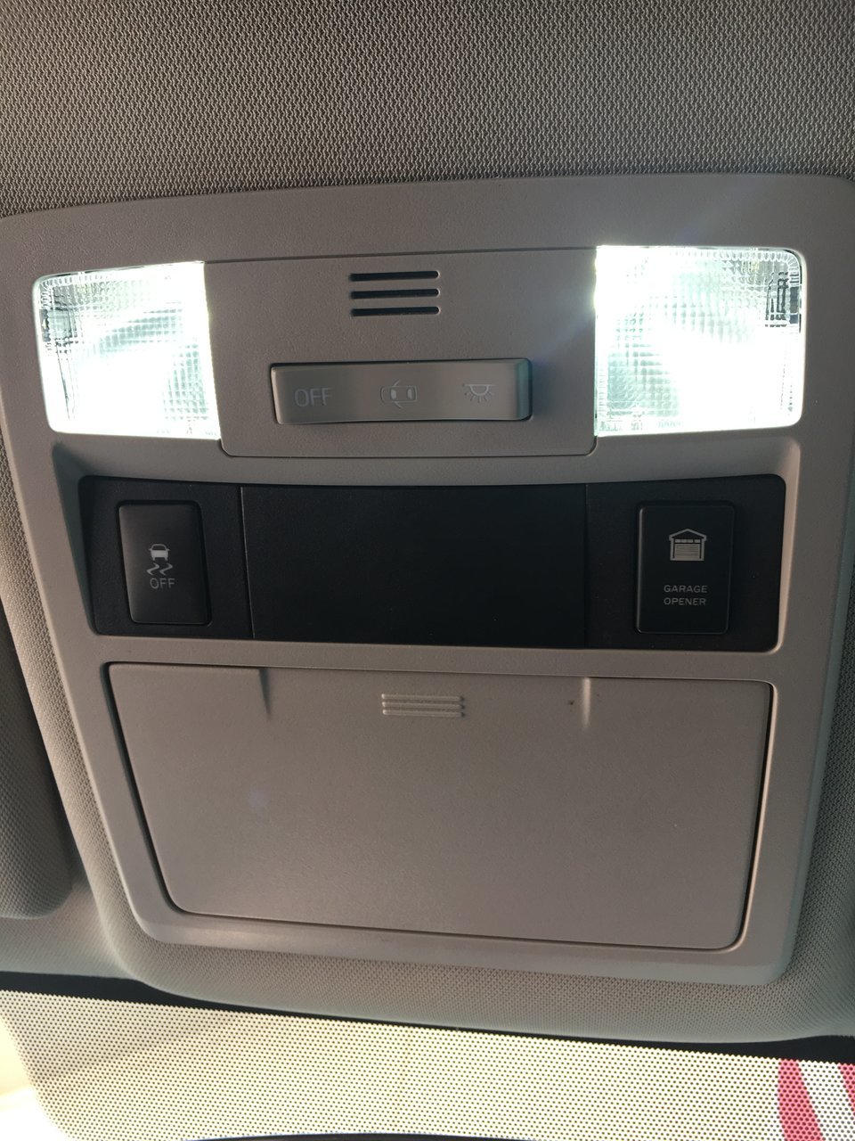

    Posted a while ago in "what have you done today", but here is how I added an opener without the cost of homelink using the overhead panel. Just a different option.
    Finished image first:
    Step 1: Lower the overhead panel (was able to do it without tools) and remove the center blank. (Note that the passenger side area is much more difficult to use than it would appear).
    Step 2: Drill a hole the size of your push button switch in the correct location of the center removable panel (easy to see where when you are looking at the assembly). Could easily fit two buttons if you have two doors.

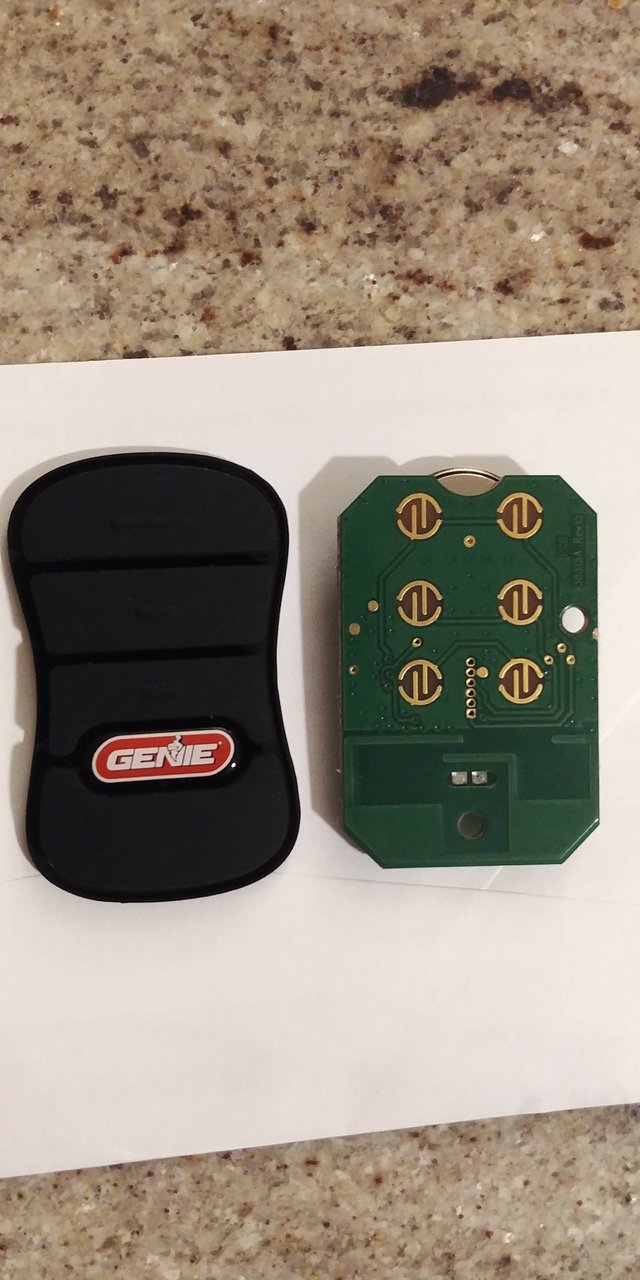

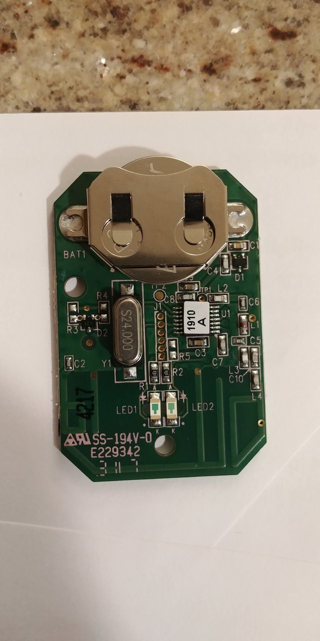

    Step 3: Wire up a garage door opener that you have already programmed to a momentary push button switch. Check the circuit board for which legs to use, almost certainly will be diagonal from each other. I went an extra step and added a simple two wire barrel connection for easy install and removal if ever needed.
    Step 4: I notched the plastic housing of the remote for the wire to get out and reassembled (left battery door off). I added strong Velcro to the back.
    Step 5: Stick the remote up into the opening out of the way. Connect the wires, reinsert the center panel, and push the overhead unit back into place.

    where. Holy crap that is awesome. I'd do the mod just to have this (or something as funny) switch to match my license plate (YARM8E)
    I can't seem to find any Toyota Garage momentary switches anywhere right now on the MICTuning or AOB sites.....

    One overlooked fact that may have been mentioned is when your remote is no longer working, you will have to access that remote control board thats tucked away and replace the battery, it’s not often, but it’s not using the cars battery to maintain its constant power...so don’t make it too locked up and sealed.
