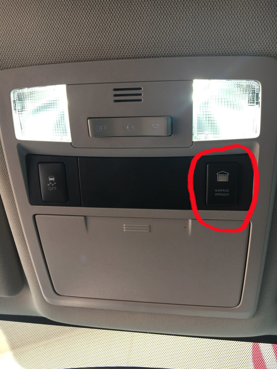

    For all of those worried about AoB switches being latching... You can open them up and remove the latch mechanism to turn them momentary in about 30 seconds. Or, I have a handful of the momentary thin/tall garage door switches from AoB on hand if you'd like to purchase one.
    For anyone who wants to drop cash on a garage door button (or buttons) that turns on/off with the truck, has backlight and also lights up the additional light when depressed - pre-wired and ready to go, I have sold a few of those. Heck, I can even wire in a battery replacement so that the battery never dies (without the truck's battery dying), if you'd like.
    It's not hard, but some people find this stuff very intimidating, so it's a service I offer.

    Do tell. I was concerned that they may be sealed. How is it done?

    I’d be interested in one of these, do you have a pic of one of the switches?

    What you need to do is first remove the cover by holding the switch in one hand then with the other pull firmly on the cover just make sure the switch is in the off position
    Then you can open up the switch with a small screw driver you will see it unclips towards the back of the switch on one side
    Once you have done this you will see the circuit board and at the front near the lights in the middle is the switch mechanism
    On top of the switch you will see a small triangle and when you look into this you will notice a small copper looking wire all you need to do now is get a small hook and pull this out and then the switch will be momentary

    You have won the internet today. Thank you so much, just switched it to momentary.
