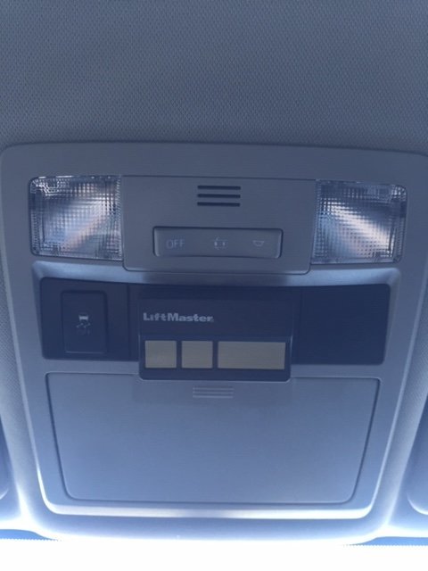

    Another vote for the non wire variety! Anyone know what color spray paint would match that grey? (2016 Tacoma, for reference) Flat black would be good too, I guess.
    Again, zero MacGyver skills here. no soldering/wiring in my repertoire. :anonymous:
    tonered likes this.

    So.... I added the monetary push button mod on my overhead console, but it has a very limited range. I can only open/close from the driveway, normally the opener worked 6-7 houses away. I have a feeling the lane guidance radar or anything else going on near the front winshield is messing with the transmitter.
    Anyone else experience this?
