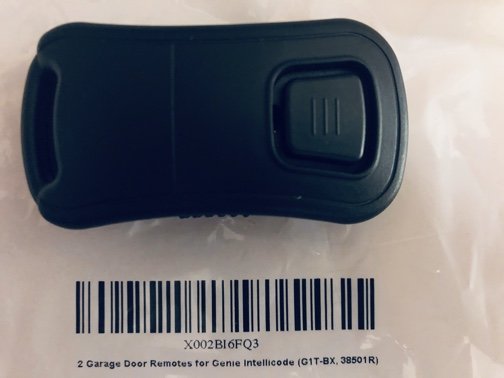

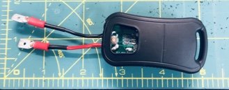

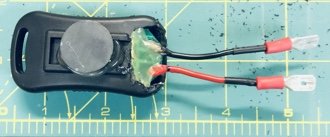

    Just completed Phase 1 of this mod. I failed on my first attempt with one of the remotes like in post #20. The lesson of that story is to make sure you check with a paperclip which pins you want to solder to. Ordered a pair of replacements for $18 off of Amazon.
    https://www.amazon.com/gp/product/B07Y3VFLGD/ref=ppx_yo_dt_b_asin_title_o03_s00?ie=UTF8&psc=1
    Here is what it looks like after I soldered the wires to the remote
    I used this dremel tip to trim the outer casing of the remote
    All snapped back together and some hot glue applied. I got the AOB switch for the lower panel in the center. So I'll have to take that whole dash apart it looks like. Good thing we've got nothing but time.

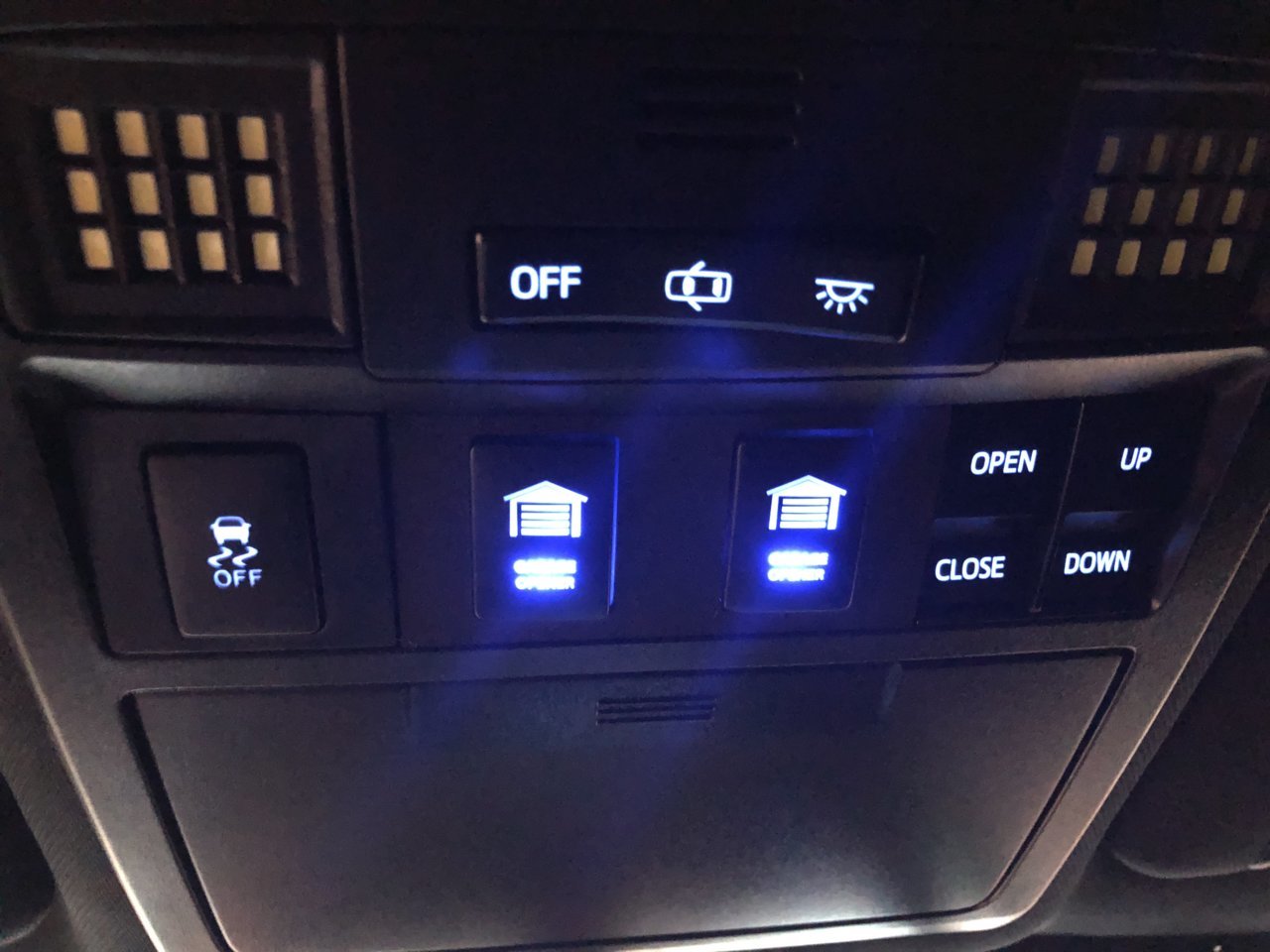

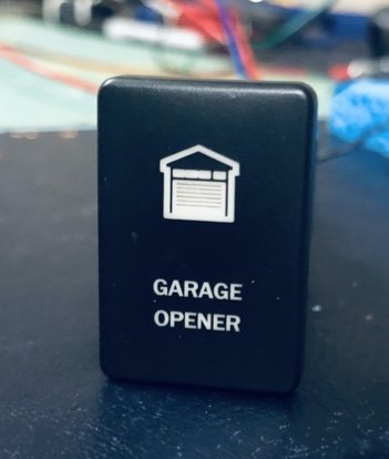

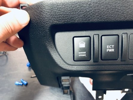

    Phase 2 and a successful installation. The only thing I couldn't figure out is getting the button to light up (more below). If anyone has any ideas please share.

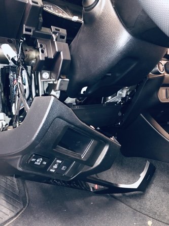

    The downside to the location i chose for the button was having to take the whole dash and center console apart. Seems a lot scarier than it is. This link and video were helpful. First time is slow, but much easier the times after.
    https://www.tacomaworld.com/threads/trim-removal-how-to-solved.470055/page-10#post-17844477
    https://www.youtube.com/watch?v=gDH_rI72GEs

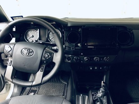

    Here are some pics of the dash and center console removed.

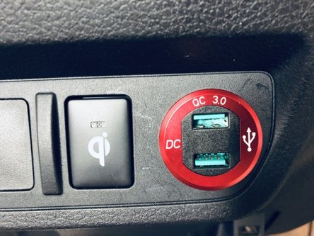

    While I had this location open, I decided to change the power adapter to a dual usb with voltmeter and tuck the factory USB/AUX behind the dash and run a cable up to my DMM.
    Dual USB/Voltemeter: https://www.amazon.com/gp/product/B07GKK9HZT/ref=ppx_yo_dt_b_asin_title_o00_s00?ie=UTF8&psc=1

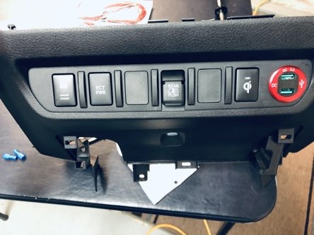

    Here's the panel with the Garage Button and USB installed

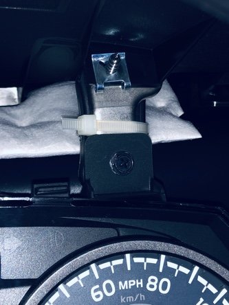

    Mounted the garage remote on the post behind the speedometer. Figured this would be an easy place to get to when the time comes to change the battery or mod it further with power from the truck. So far I have the same range from when the remote was in the little cubby to left of the steering wheel.

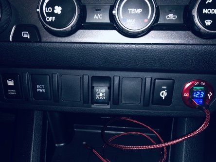

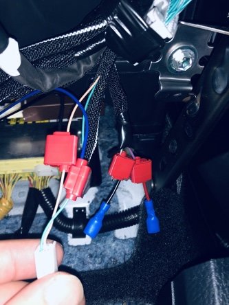

    Quick spliced some connectors to the USB to the exiting power adapter wiring. For switch illumination I tried tapping the light in the Qi tray and the ECT switch but neither got the garage switch to light up. (blue wire (+) from AOB switch to green wire, and black wire (-) from AOB switch to the tan wire).
    And here it is all buttoned back up.
    Thanks to OP for this thread. I liked how it came out, minus the no switch illumination part but I will get that resolved at a later date.

    You need to redo your solder joints, they are cold and need to be redone.
  18. Apr 21, 2020 at 1:02 PM
    #178
    Tacospike
    Nov 19, 2018
    #273198
    14,418
    512
    Two Trucks
    You can just run an add a fuse to power the switch

    Just tap into the switch next to it for dimming. Tan wire and green wire.

    Can you tell me more about how you found which wires to slice into coming out of the traction control switch? TIA
