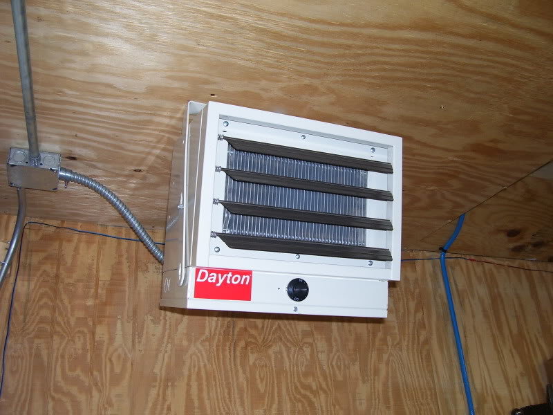

    http://[ATTACH=full]1871897[/ATTACH][IMG]http://www.tacomaworld.com/forum/[ATTACH=full]1871897[/ATTACH]I've got a King 5700W 240V overhead heater that works great in my insulated two car garage. I keep the thermostat set at 50 deg. If I want it warmer when working out there it only takes a few minutes to warm up. The increase in my electric bill seems minimal. It was about $300.
    [URL]http://www.king-electric.com/Products/KBP62.gif[/URL]
