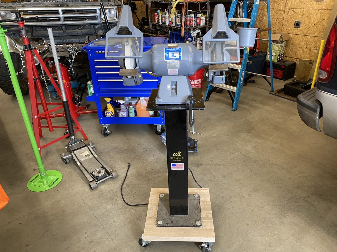

    speaking of good deals, I always view it as not “how much I spent” but “how much I saved”. Picked this Baldor up today, feel bad I practically stole it, drove an hour this afternoon to go pick it up. Lights on both wheels under the shield and the wheels practically new. overall very good shape plus came with the beefy stand.
    I’ll add it to my prior collection.

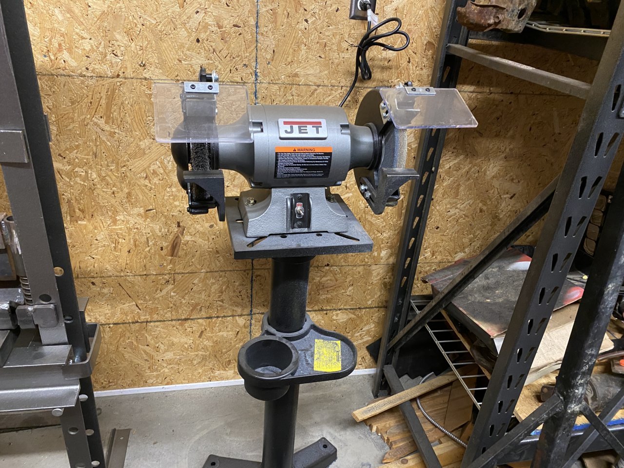

    That's one hellova place for a drink holder. :boink:

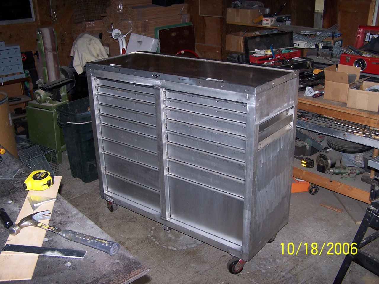

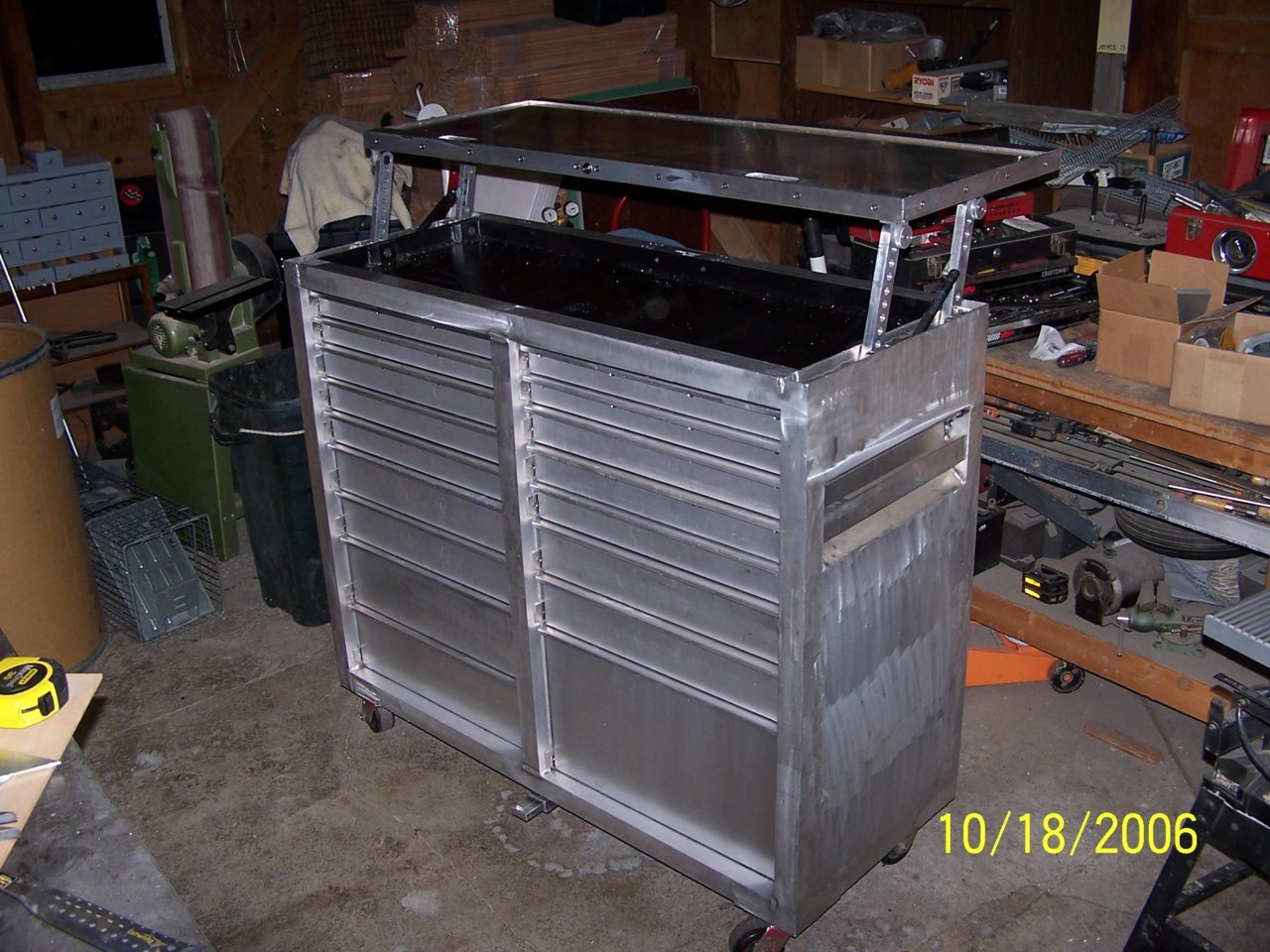

    Here are some pics of a tool chest I built years ago...
    I'd always wanted and needed a large tool chest, but just couldn't justify the spending the money for one. Being an engineer & CAD guy for an aluminum fabricator, I scored a stack of 1/8" aluminum panels that had mild oxidation and were going to be scrapped. I designed the largest tool chest that could be made with the sized panels and this is the result.
    It's got 17 drawers and the lid raises up for access to a space at the top. There's a little over 15 cubic feet of storage. There's a hidden button under the front top rail, that releases a foot pedal. Step on the foot pedal and the lid raises on gas shocks. All the drawers and the lid lock using one key. The design uses t-slot extrusion welded into the vertical frame members. The idea is that should my storage needs change, I can swap out drawers for deeper or shallower ones as needed.

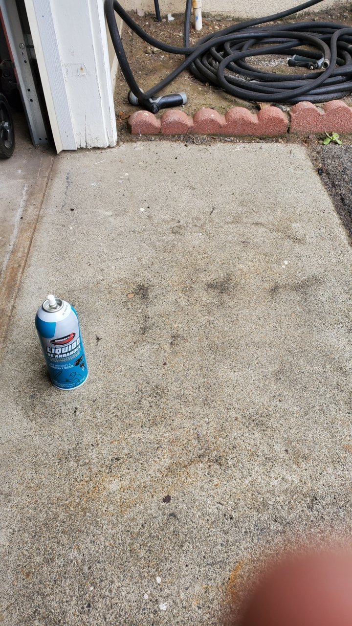

    Lol yeah worked like a charm
