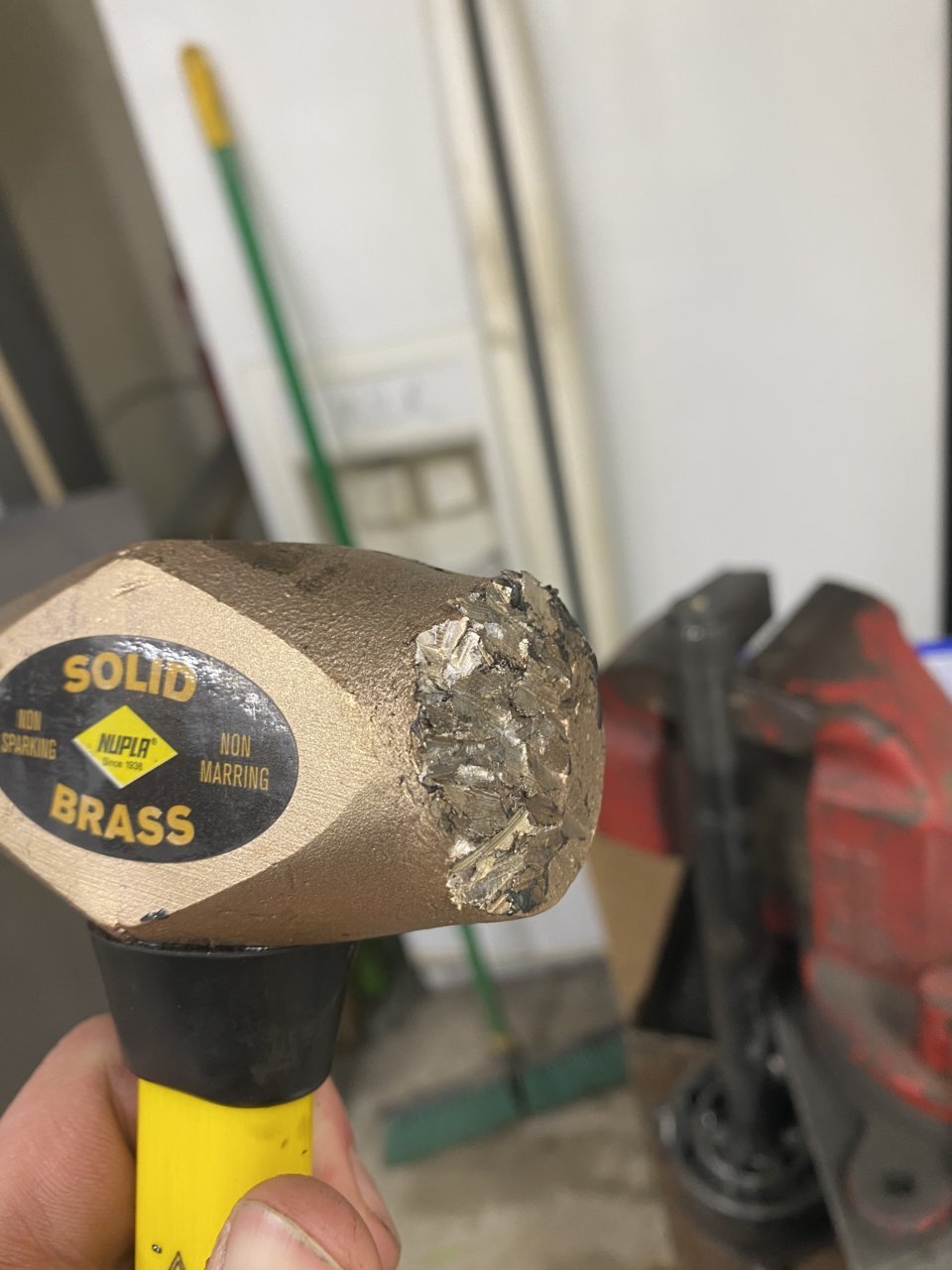

  10. Mar 3, 2021 at 6:16 PM

    I didn’t have them in 4x4 mode, that was the issue.
    I wish I had a 10lb brass hammer.
    I tried that too.

    I’ve never had that much of a is taking the cv off the end of a shaft that is what the video is correct , I usually take a very large cresent wrench adjust slightly larger that the axle shaft lock the shaft in a vise at a downward angle giving enough room to swing a hammer at it usually comes lose in 3-4 blows of the hammer striking the cresent wrench not the axle . But there always that problem one that gives us fits on any job I suppose.

    Talking to anyone that has had to separate the tacoma outer axle joint (usually to put long travel shafts in), they all agree it’s a huge pain in the ass. One friend cut the shaft and disassembled it and took it to a shop to press out. It took 80 tons of force.

    If you don’t get the spring clip to center ( wet with blaster and kinda working the axle in and out a bit) you have to fight and shear the spring steel of the clip, MUCH tougher. I’ve done a dozen of them this way, the first one or 2 were the the worst, the rest were easy like pie once I had the technique down.
    My work bench was a fish gutting table in a former life, it has the hole and pipe built it, drop and go. Longer axle is easier because of the added weight of length.

    IT SUCKS SO BAD!!! I hate it. I have nightmares because of it. When I was rebuilding mine for LT, I had to cut mine as well, take it to a shop and it took all of a 100 ton press to get the end of the axle shaft out of the star piece and chipped the dudes tooling.

    I can get the long side with the pipe and dropping the birf into the pipe. The short side last time I couldn’t get off but called rcv and they said use a brass drift on the cage with the birf at max angle. Sure enough. Couple hood hits and it came right off
