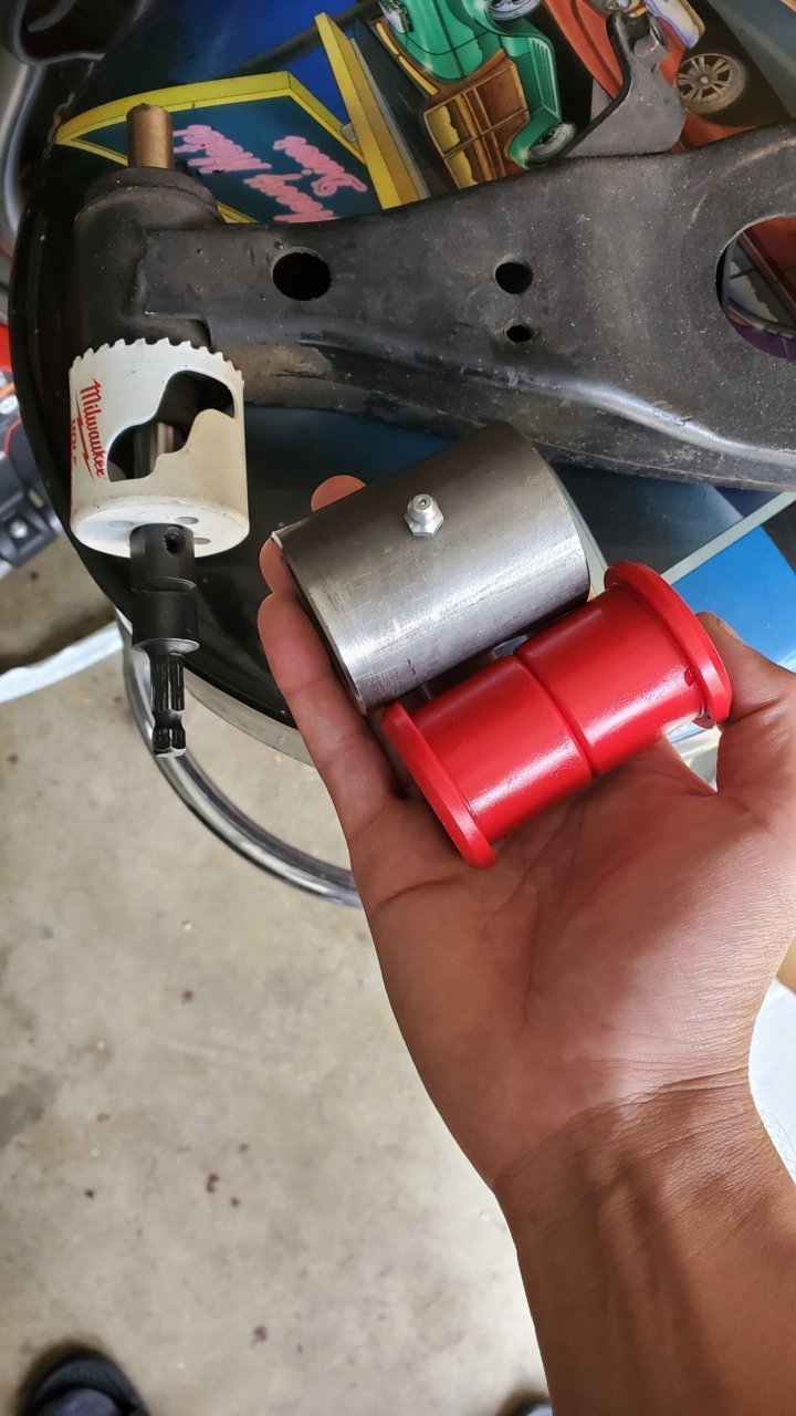

    I dont really see it being all that difficult. I'm not trying to take the bushings out of the sleeves. I'm cutting the whole stock sleeve out and replacing them with these.
    Just need to build a jig for the arms before I cut the stock sleeves out.

    That's not difficult.
    Getting all the stock rubber bushings out of the stock sleeve is a PITA..

    Yup i did that once. Thats why I'm doing this now lol. Being able to weld helps with problems like this lol.
    geekhouse23[QUOTED] likes this.

    I just used the stock jack and it pressed everything out with ease

    Can’t remember if the sleeve came out with it but if it didn’t I just used a chisel and knocked it out

    Pressing my stock bushes out wasn’t bad. The truck has lived it’s whole life in El Paso though so. Even my cam bolts slid out by hand.
    That said, pressing the Whiteline bushes in was the worst thing ever, I’d never do that again. I would rather cut them off and weld on the DOM/Poly replacements.
    Especially with those zerk fittings :drool:
    Are the DOM/Poly bits you have a kit or something you put together?

    These are the ones I used for my 5 lug arms. Might need something different for other applications.
    https://www.ballisticfabrication.co...y-bushing-with-dom-sleeve?variant=25323808007

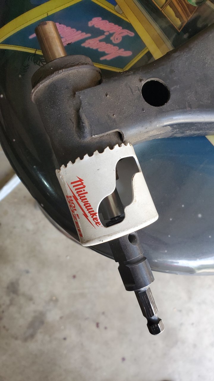

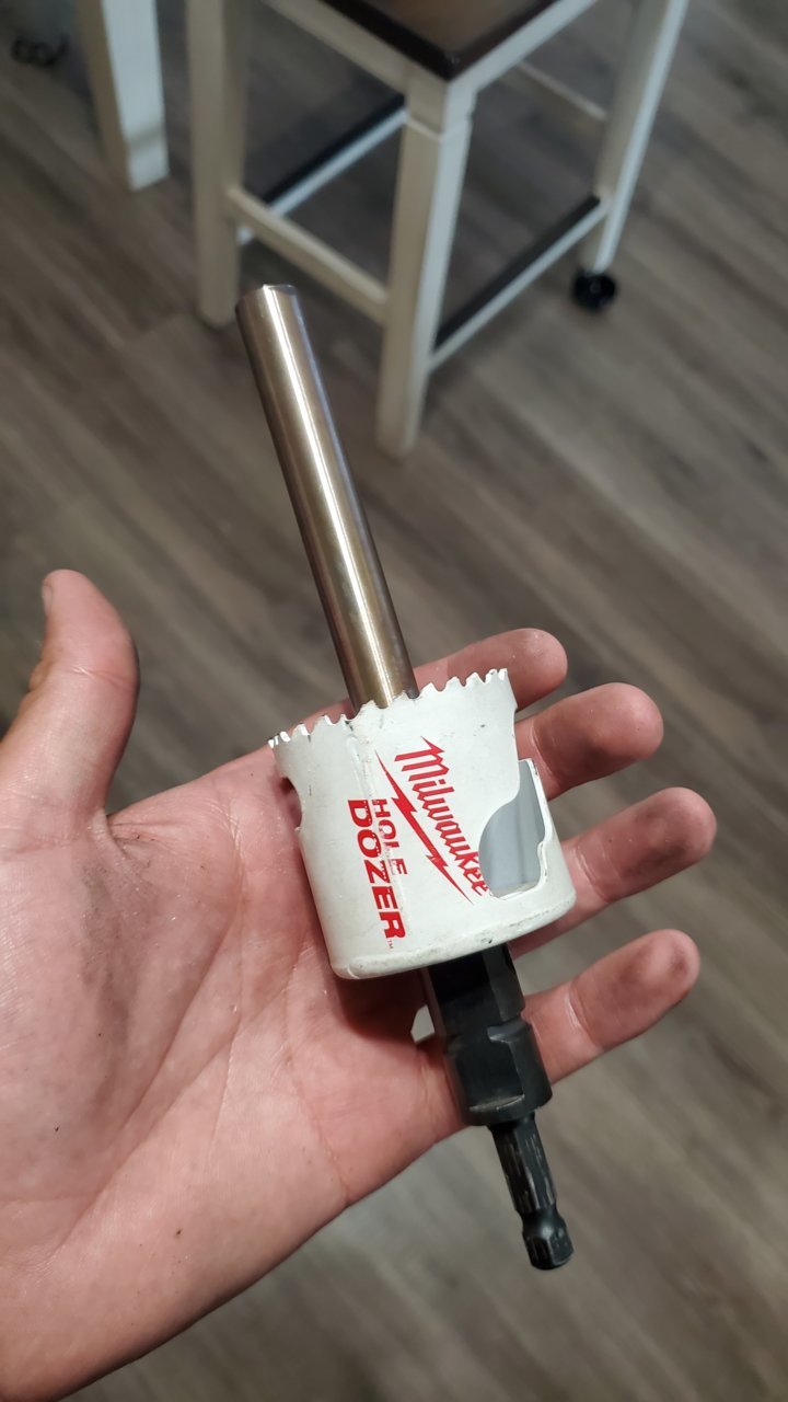

    That's a great hole saw. I cope'd a ass of 1.625CM for cages with those. MAC also had a good one.
    Nice mod on the tool
    Zim
