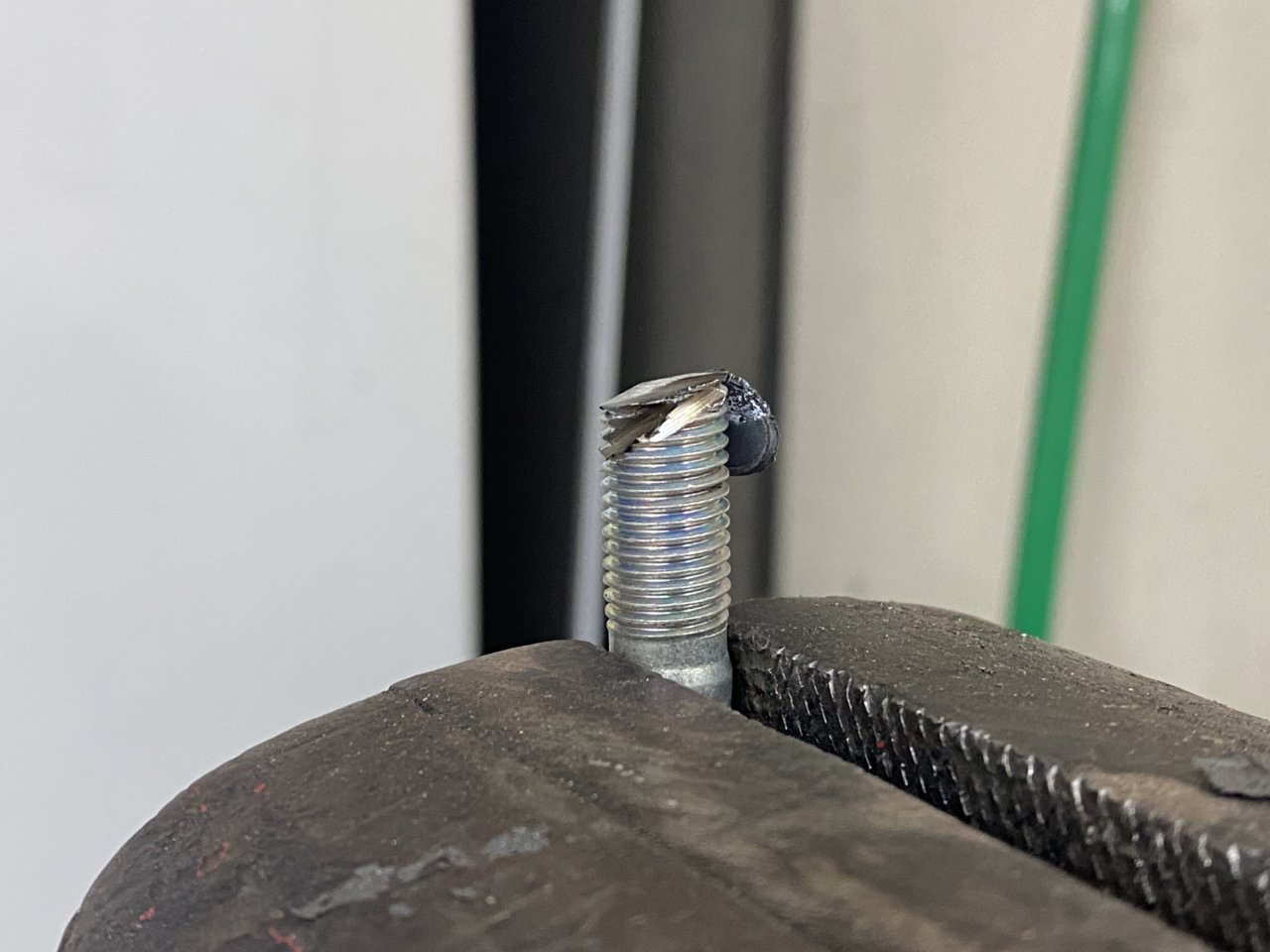

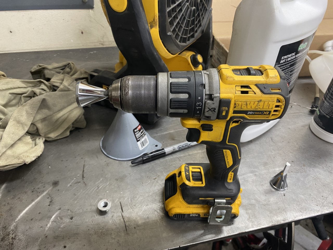

    So I hate shortening bolts because it’s never quite as easy to thread a nut on. I
    Even if you thread the nut in first, make the cut, and back the bolt off to clean up the threads, it’s still not great. I got this deburring tool to give it a shot.
    I did a worst case scenario test run and it worked like a charm. Under normal conditions where ray Charles isn’t doing the cutting it won’t turn the bolt into as much if a cone.
    The nut threaded on by hand with ease.

    No offense but that looks horrible. Screw nut on the bolt, Cut to length with hacksaw, clean up the threads with a file a bit then take the nut off the bolt. Or use a tap and die set, put the nut on first though. If its something you wont see ever again i guess thats fine but im super OCD lol

    He did a worse case with it. If u cut a bolt square and then use this tool it does a decent job if u don’t yeet the shit out of the drill

    What he said, which is what I wrote if you’d have read the whole post. I agree it looks like shit, I just wanted to see if it would work.

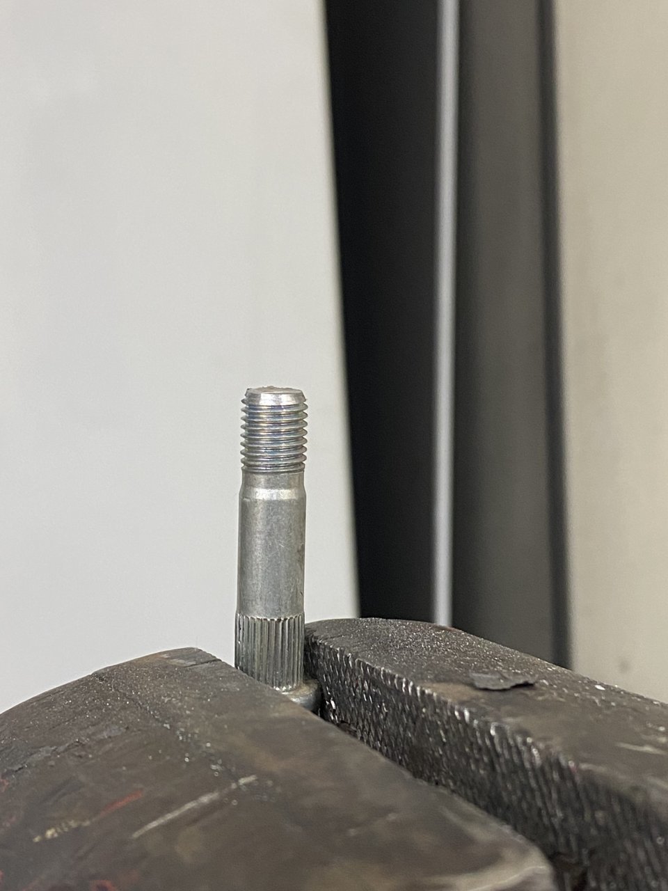

    Here’s what it would look like under normal usage. Square cut and cleaned up with the tool.

    That’s a lot easier than what I’ve done in the past which is making a cut then getting a small detail file and cleaning up the first part of the thread.

    I was never that patient so I just avoided trimming bolts at all costs. This tool definitely seems like it’ll come in handy.

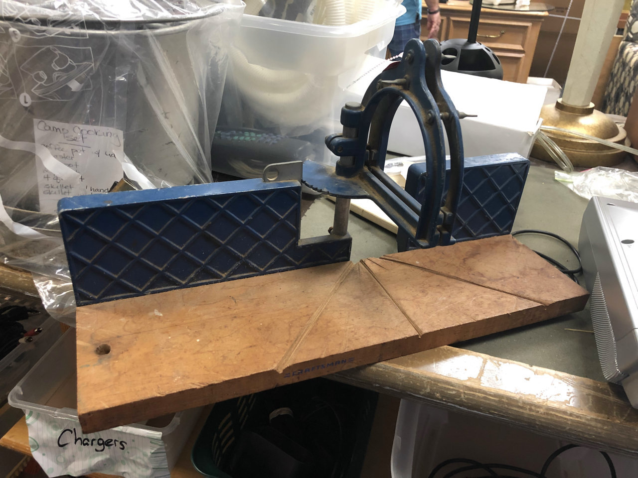

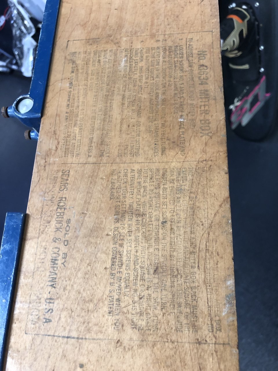

    Picked this up at a local thrift store for $14. Its in very good shape. No crack, rust, splits in the wood or anything. I need to clean it up and see if i can fine the correct saw for this but think anything newer would work?
