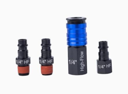

  13. Dec 7, 2021 at 2:49 PM
    #4933
    outdoorgb
    outdoorgb (.)(.)
    Jul 30, 2014
    #135065
    872
    Burbs of Oregon
    2014 DCSB TRD Sport Silver Sky...
    @la0d0g
    I bought these sets at Lowes last December and have been great. I outfitted my garage and woodshop with these. Have a few spare sets. They were selling for $4.99 (not the $14.99 listed) and the price was not shown on the shelf. I did a price check and got the sets (10x) for $5
    Easy snap fit on off
    https://www.lowes.com/pd/Kobalt-Hig...Jg8NA4O0VXwsrzG4-ccaAgMHEALw_wcB&gclsrc=aw.ds
    la0d0g[QUOTED] and 907rx7 like this.
