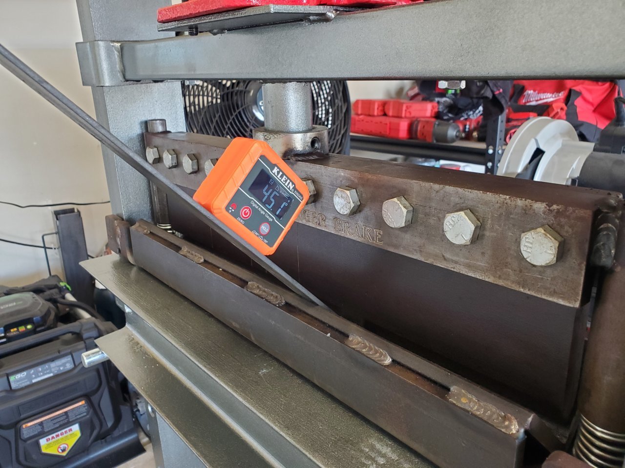

    As for the SWAG kit, yeah they've had a kit out for years. Two variants, a finger brake press with removable fingers for bending all sorts of stuff or a full-width version.
    I don't plan to do anything thicker than 1/4" which will be for some skid plates for the Land Cruiser. Everything else will be 3/16" or thinner and the kit will do that at its full width.

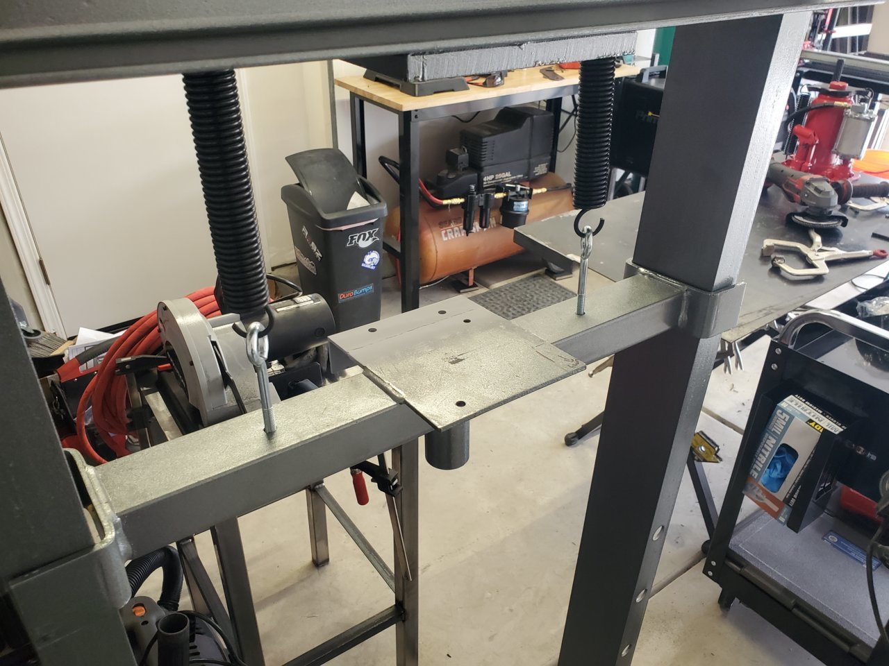

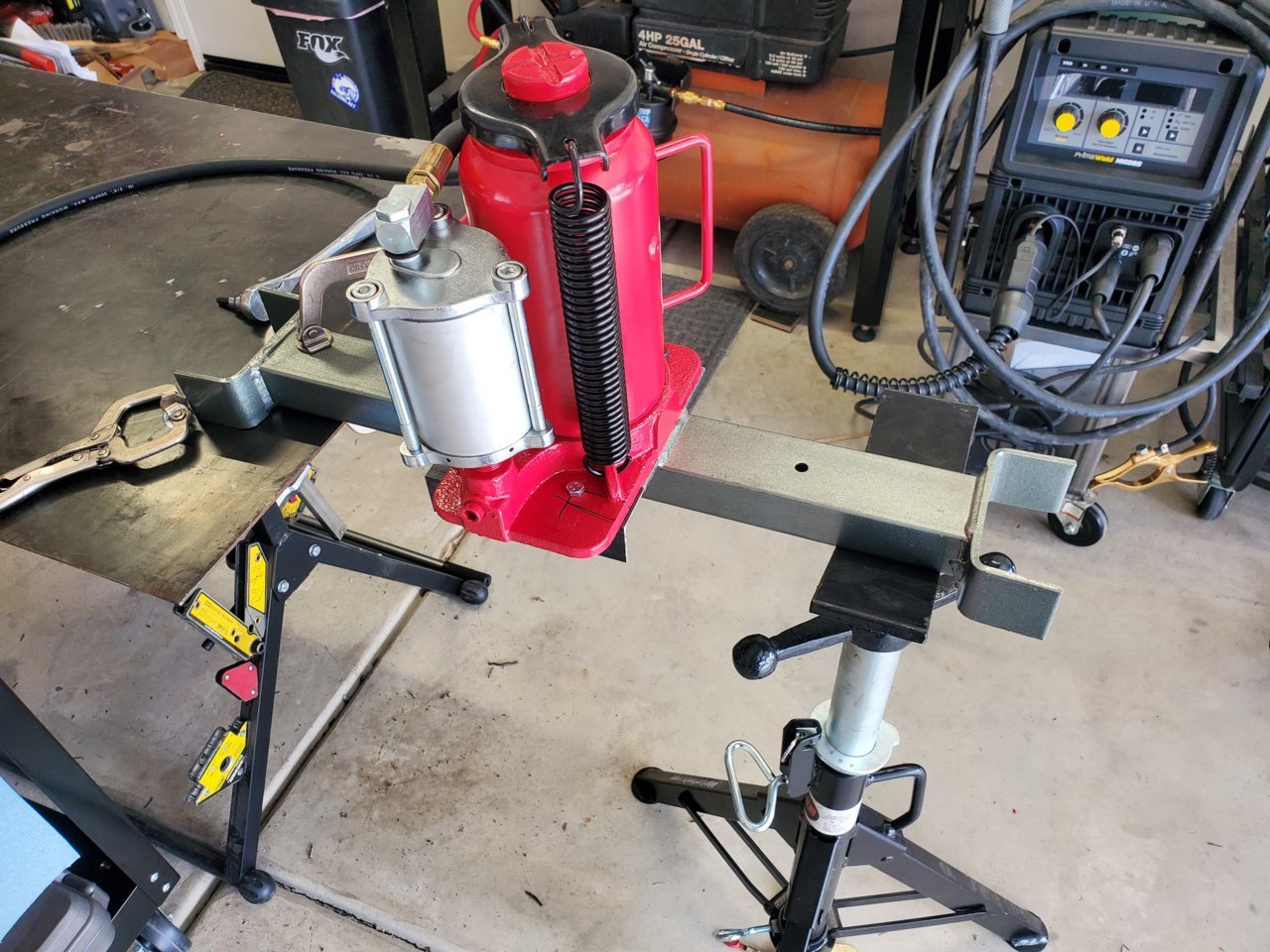

    Got the air over hydraulic jack. I could've opted for the old grey variant as they're on clearance but for only a $10 more I got their newest version.
    Being the tool section, it's only appropriate that I add that I found the 1/4" Icon wrench so I picked it up to add to the 3/8" I've got.
    Anyway, whether you go with the discontinued grey model or the new red one, you'll notice that neither have any mounting holes.
    A small population prefers to allow tension to hold their air jack in place. A few others actually weld the jack's base plate directly to the jack plate. I didn't want to create a new jack plate in the event that my jack failed in the future so I opted to bolt it on.
    Easiest way is deal with the rear overhang and use that as a mounting point. I also opted to use the preexisting hold up front both for centering purposes and aesthetics.
    OSHA approved.
    Measure once and drill three times.
    Mock up and drill your base holes, then get ready to weld.
    Reassemble after primer and/or paint, you don't want raw surfaces getting rust.
    All done.
    Tomorrow my foot switch arrives.
    I opted to remove the hand switch that comes with the jack and run a foot pedal to the floor so I can keep my hands free to hold and manipulate whatever parts I'm pressing.

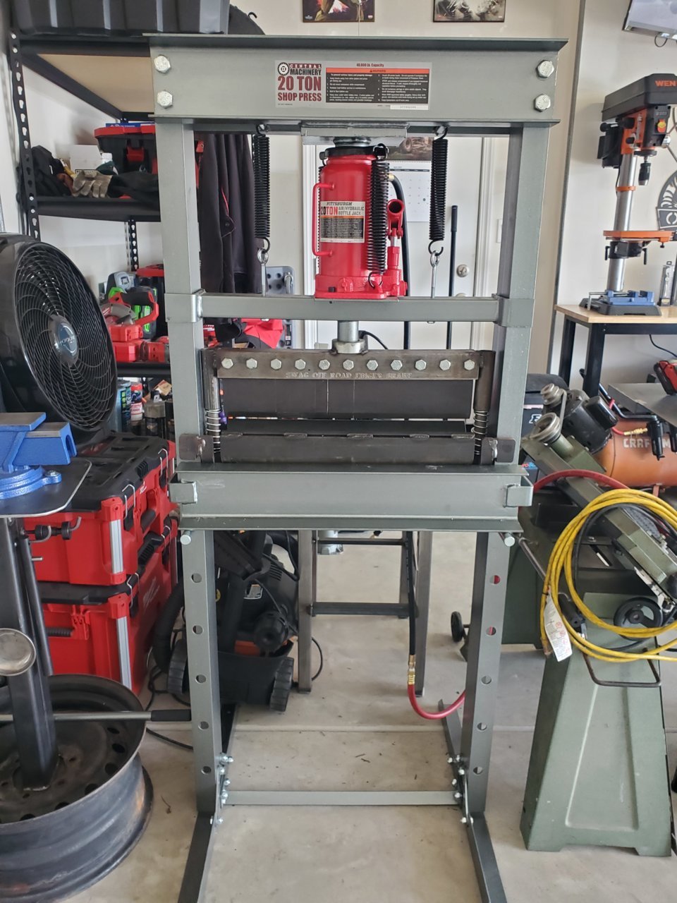

    It's here :burp:

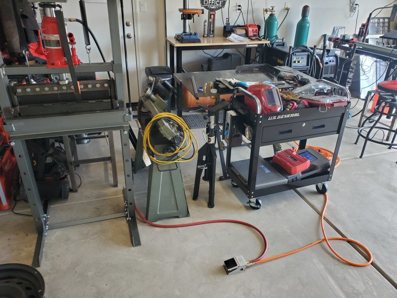

    Amazon delivered my foot pedal so I finally did my test run
    @soundman98
