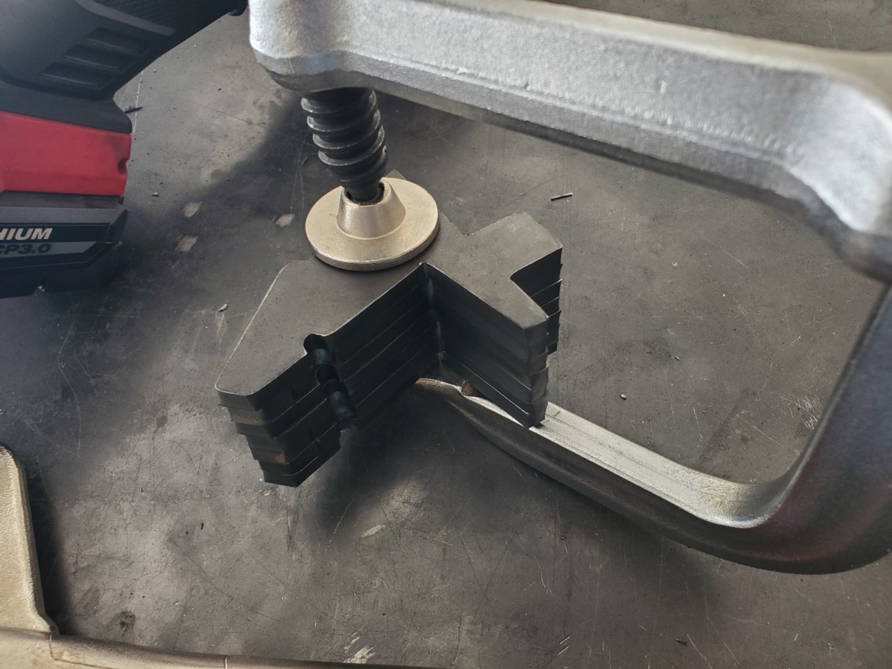

    Interesting you didn't just use a gooseneck die or something, but yeah I heard the stories about the old presses...damn
    Speaking of, maybe I should make myself some more and actually use them :anonymous:

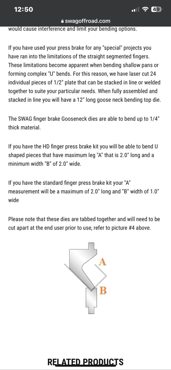

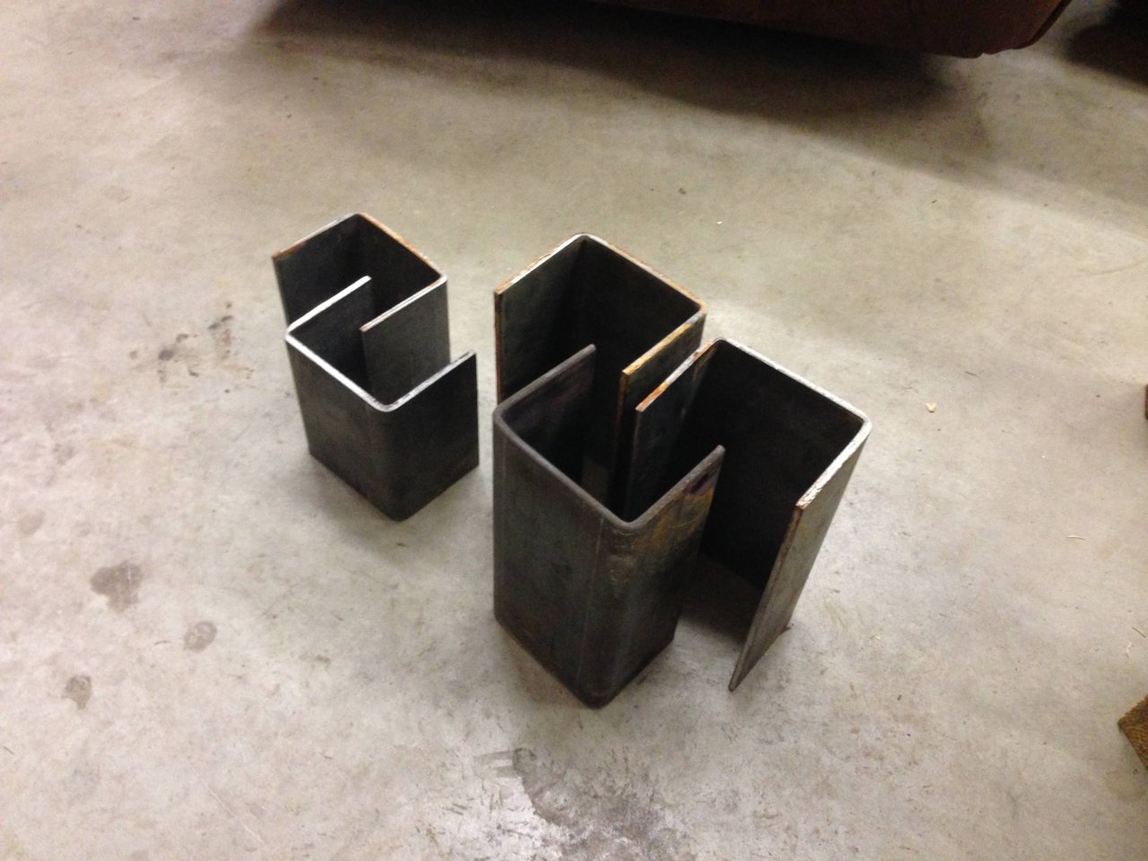

    I don’t remember the exact dimensions of the channel I made but I recall it being too big for the gooseneck dies. And I haven’t really ran into any issue of needing it since. But one day when I’m out of buying other higher priority things maybe I’ll pick them up, so you printed your own? Is there a public file for them, I’d just as soon burn them out on the Langmuir then pay $200 I’m cheap :oops:

    Gotcha, yeah that's the main reason for not forking out another $200 with them as their gooseneck dies are very specific and don't offer much clearance.
    I'll have to talk to an engineer in another group to see how much larger the die can be without having to step down in tonnage by a lot, I mean I'd only want to bend 3/16" or thinner for the size bends you posted.
    With the belt sander, it'd be a lot faster getting things cleaned up and squared which is why I'm going back to making some soon. Just want to tighten up that radius.
    Looks like I'll just grab some angle tomorrow.

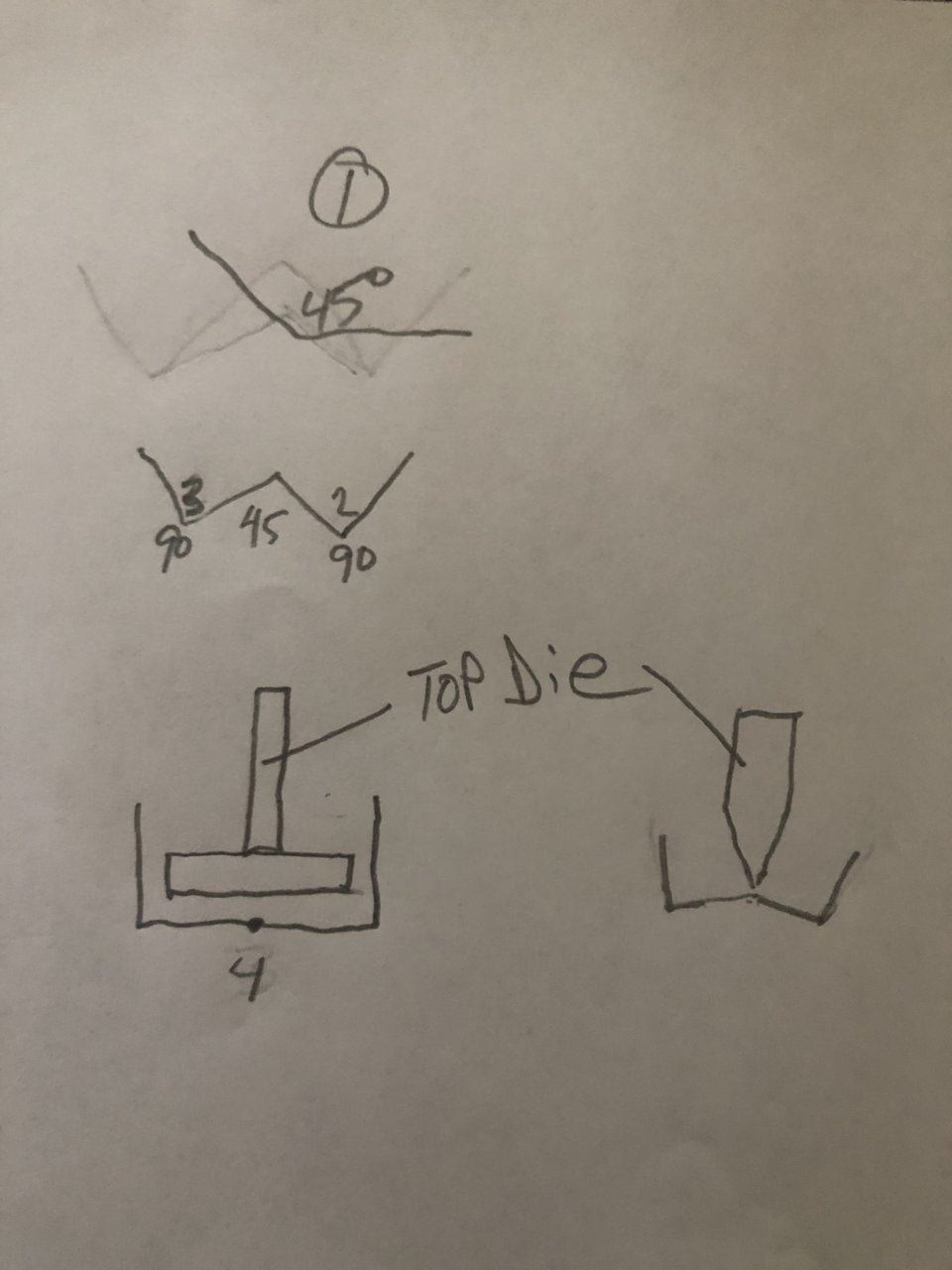

    I’ll give my 2 pennies fwiw. Not sure of your bottom die setup. I’m used to working with materials 24-10ga. If you don’t have an offset die you can make a flattening die or use the top V-die. Brake center line 1st @45. Flip over 180 and brake the channel legs 90. Use flattening or V-die to complete. Pencil-cad drawing included.

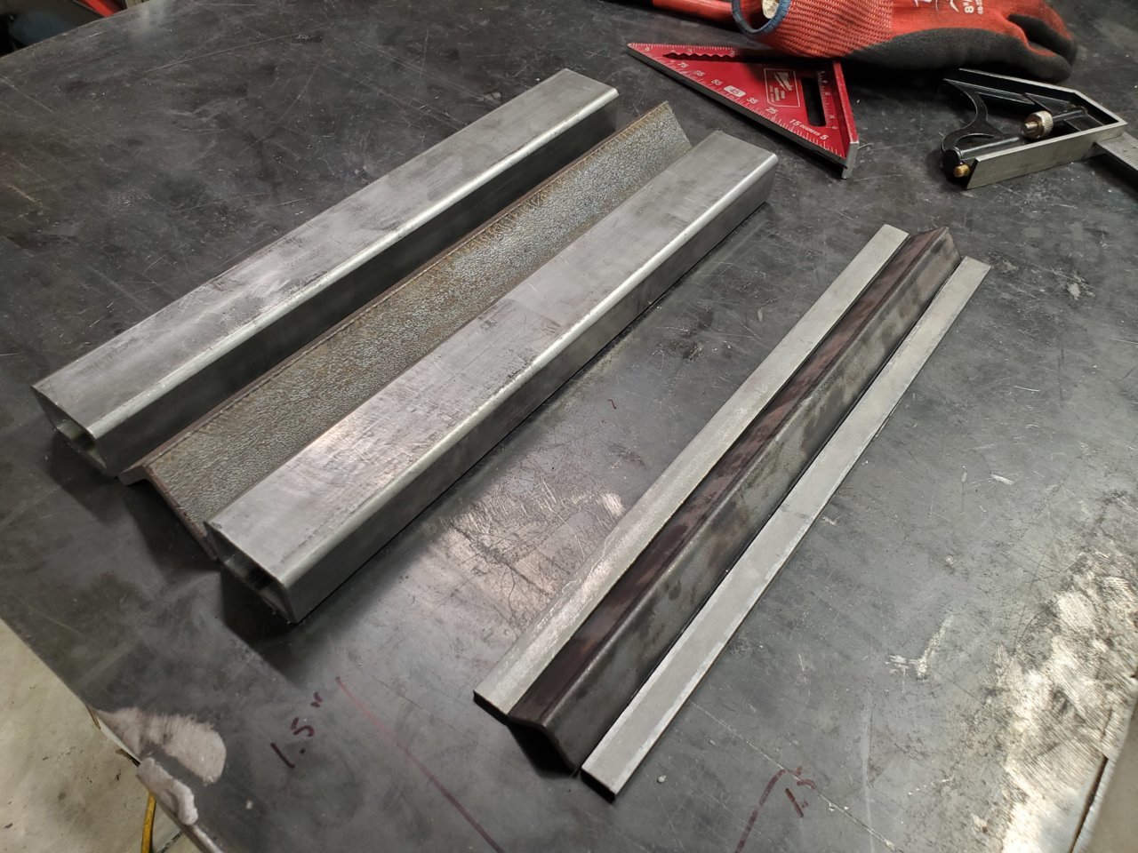

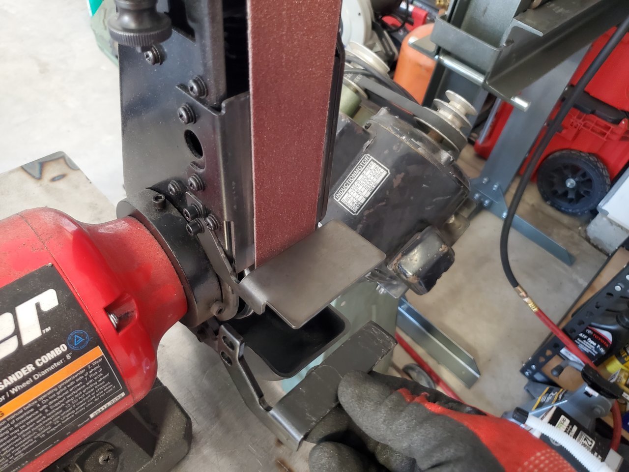

    The little "stand" on the belt sander was a tad short so I made my own

    thanks, that’s a good idea too, hadn’t thought if that method. Don’t think the bend and bend back would weaken the metal?
    I just have the HF finger press brake, no flat die, but I guess could make it work with v die if I lined it up carefully.

    If you’re talking mild steel then no. You may not have to brake the first bend 45. Maybe 30 degrees depending on the length of the channel sides. A flattening die works best. Be careful with the v-die to keep it centered on the brake edge. It may slip to one side or the other as pressure increases. Stop and re-center then continue. Go slow. Continue until bottom is square with the sides. The bottom of your channel will have a bit of a ridge which will act as a stiffener. If you try to push the ridge totally flat you’ll roll it and have to manually hammer it flat.
    You can build a flattening die. Get steel plate the thickness of the v-die and skip weld.

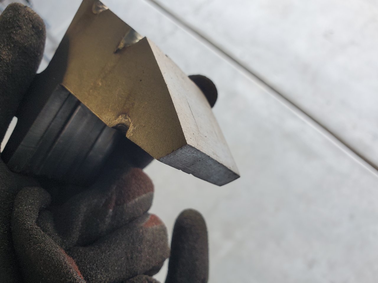

    I didn't want to stack angle as suggested and the flat bottom die won't even work on the 10 gauge I had planned to use it with
    I'll weld the other one tomorrow but that'll be for when I'm bending thin gauge and need a tight radius

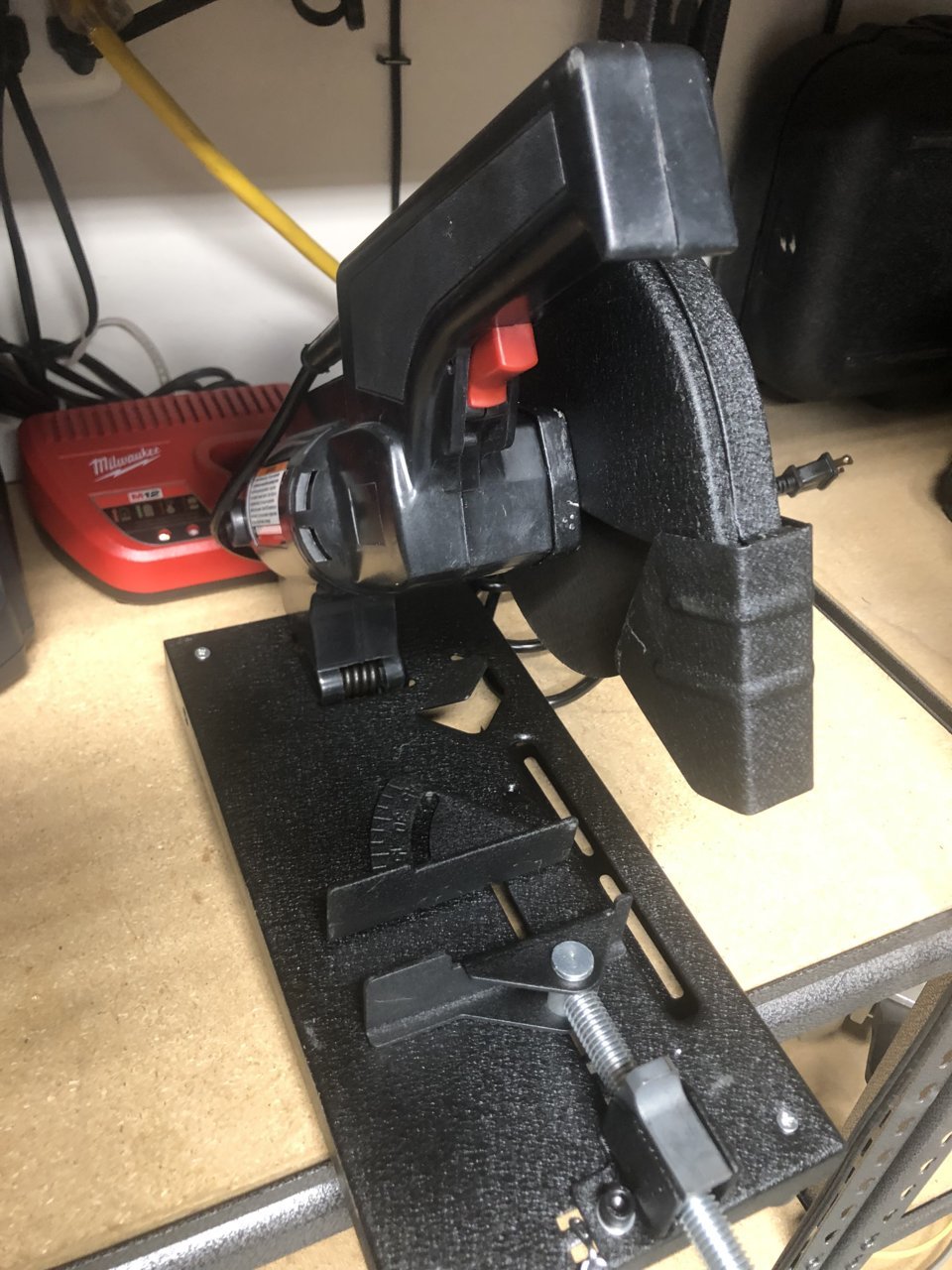

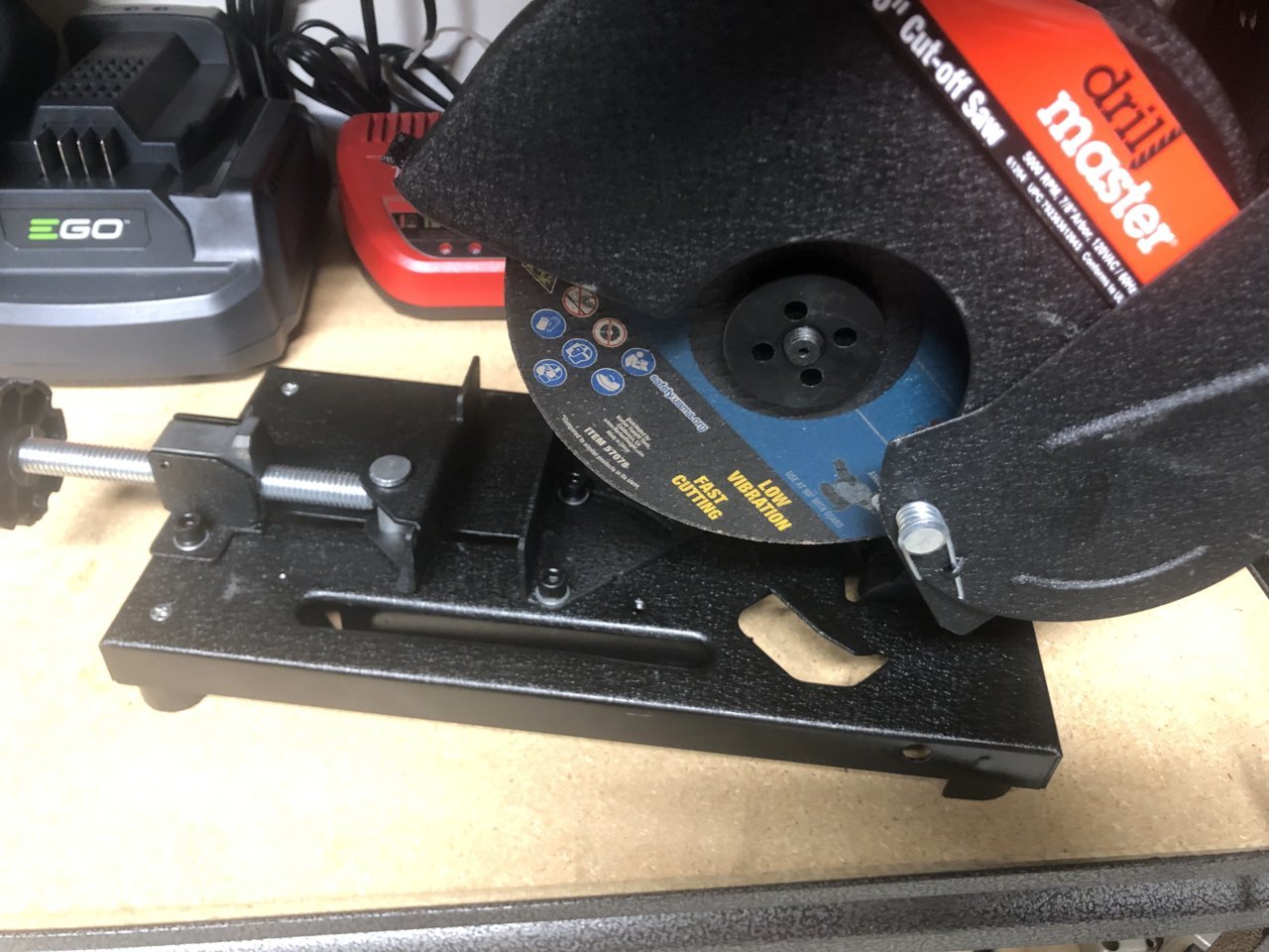

    Trip to Harbor Freight and found their 6” cutoff saw. $40 regular price and a 25% off coupon. Looks okay for what I need. If I had many cuts or larger material I’d go for a full size saw.

    This thing is tiny. Footprint is 6"x12". Won't take up any storage space though.
