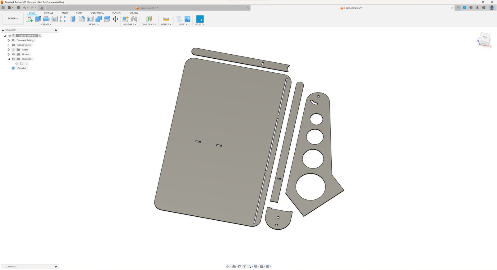

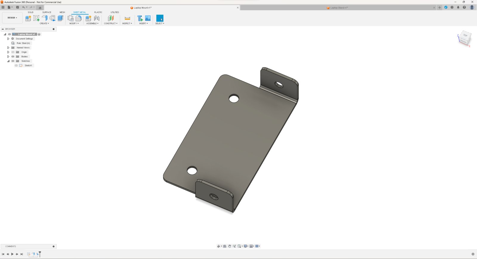

    Speaking of, need to make this now
    Can't have my laptop sitting on my bench near my drill press

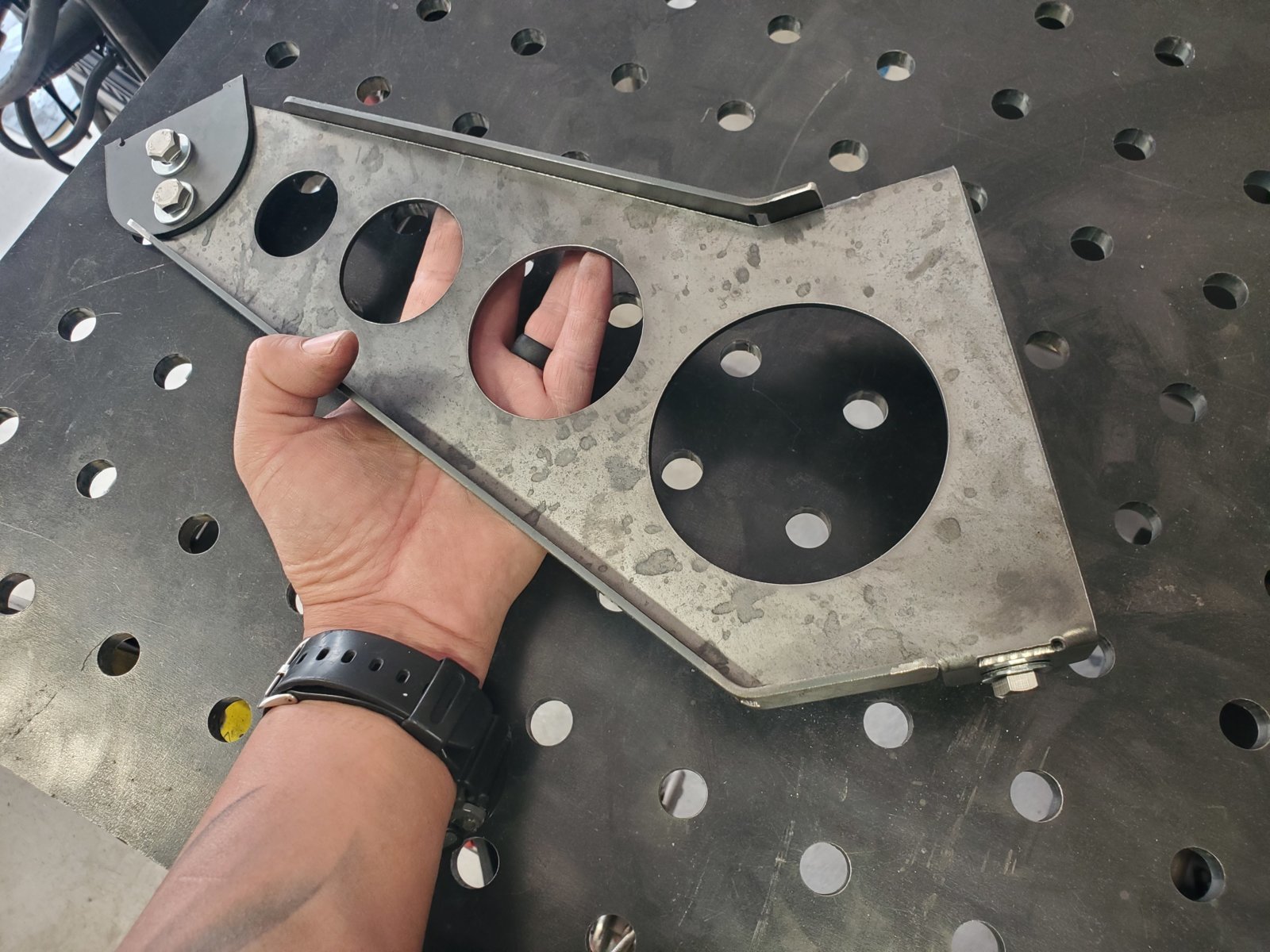

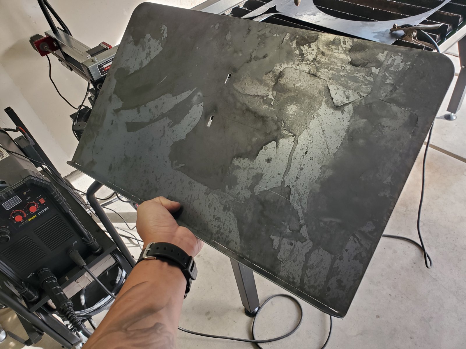

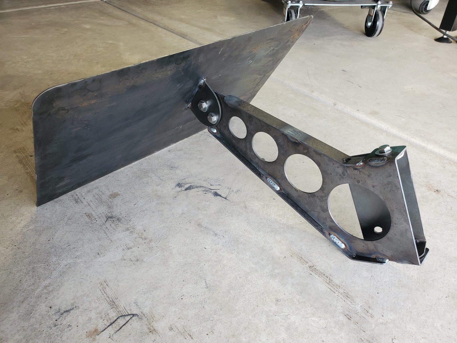

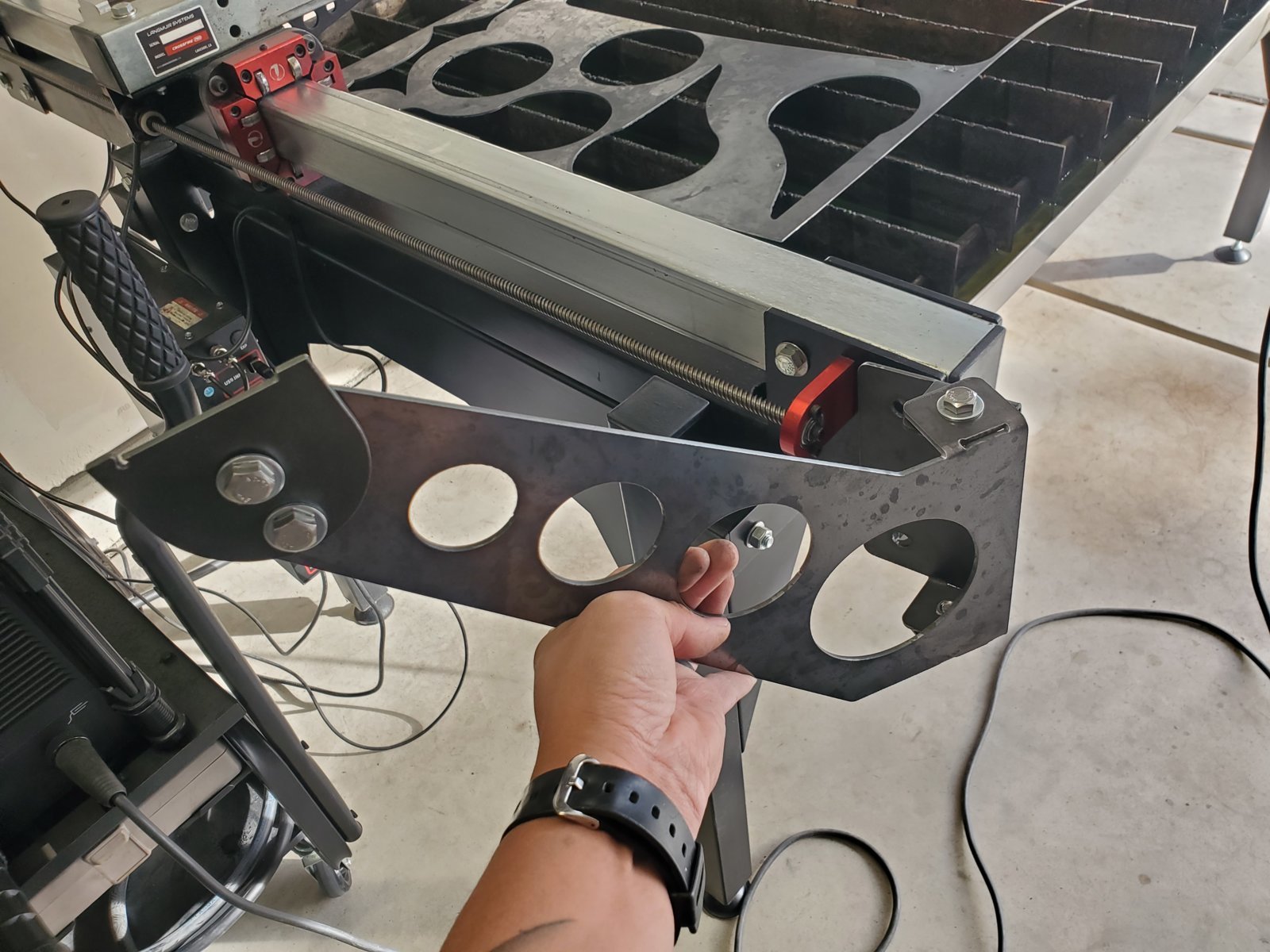

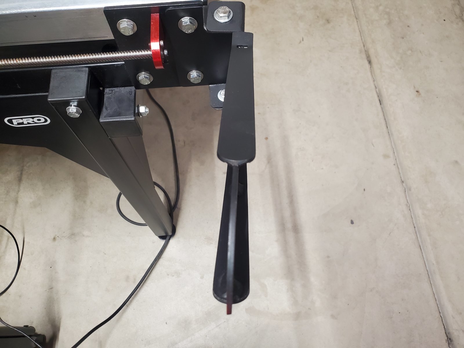

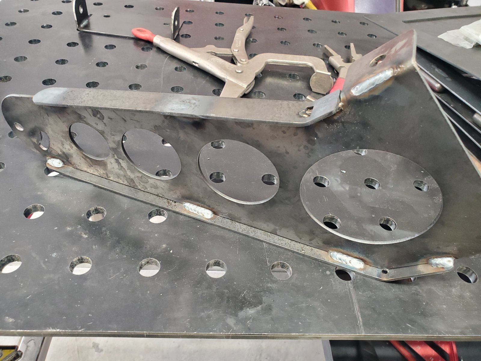

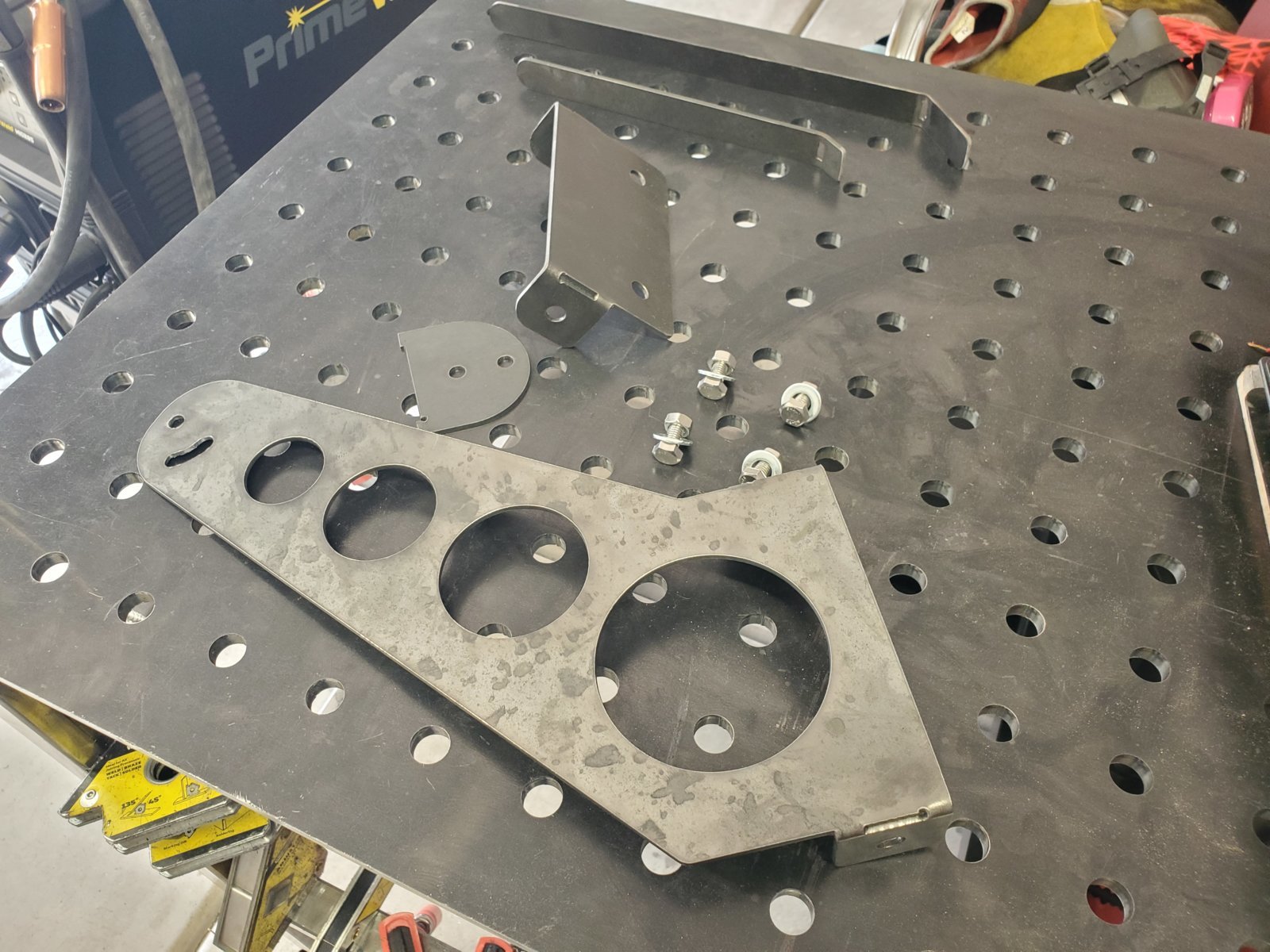

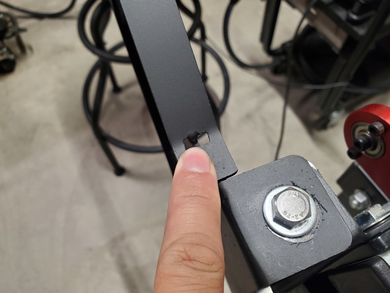

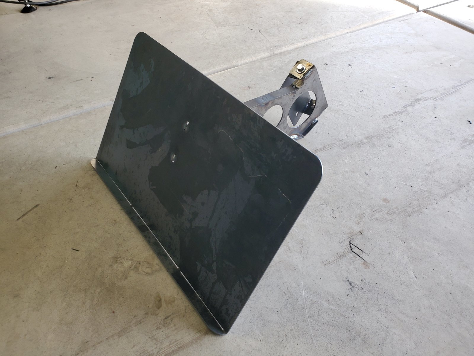

    Had to redraw the arm; my ADHD got the best of me and I went to cut it out forgetting to add the tabs :rofl:
    To start -
    Mostly everything cut; the top portion itself I used 16 gauge whereas everything else is 12 gauge -
    Here's how it'll go together -
    And where it'll mount -
    The top -
    What's nice is I'll have the ability not only to swivel it in or out, but also angle the top a bit.
    Welding her up -
    All done -
    Tomorrow I'll knock off some of the welds and throw a coat of paint and it'll be done.

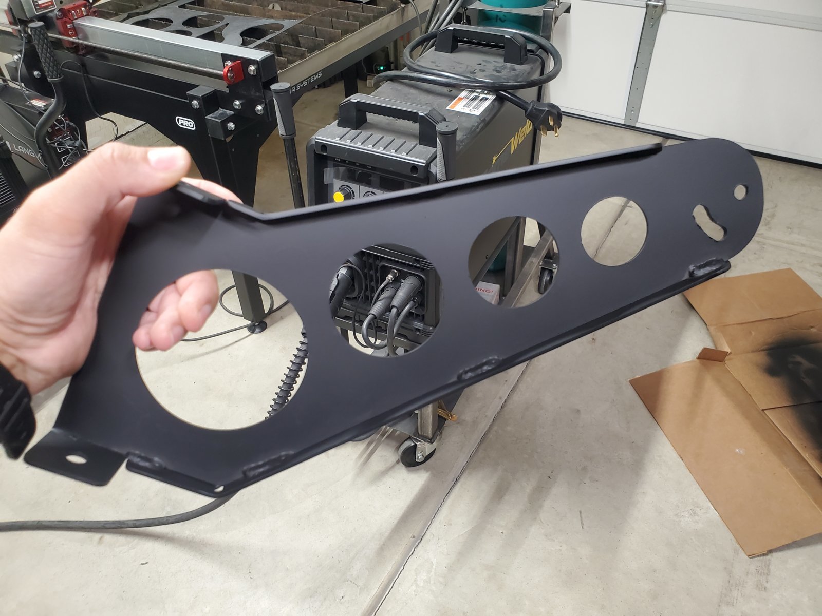

    Getting them painted so should be ready in a few days -

    Naw this is 12 gauge, easy to bend against a flat surface.
    I bent it by hand as I added a little notch both for a bend relief and a means of tack welding it on top for centering reasons.

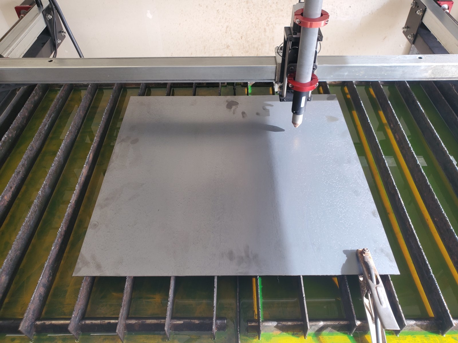

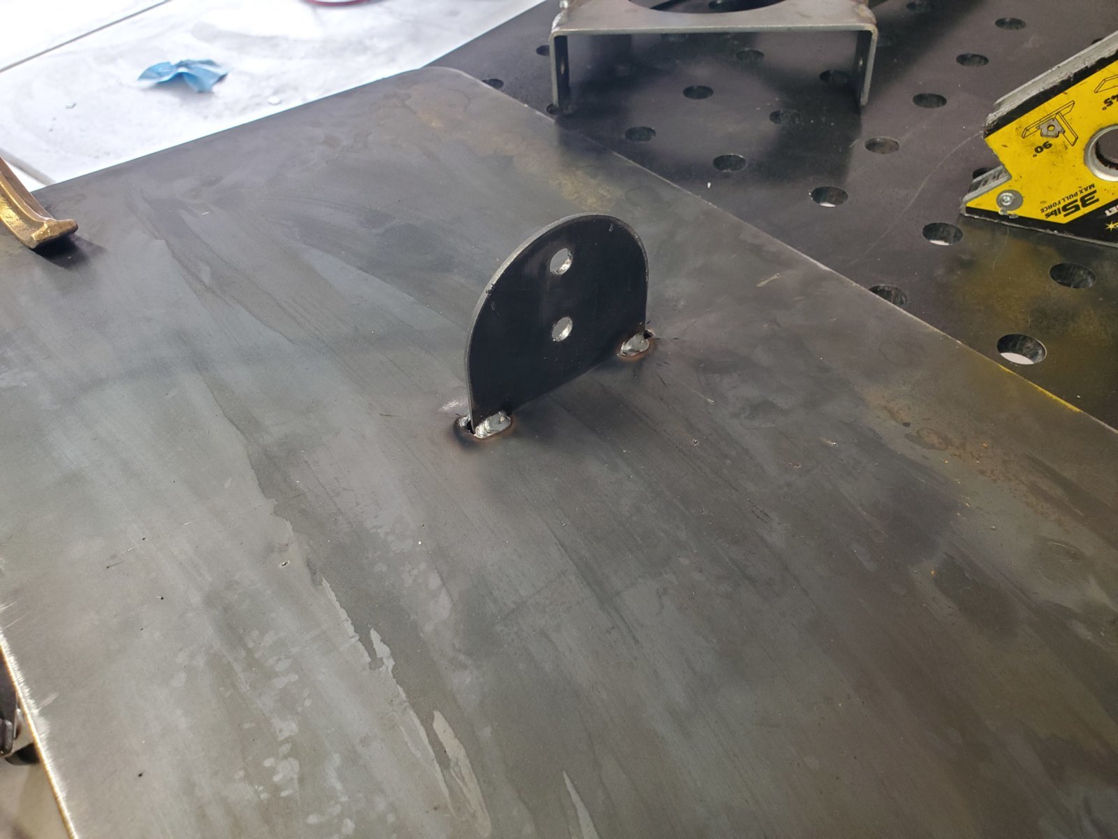

    The notch and tack weld -
    Did the same for the bottom -
    I don't like how the top came out so it'll remain unfinished until my fluid comes in and I'll cut out another.

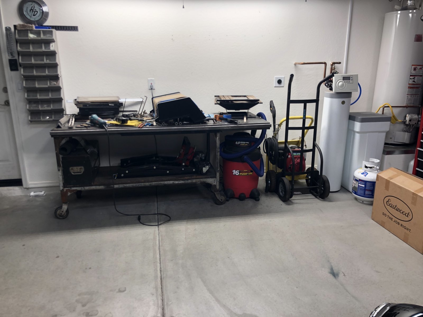

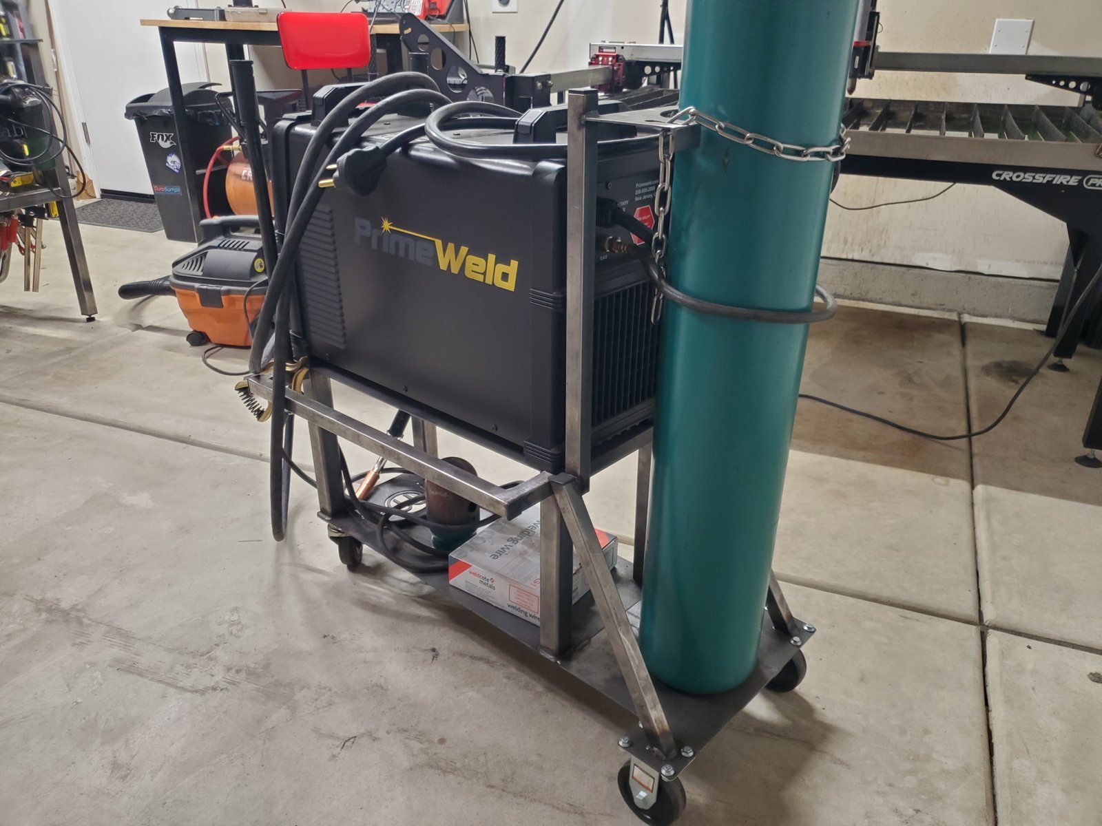

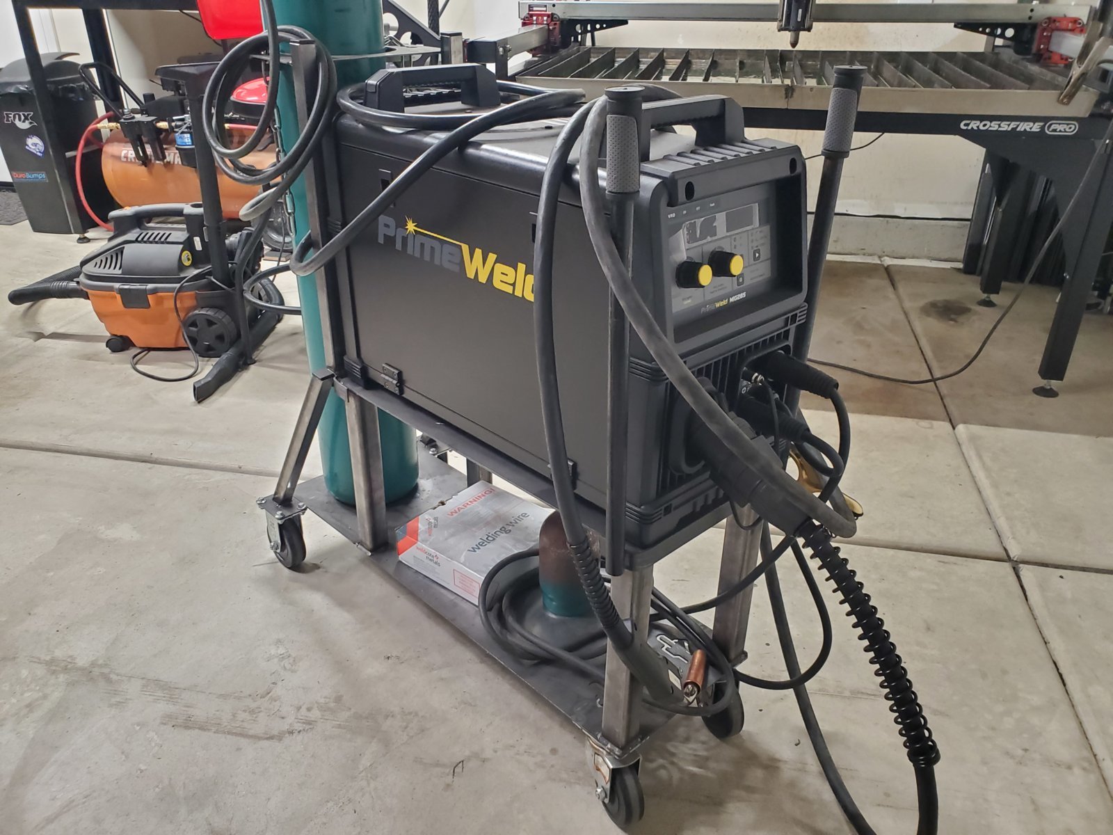

    On the subject of sheet metal, and the earlier mention of a welding cart, here's my cart made of sheet metal
    60lb welder, 80lb bottle, 11lb spool underneath, 11lb spool in the machine, and a few for the torch and ground clamp
    That's excluding the square tube itself and dom
    Build it right (with scrap even) and it'll be sturdy AF, and cheap too (under $25-27 all in)
