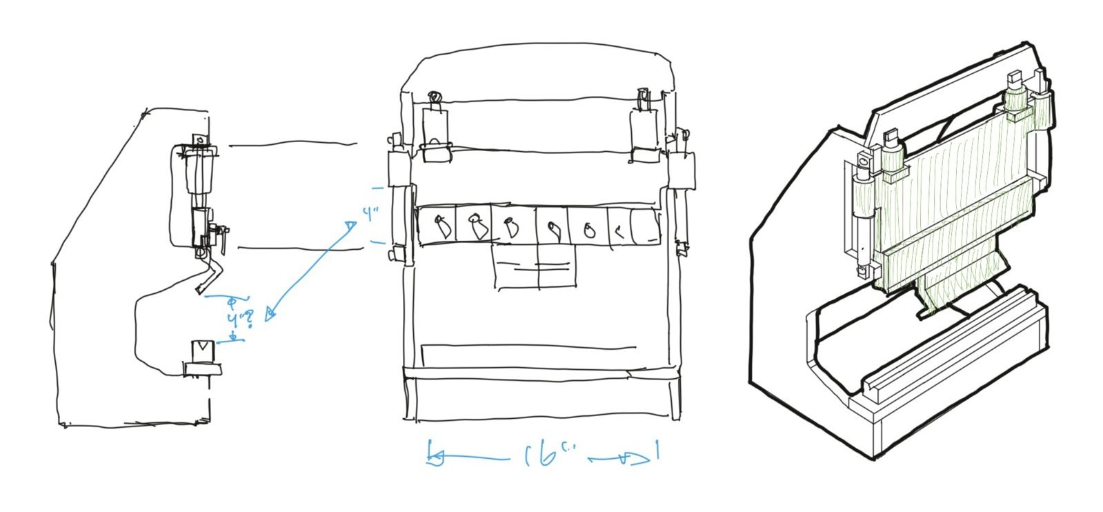

  9. Nov 18, 2023 at 4:00 PM
    #6049
    Zebinator
    Zebinator Well-Known Member
    Nov 30, 2014
    #143381
    931
    Norcal
    06 Tacoma TRD Offroad
    You want to collaborate on that press? I sketched something while on this damn plane:
    drew it 16” wide but I like wider! I like the idea of open sides so you can slide a part out the side… and twin pistons so you can press on the edge and not rack. Not sure if any of thi would work. I get “ creative” on planes. Must be the low oxygen.

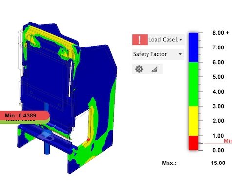

  11. Nov 23, 2023 at 1:56 PM
    #6051
    Zebinator
    Nov 30, 2014
    #143381
    931
    Norcal
    I modeled a rough pass of my sketch in Fusion and tried messing around with Fusion's analysis module. Here's a 30 ton load between the punch/die. (basically, bending 1/4" steel) Pretty fun! I remember working as an engineer and awe of the FEA system you needed a PhD to run, and that cost >$100k...
    Needs a little work, probably! :)
    I found a couple hydraulic cylinders and if I can figure out how to control them in tandem I think this might work. Anyone here have any experience with hydraulic systems? I have zero...
