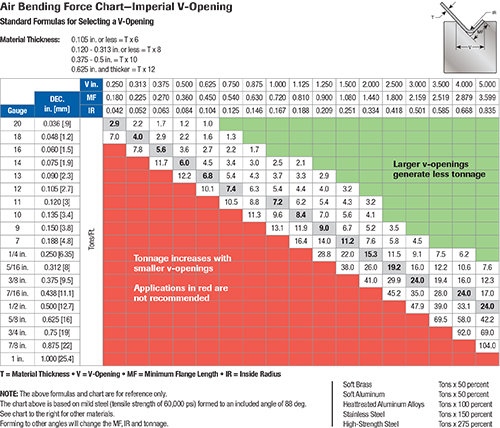

    Question; you seem to have something specific you want to bend, what is it?
    I ask because you can ask for a recommendation for what size tang, and how much room below the die, etc. based on what you're wanting to create. This way you create a "saddle" for use with multiple die sets.

    I want to bend up to 1/4” steel… down to 20 ga. A sheet metal guru told me I could do 95% of everything I could want with a gooseneck die. I don’t do any production. It’s all one offs and prototypes.

    Kwikvette
    Feb 27, 2019
    #284735
    82,879
    Fresno County
    4 run, 2 don't
  4. Nov 23, 2023 at 3:38 PM
    #6064
    Zebinator
    Zebinator Well-Known Member
    Nov 30, 2014
    #143381
    931
    Norcal
    06 Tacoma TRD Offroad
    The chart of wisdom and truth.
    soundman98 likes this.

    This way you can make it easier and invest in a single 4 way bottom die block for the openings you need, and a good gooseneck and you're golden
    Going 40T will do all you need too

    I also want to be able to bottom lighter gages and aluminum… I need to (re) find that chart.
    Kwikvette likes this.
