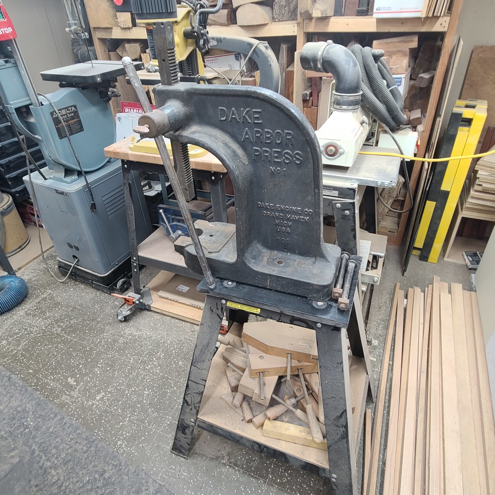

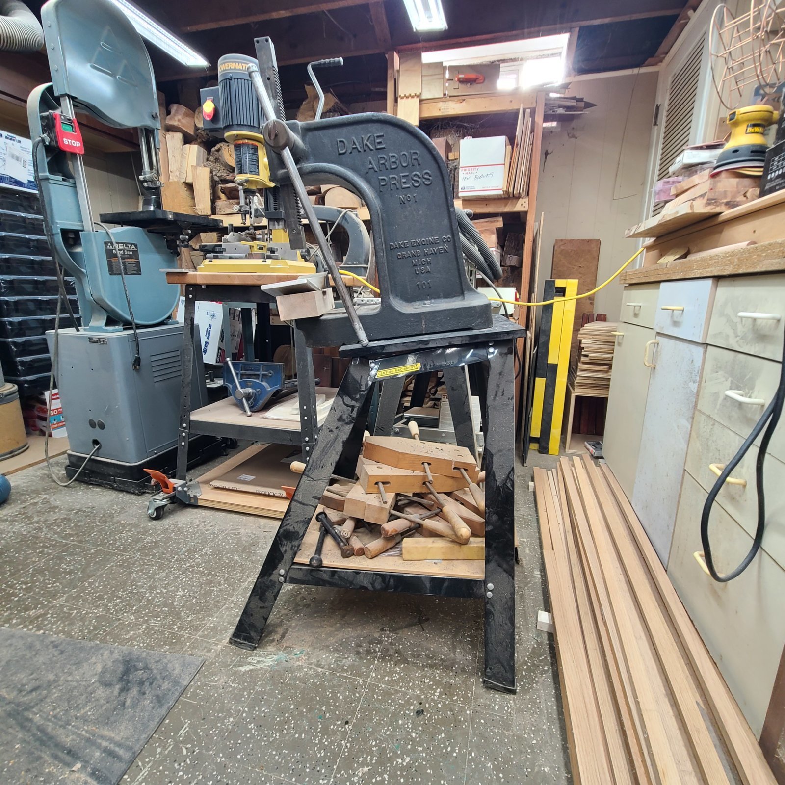

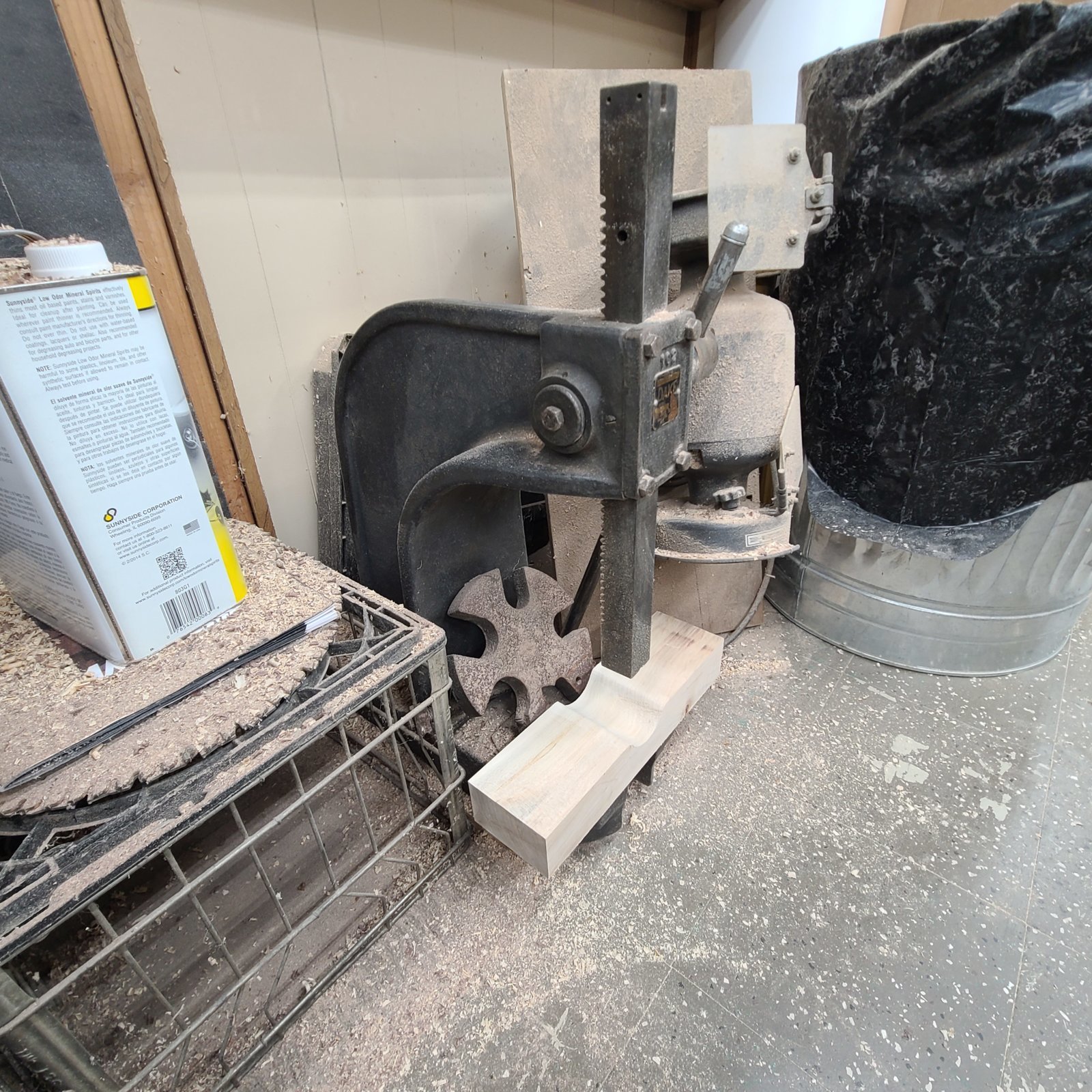

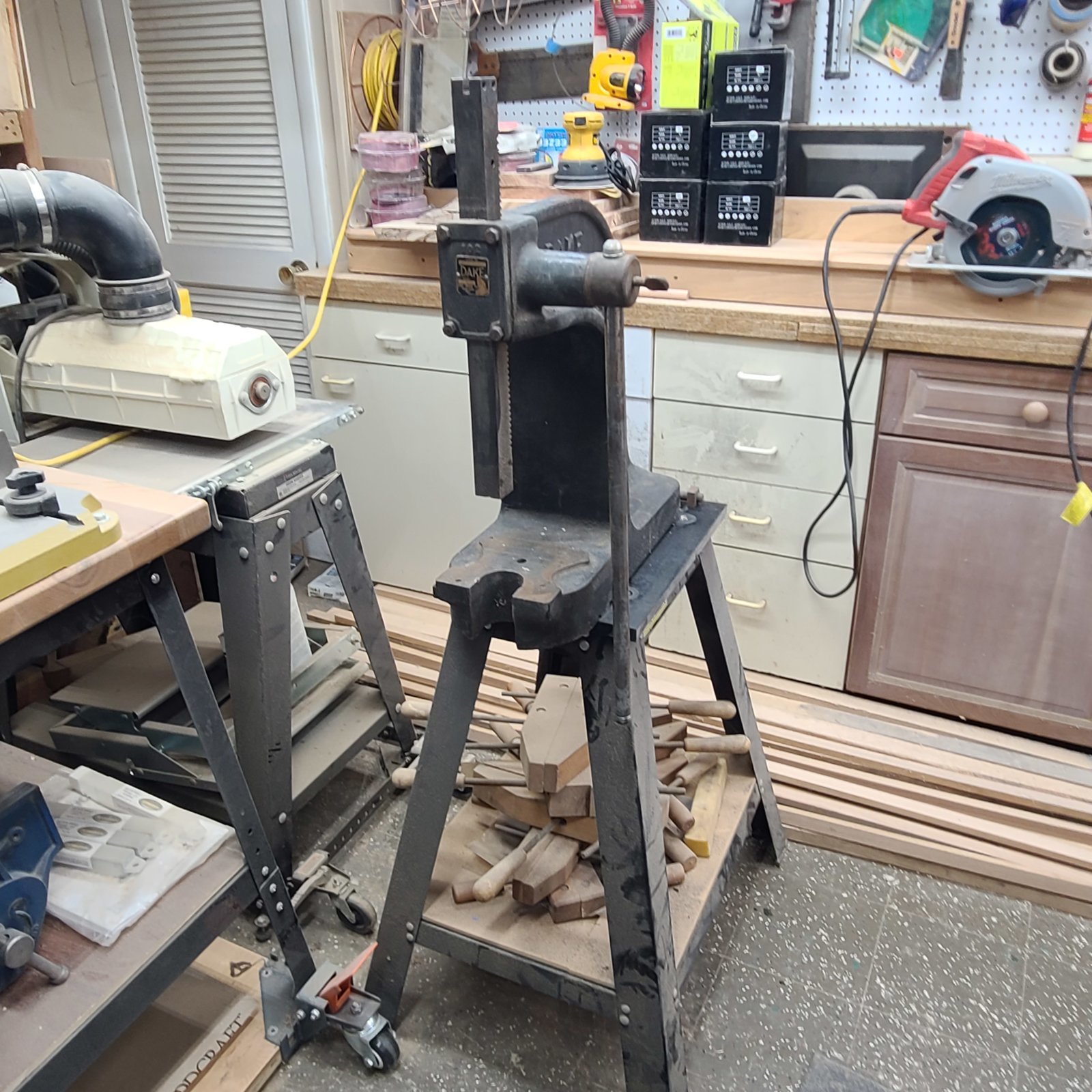

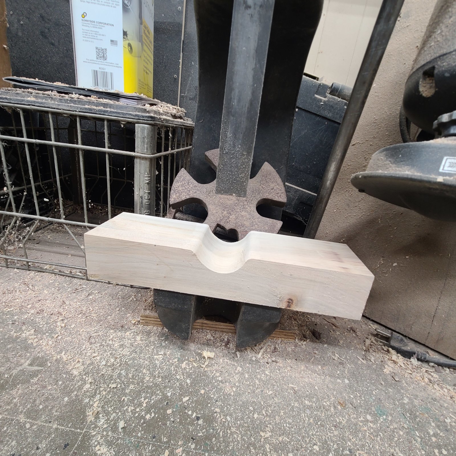

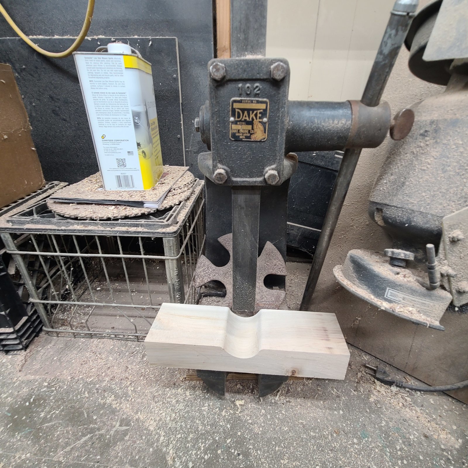

    So a simple project compared to what some of you guys do. With some success and some failure. I have a new planer for my wood shop coming and I'll pick it up from the trucking terminal with my taco. I need some ramps to get it off. I need to bend some 3/8" plate to make a hook for the ramps. So my idea is to use an arbor press to do that. I drilled a half hole in a block of maple scrap wood to make a bending form.

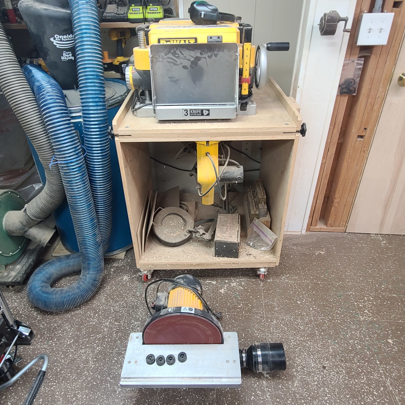

    I removed a disc sander from a tool stand. It will be going where the dewalt planer is now. The planer is being sold to a friend when my new one arrives.
    I mounted the arbor press to the stand.

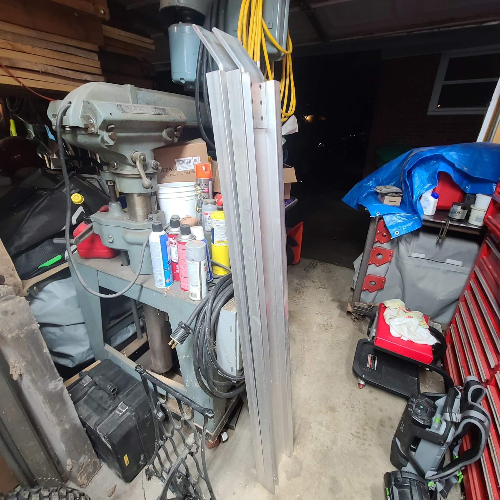

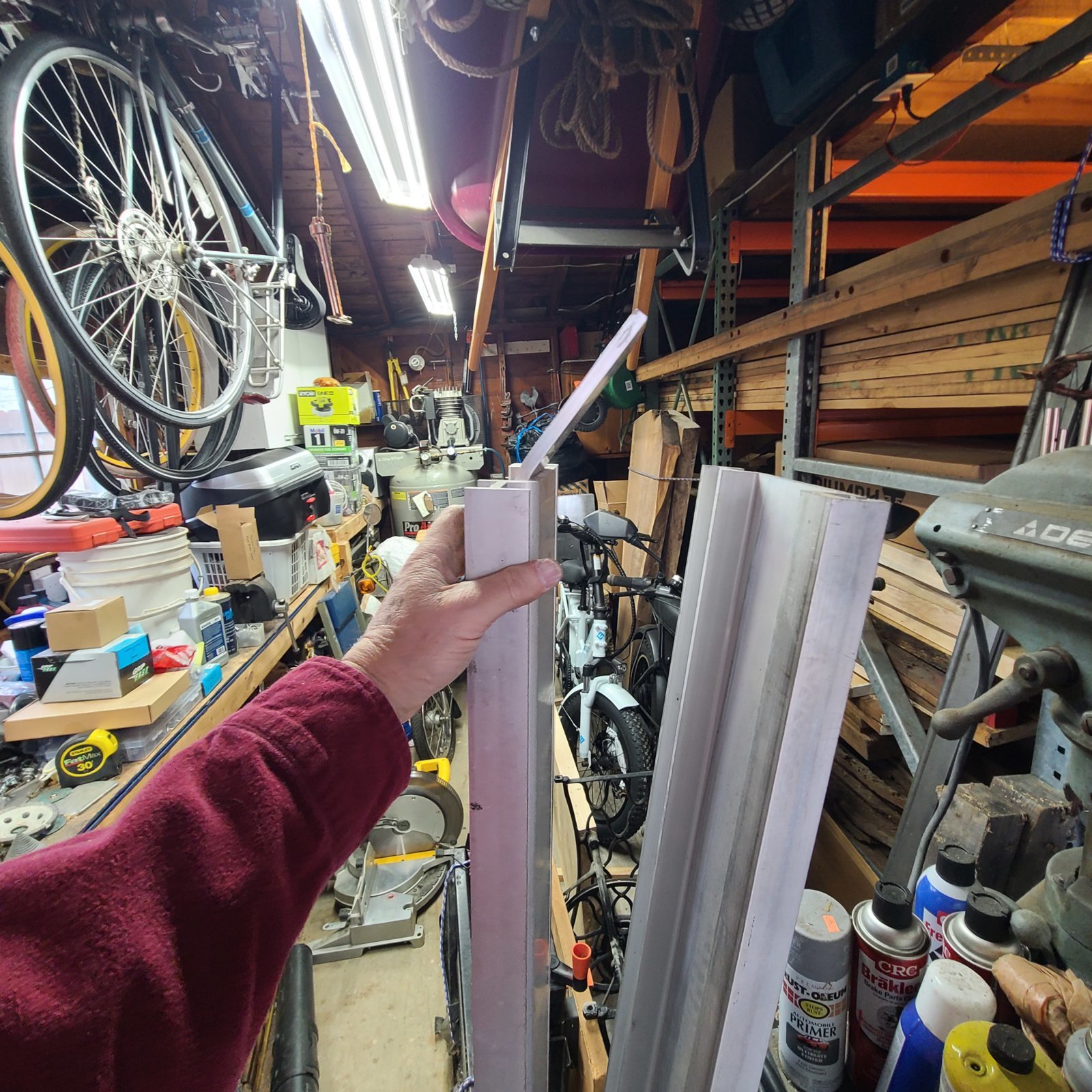

    I salvaged 2 of these heavy aluminum extrusions from a place I worked at.

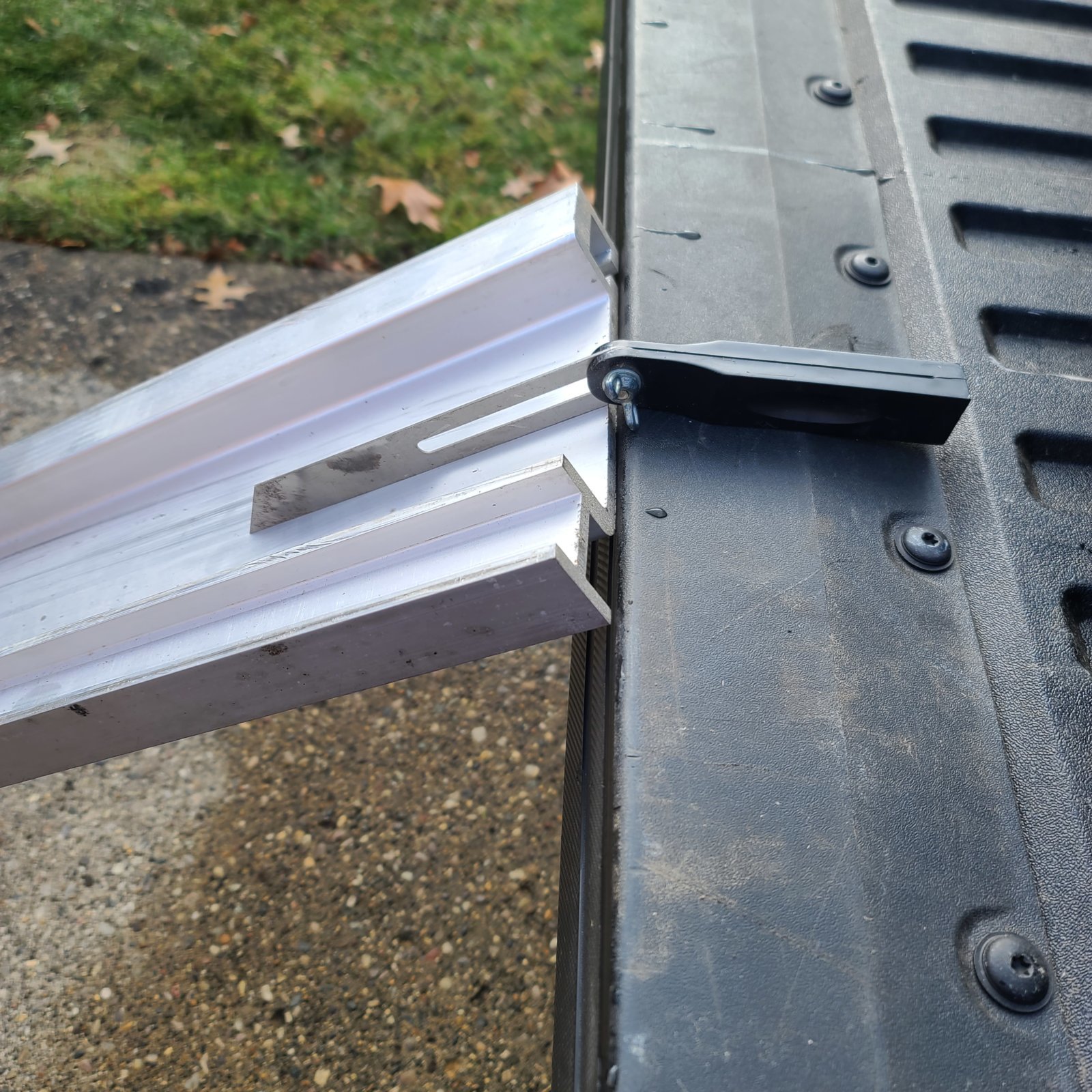

    I set one on the tailgate of the taco to find the angle I would need to bend the plate at.
    And I used an angle finder to record the angle.

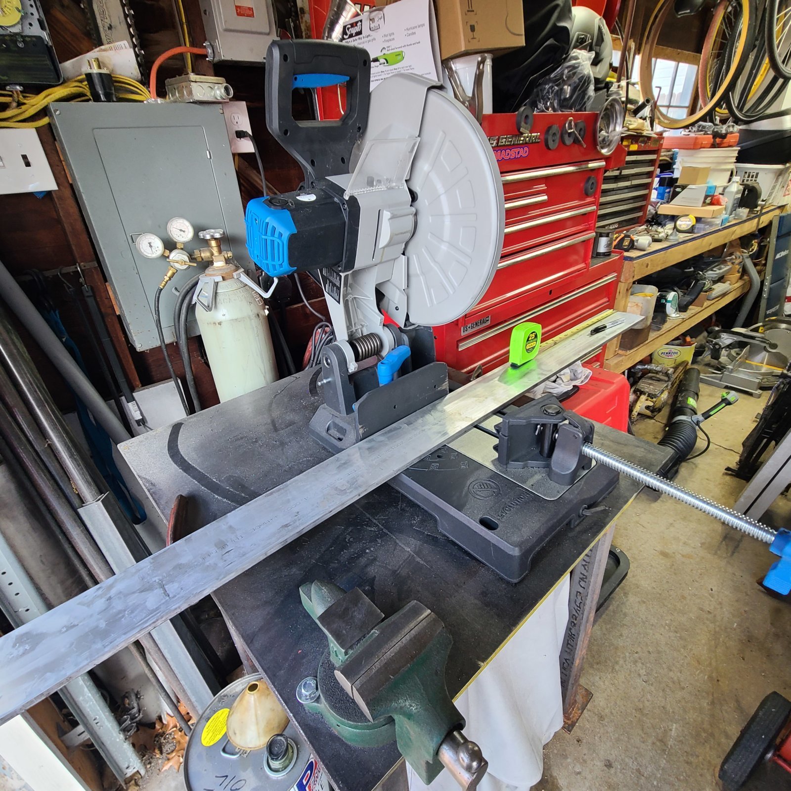

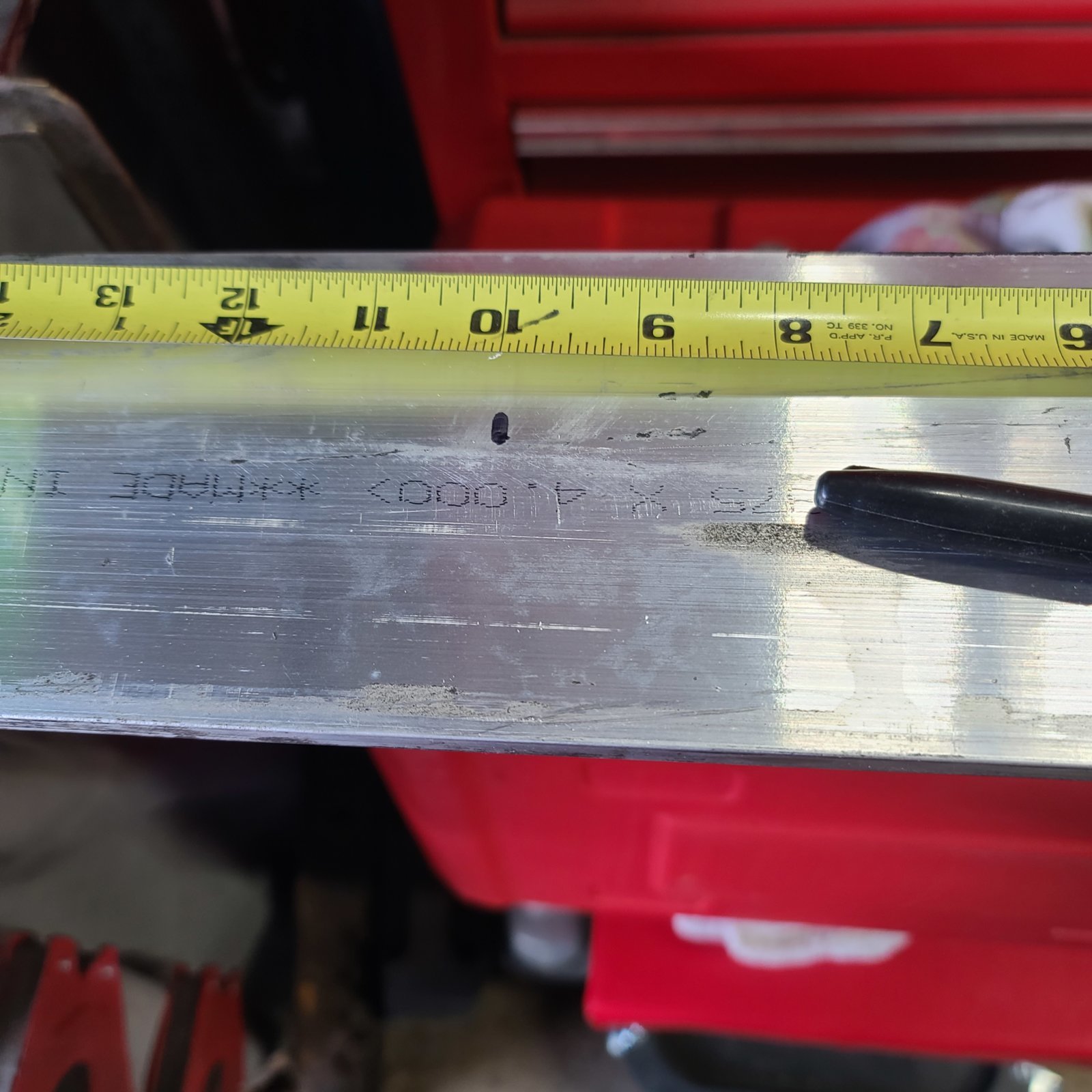

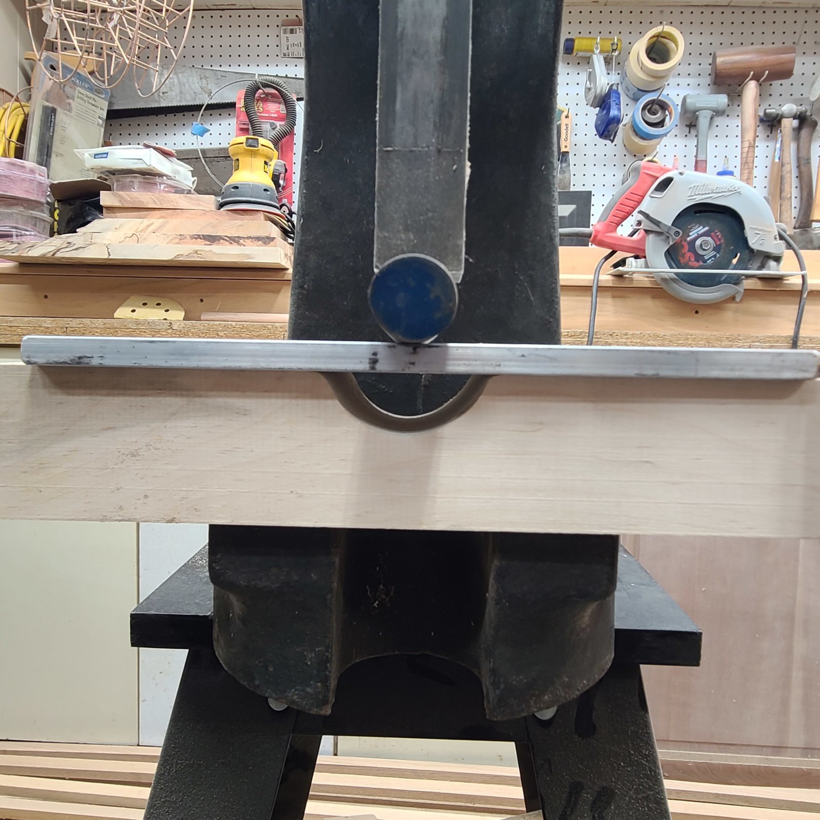

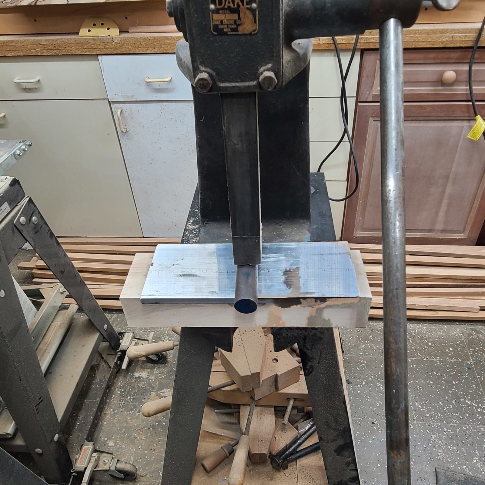

    Next I marked off two 10" pieces of the 4" wide 3/8" aluminum plate.20231209_115847.jpg
    I then cut them on my metal cutting saw.
    Then set up the press.
    Set a round bar on the plate.
    But it didn't budge. First failure.

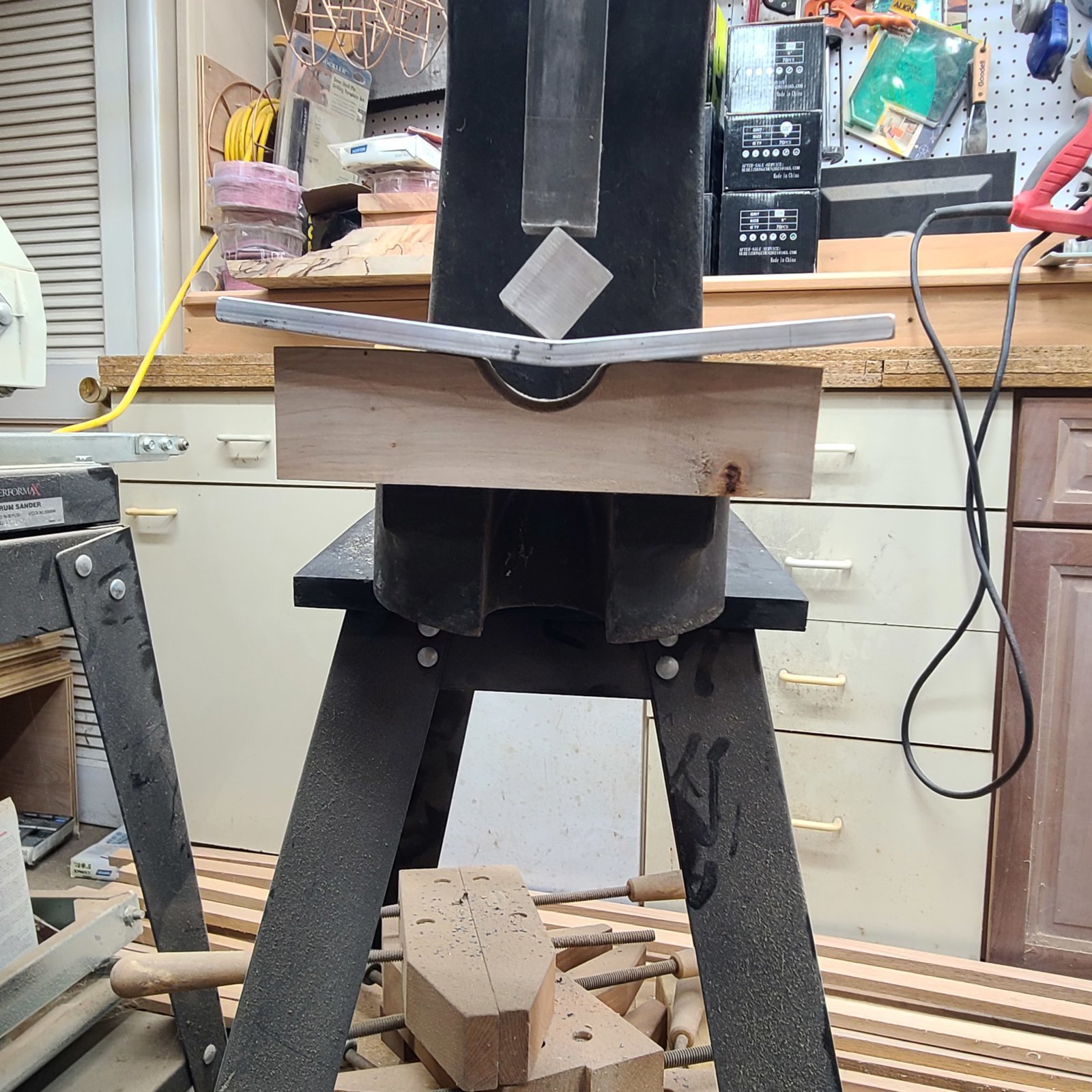

    I switched to a small piece of sqstock and took s.al bites, it was moving.
    And then the second failure, destroyed the Harbour Freight stand. It just could take my 200+ lbs hanging on the handle, lol. Bent the crap out of it.

    What series aluminum?
    3 and 5 series can be bent, whereas 6 series can crack
    Drainbung likes this.

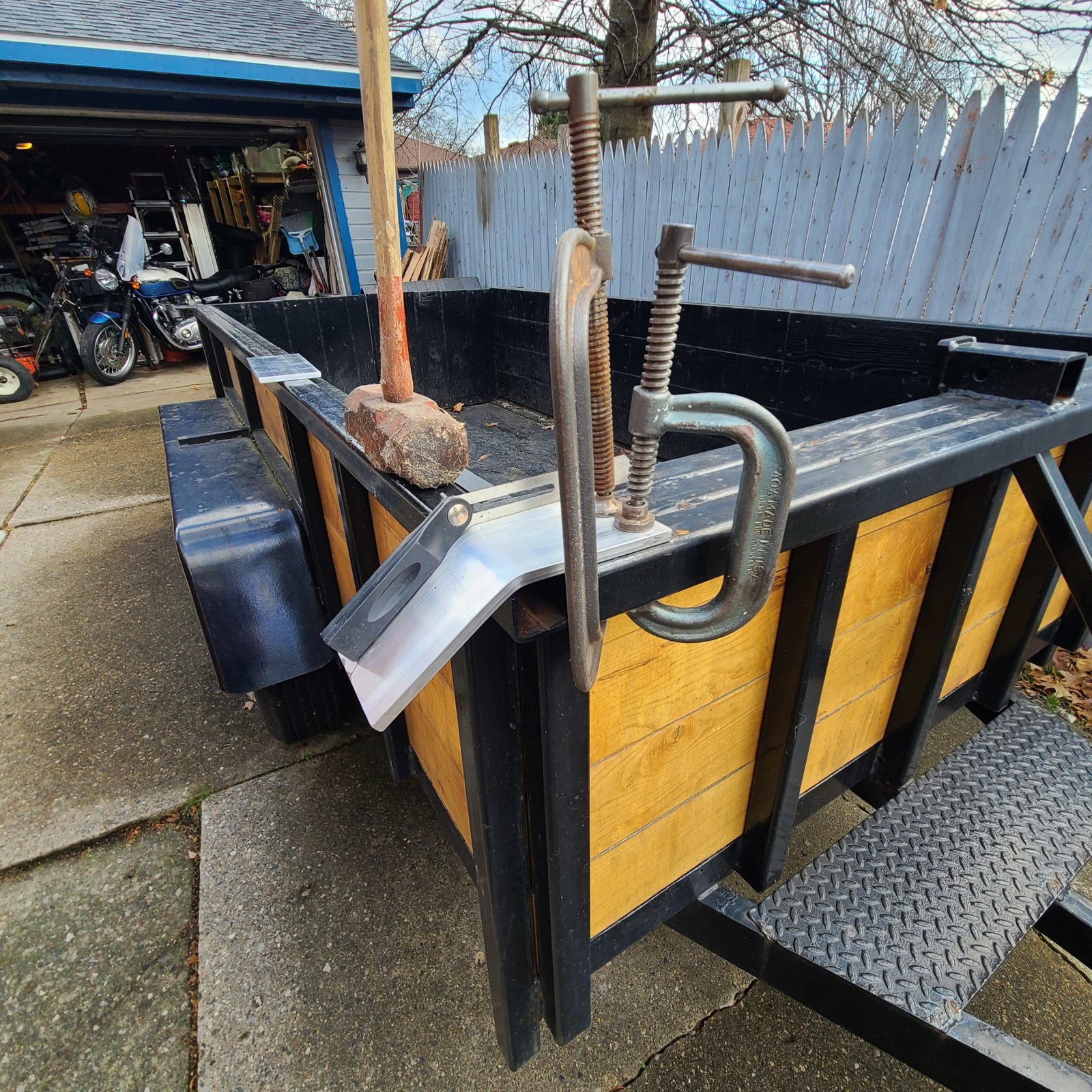

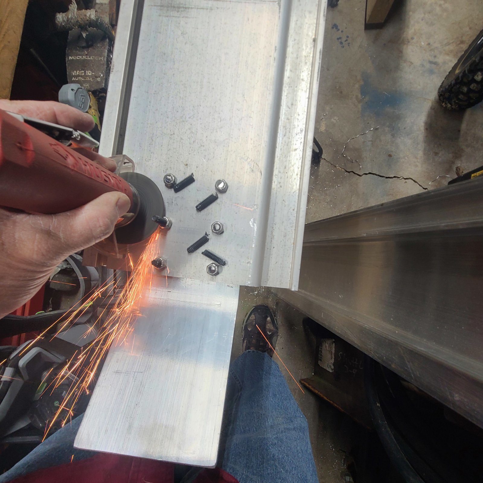

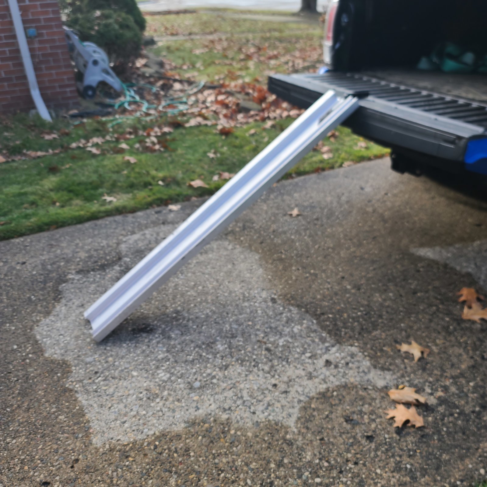

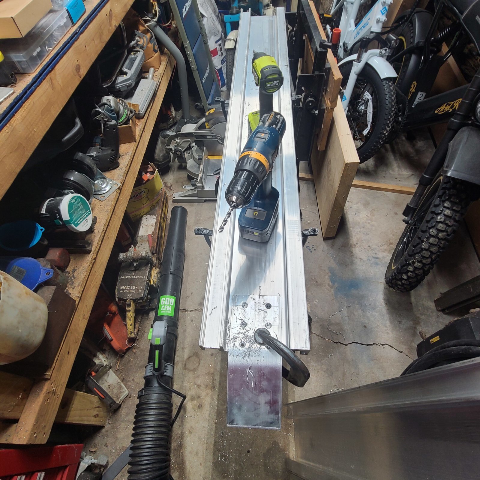

    So plan B. I clamped the plate to the top rail of my trailer and wacked it with a sledge hammer. It bent easily. The front rail of my trailer is seriously stout 2" x1/4" wall so i can mount a winch on it.20231209_134307.jpg
    So success.

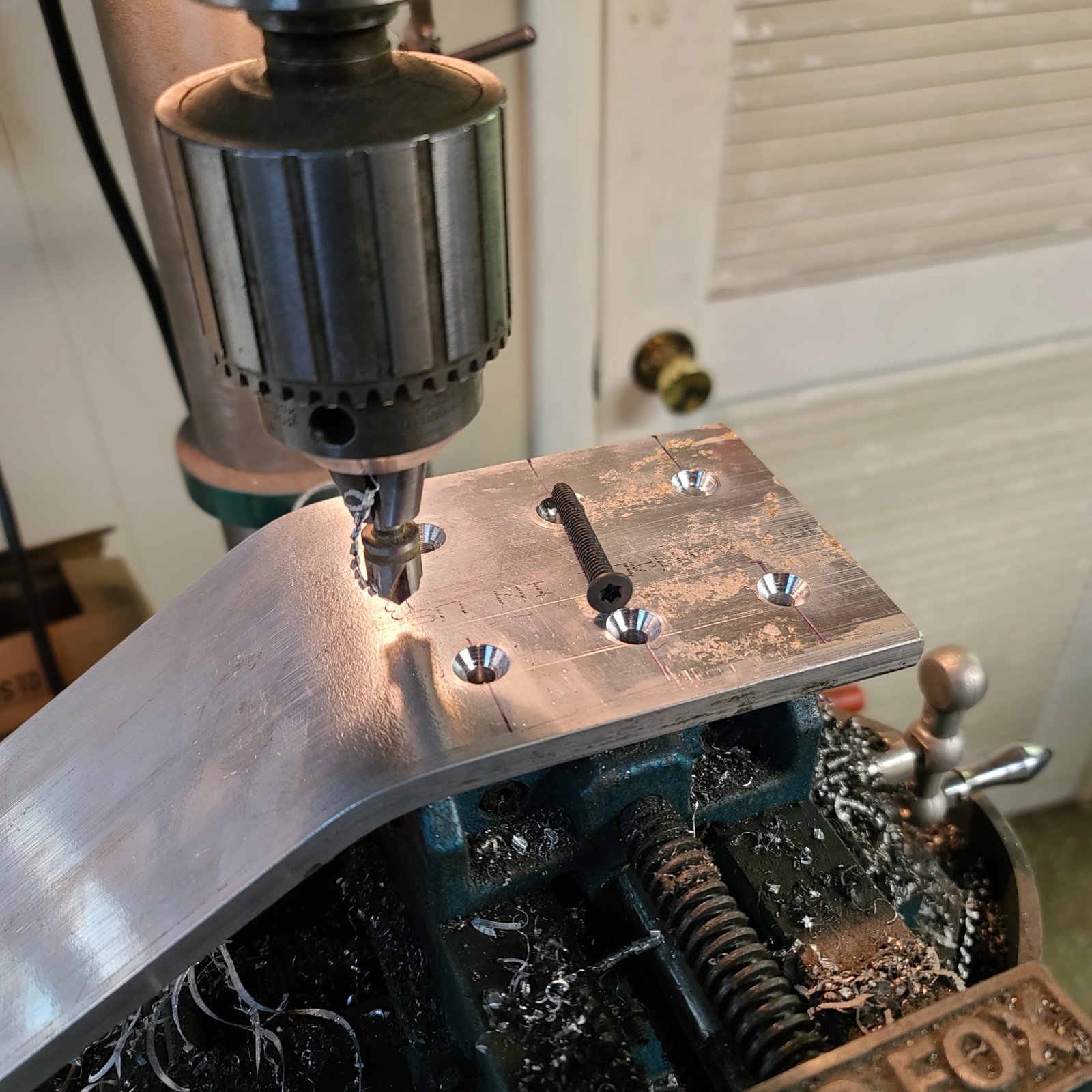

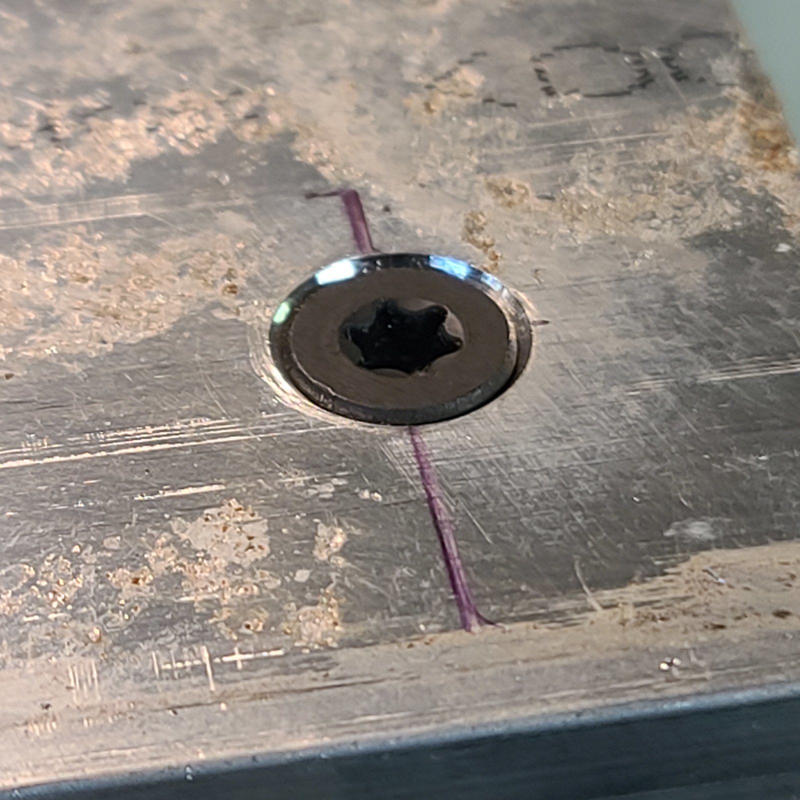

    Next I used a drill press to drill and counter sink some holes for the mounting screws.
    The screws are left over deck screws from when I built my trailer.

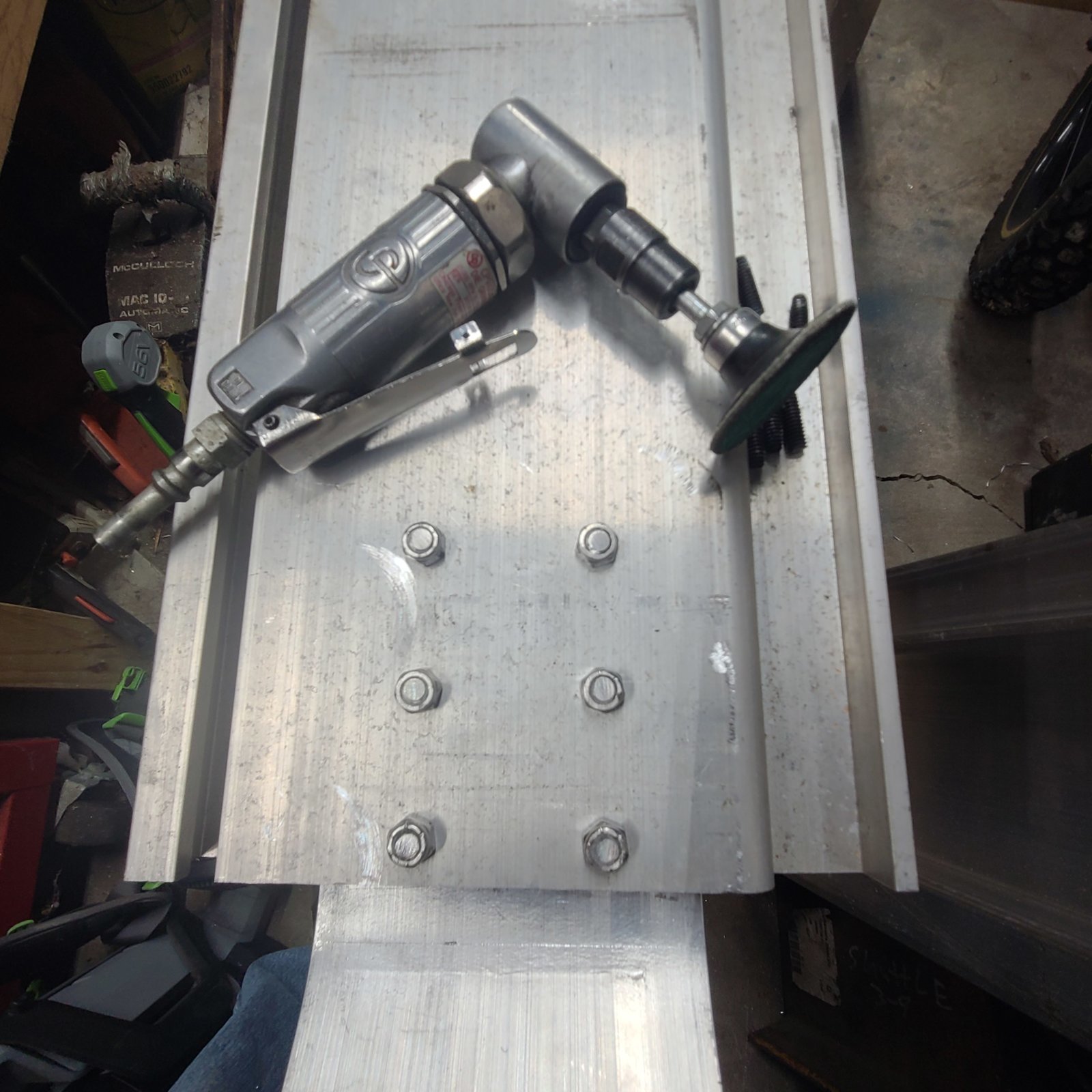

    I used the plates as templates to drill the holes in the ramps.
    The screewes where a little long so I cut them off with a cutoff wheel.
    And sanded them smooth with a right angle grinder.
    And now I have a pair of seriously stout ramps for next to no cost. I only purchased the plate and it was a cheap drop.
    So I can use these ramps to get things off the truck, or on the trailer because it is lower and easier to load. Or I can get up the side door step to get things down to my basement wood shop.

    I'm not really sure, it was a drop at the metal supplier. It did bend and didn't crack.
    I was actually looking for a stainless steel drop but none where to be found.

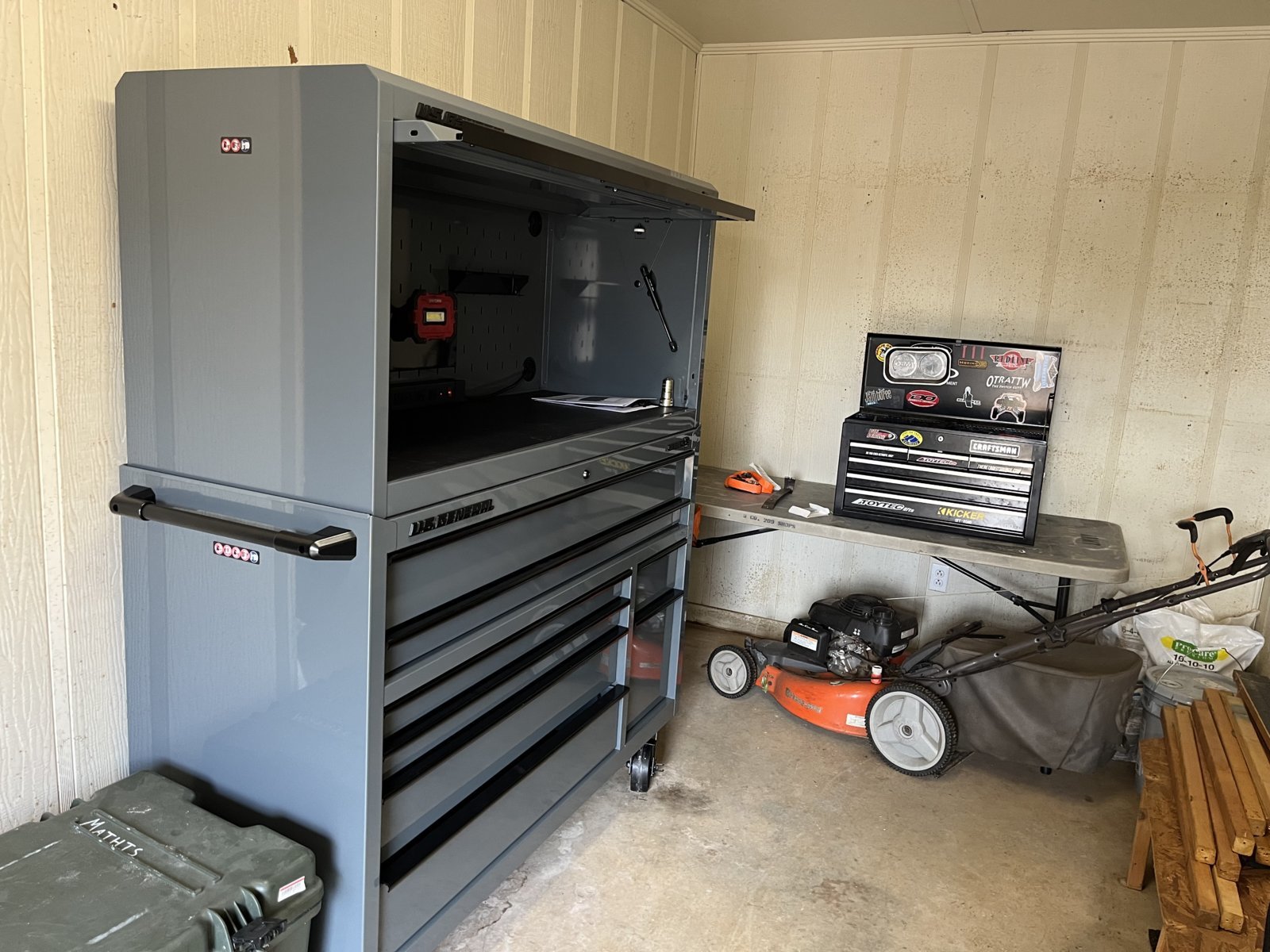

    Went from the small black box on the table to the 56” US General slate gray rolling tool box and top hutch.

    Nicely done. Maybe you have done so already but consider drilling a hole on each side of the ramp where the ramp sits on the tailgate so you can use some type of fastening system(ratchet strap) to hold the ramps to the tailgate so they do not slide out of position when you are using them.
    woodtickgreg[QUOTED] likes this.
  12. Dec 10, 2023 at 5:07 AM
    #6132
    woodtickgreg
    woodtickgreg Well-Known Member
    Jun 10, 2021
    #368186
    3,313
    Greg
    Michigan
    Yeah I need to do that.
