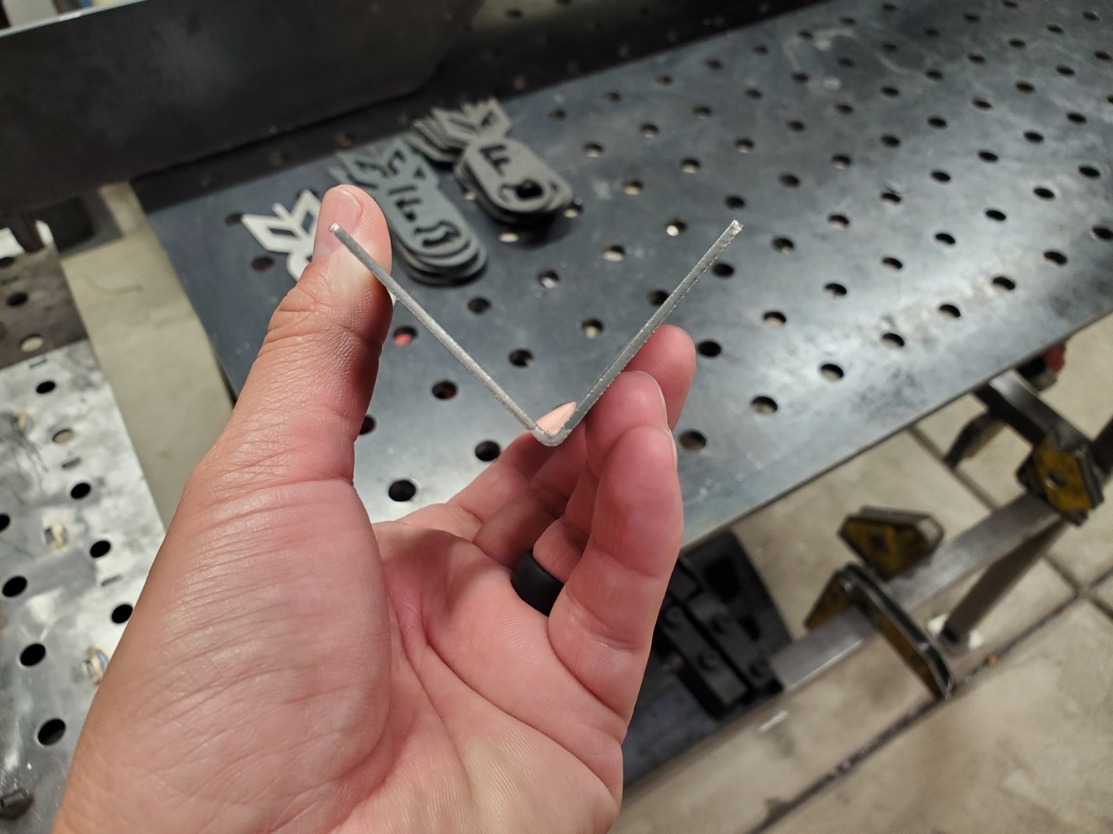

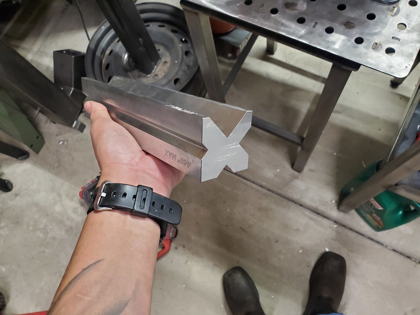

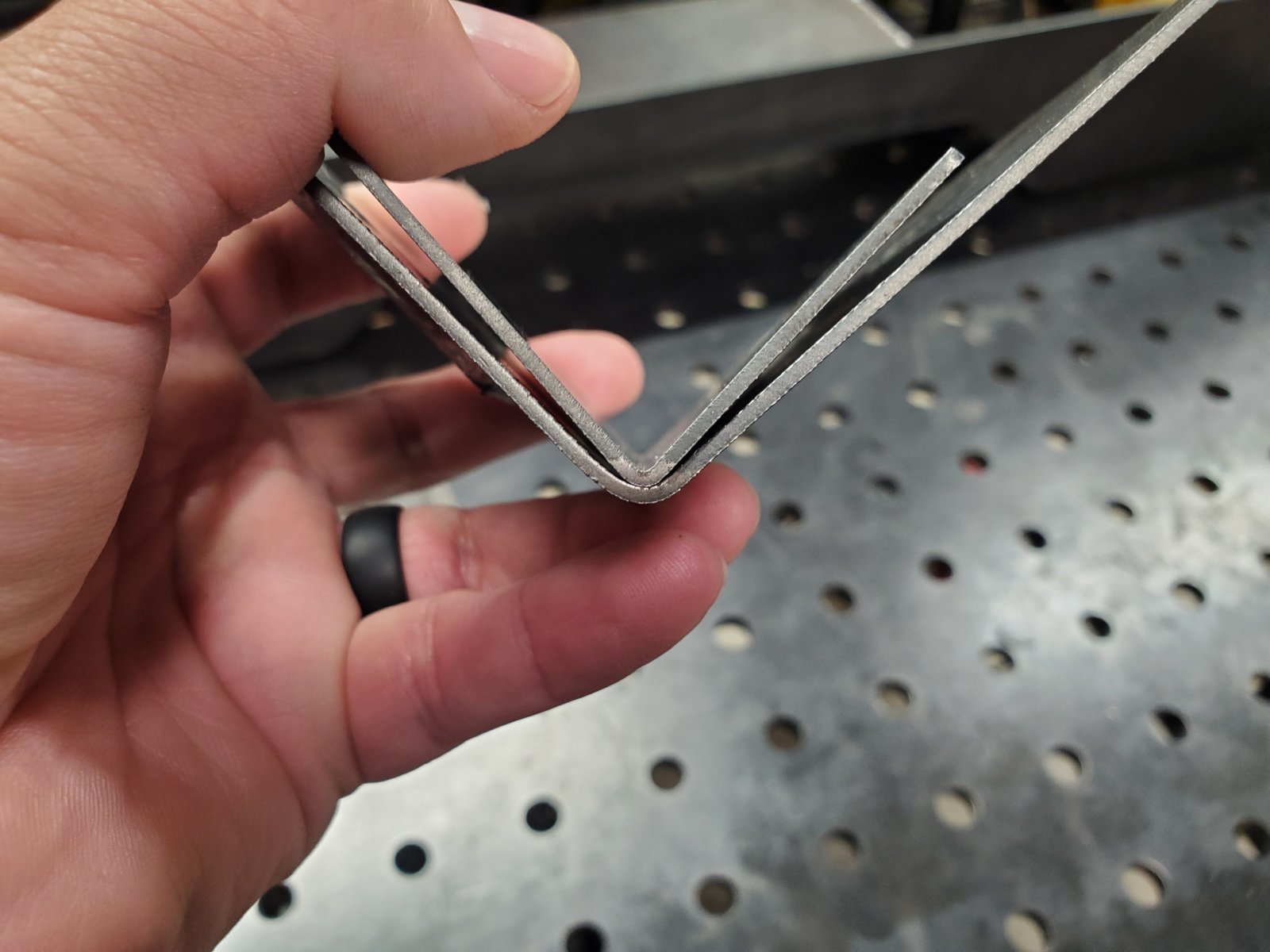

    Bought myself a little press a few days ago, which arrived yesterday.
    I opted for the 'deluxe' package as it not only saves you money for their 4-way die, but the package itself was on sale making the die a lot less expensive.
    Now, just wanted to give an example of a few bends as this is the main reason for investing in it.

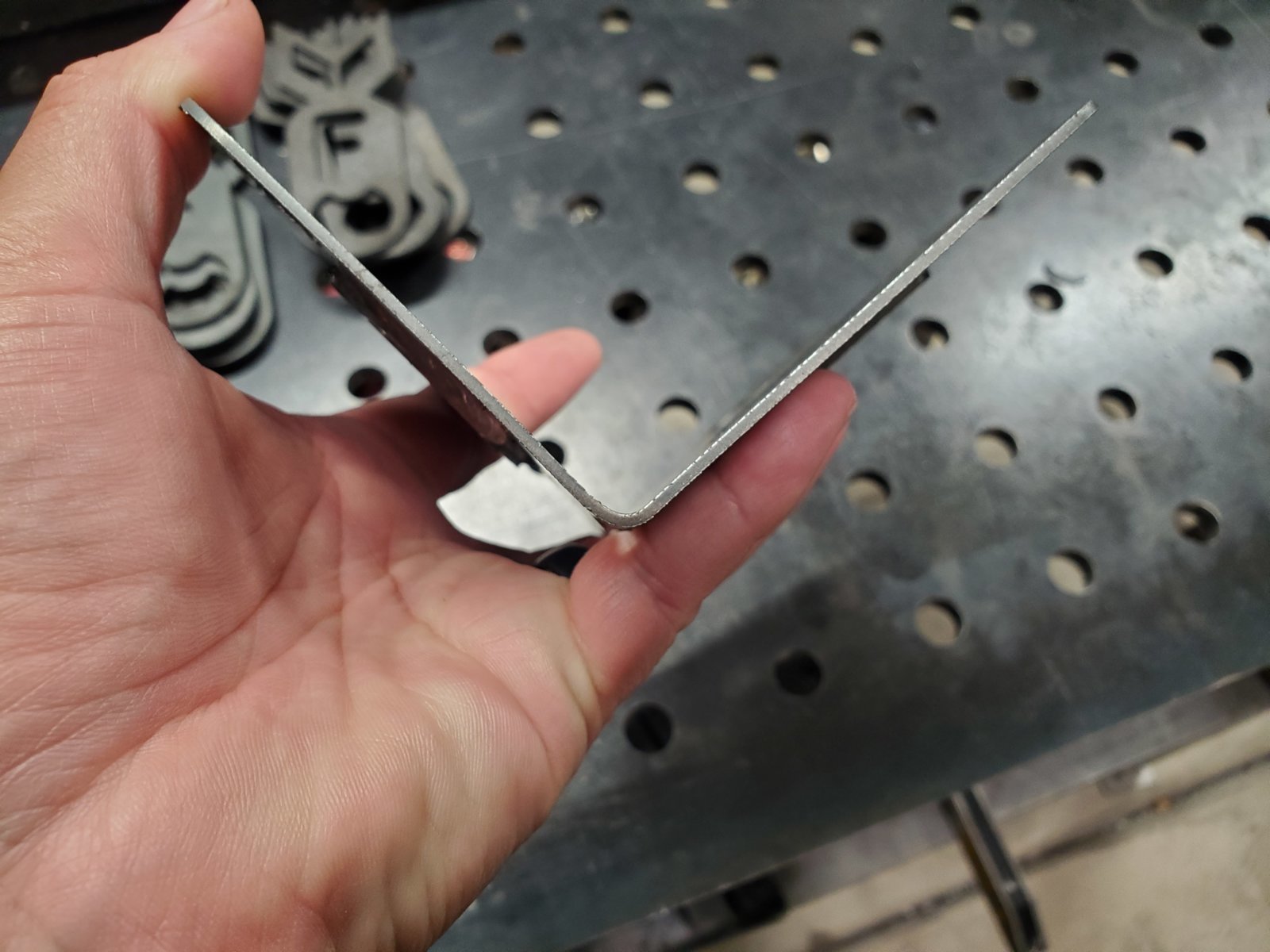

    The swag kit I own, even with stacked angle iron or an improvised die setup, creates too large of a bend radius on thinner material (even 3/16").
    That just made me look into doing relief cuts and creating a tighter bend radius myself using a vice.
    Worked out, made a lot of brackets and even bed stiffeners that I sold on here.
    To keep it comparable to the above item, here's 16 gauge bent with a large relief cut.
    Much tighter than the swag kit and this was just using the edge of my welding table.
    However, the bend press uses not only 4140 tooling for the punch and bottom die, it also uses a much more angled punch to better utilize the 4 way die for whatever thickness you need.
    Here's 16 gauge.
    Easily a big difference.

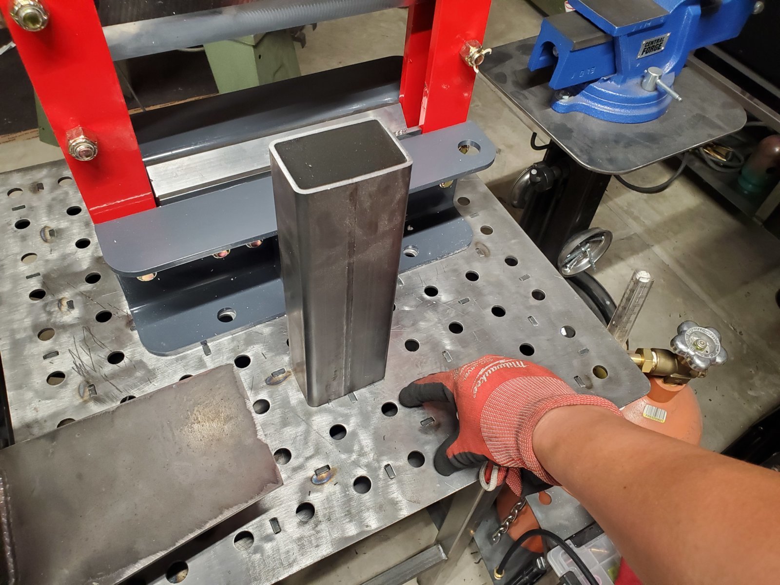

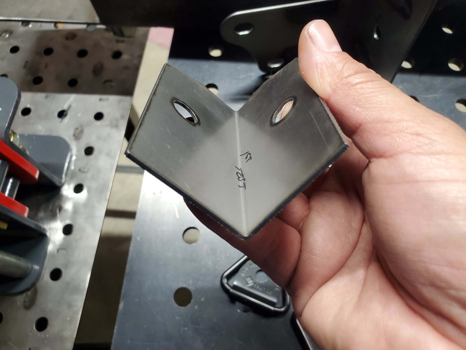

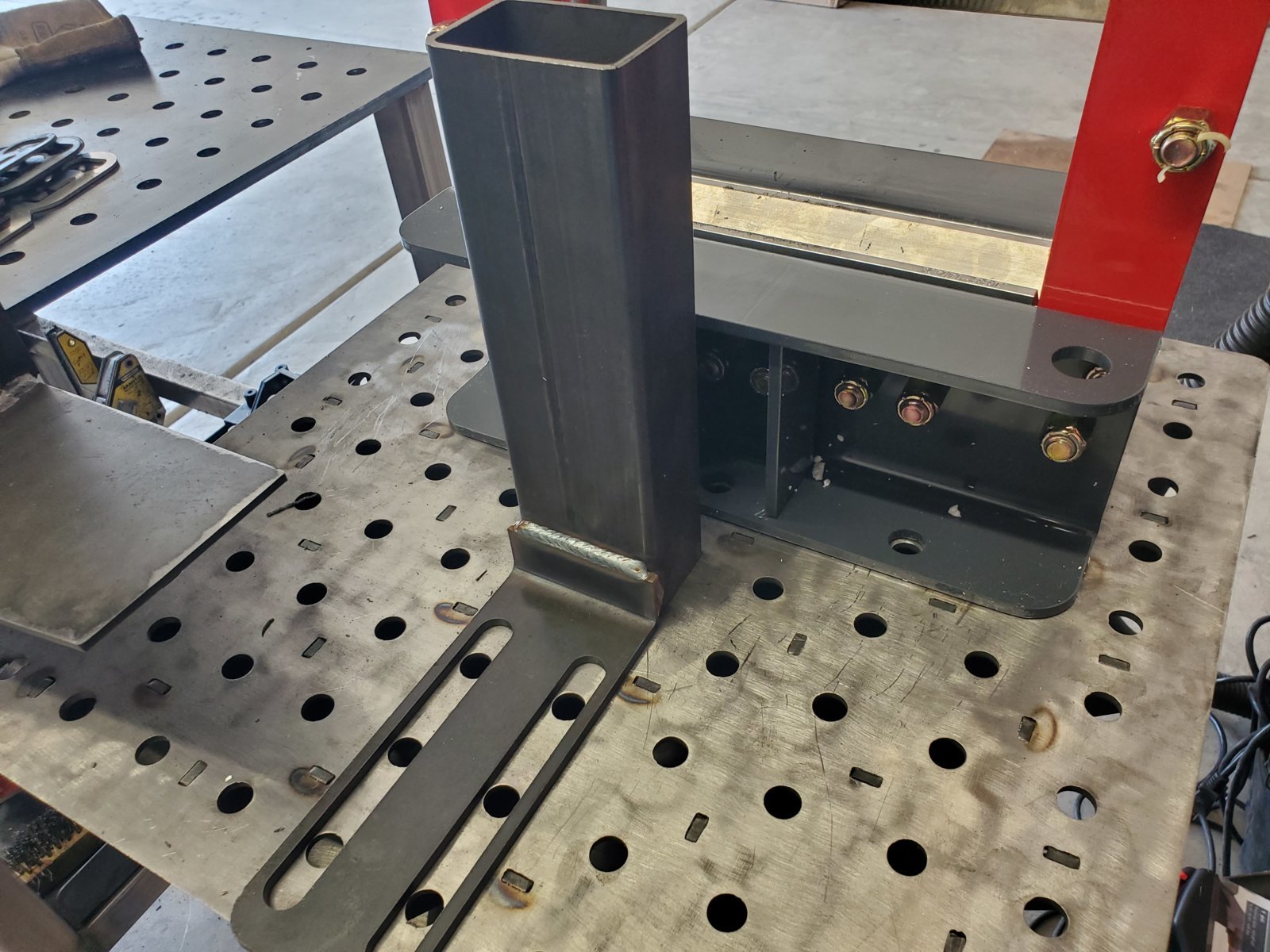

    Since I've got some parts I'll be making in the near future, I also wanted to incorporate my own backstop.
    Came out square like it's supposed to.
    Really want to get those locking pins but they're like $60 for just 4 of them. Either need to find a cheap set of 2 or just use bolts but she's done.
    I'll get an air over hydraulic setup eventually (like I ran on the swag kit). Just happen to have this jack lying around new and never used.

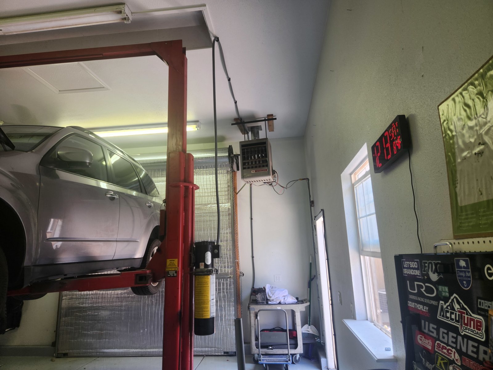

    I have had an electric garage heater in my Amazon cart since last winter. It went on sale for prime days for 55% off, so I pulled the trigger and bought it. The day after I recieved it it went down to 70% off. So I got ahold of an Amazon customer service representative which was not easy, and they gave me another $28 back as an Amazon credit, perfect. So I got this thing for a little over $110 ish.
    I also got a wall mount thermostat for it instead of the built in one. It runs off a 40amp 220v circuit, 7,000 watts. I'm not trying to heat the whole garage just the area in front of the workbench. No kerosene or propane, just turn it on. It'll work well for me since I'm not out in the garage much in the winter except for occasional projects. Wintertime I'm in the basement woodshop.
    it has good reviews on YouTube.
    I hope to get some of the installation done today. Gotta run some 8 gage romex to it after I hang it.

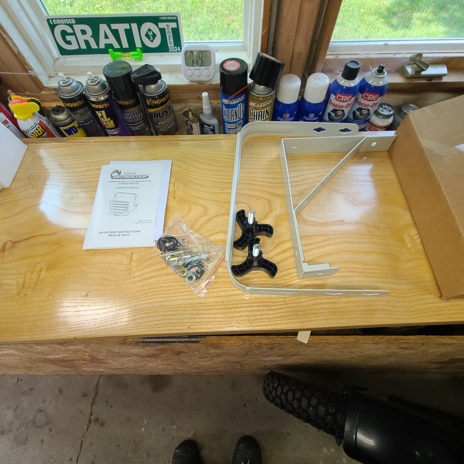

    Got the heater installed yesterday. Ran 8 gage romex and a 40 amp breaker. 16 gage wire for the thermostat.
    I had to make a bracket to mount the heater to the rafters.
    Just a cut 2x6 and some scrap plywood. Plenty strong for the heater to hang from
    Bracket and hanger mounted.
    And the heater hung in place.
    And the thermostat will make it convienient.
    I tested it briefly and it does blow some serious heat, was kind of surprising really. But I quickly shut it off as it was already 84 degrees in the garage. Fall and winter will be the real test. I think it will do just fine heating the area in front of the workbench.
