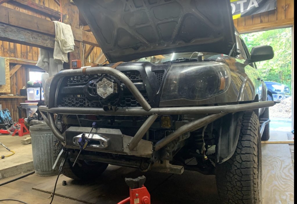

    I appreciate it, still learning but I feel great about the work Ive done.
    In my mostly uneducated opinion the bender shouldnt matter that much as long as it doesnt mangle the tube. Most of the magic happens in the tube layout, placing bends, and doing the notches so everything fits well.

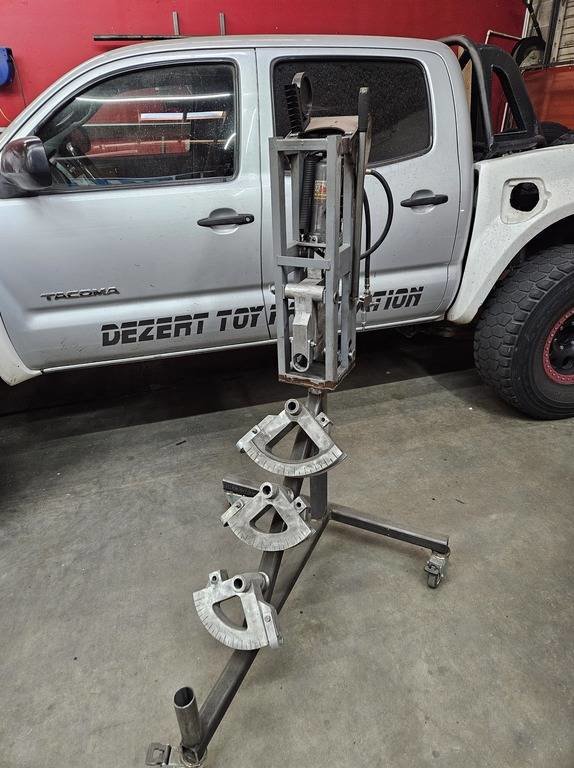

    Same.
    I've been using one for around 15 years (build around 100 bumpers and multiple roll cages)

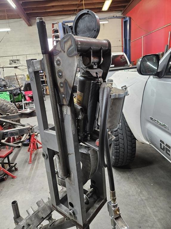

    Ooo I like your cart setup for it. If your bending out of plane does it ever get tippy?
    Drainbung likes this.

    I typically bend on the same plane for all my stuff but I'm sure it would be fine considering I built it from 1/4" x 2" square tube. It's super stable rolling around my shop even with a tube in the die.
