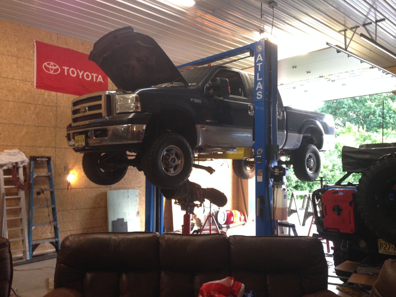

    Easiest is lift first but gotta think ahead for that. Best bet would be to use a thermography camera and map out the lines. I left out a spot in the floor where I had the lift to be mounted and left myself some margin so I didn't risk hitting the lines. 4" 3000 psi is the minimum required for a lift typically, I did 6" 3000 psi at the lift pads and 4" thick everywhere else.
    I went with an atlas PV10P, it's more than enough for the biggest truck I'll ever have on here, it lifts my F350 diesel no issues.
