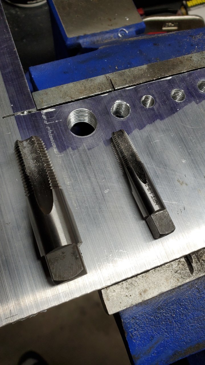

    First time using NPT taps so I practiced on some scrap 1/2" aluminum. Now I can tap my intake manifold.

    Can't tell from your picture, but I always make sure to use plenty of light oil with my taps and dies. Gun oil or 3in1 oil seems to work well for me. Light turns in and out will help remove debris and help give you nice clean thread cuts. I've taken care of mine and they have lasted a long time.

    Thanks for the tips! I used a bit of tap magic cutting fluid. I probably went in a few too many turns before pulling it back out to clear the chips from what everyone is telling me. I'll make sure I clear them more often.

    I have learned by snapping off some taps before when I am starting to hit too much tension with the tap. Now I try to be very patient and let the tap tell me how far I can go. And sometimes I will still break a tap off.

    Tap magic works well. They a formula for Aluminum that Ive found works a bit better for tapping aluminum (but the regular stuff works great too).
    It should never feel "hard" to turn. If it is its either chips or the wrong size hole drilled. Especially on smaller stuff it often needs a letter or numbered drill size but most people just use a fractional and call it good enough.
    Sharp taps and the right size tap wrench are the key
    But for me its generally one rotation then back off 1/8-1/4 turn.

    Removing a broken bolt can be its own special Hell sometimes. But drilling & removing a snapped tap, that's a real fun job.
