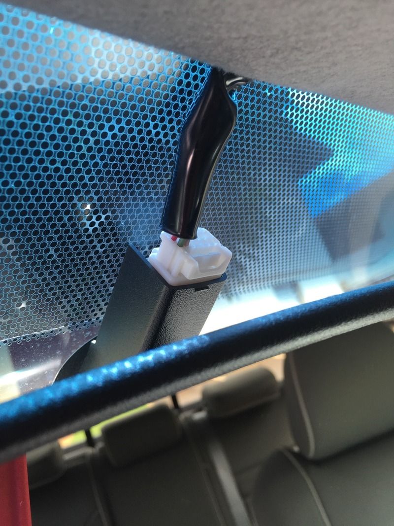

    I didnt touch the bluetooth mic for that reason. That is my 2015 console. I added just the screen to the console. On the bottom sunglass holder, there are melted tabs on the back side. I cut the tabs off with a razor blade and the put just the screen in there. I then clamped it down and epoxied it in so it wouldnt move. Its the wiring thats a bitch to do. You have to run 2 wires all the way to the radiator and one behind the radio, and tap into a couple wires in the headliner.
    Below is the info I got from @adio, I followed his directions to a T and it worked first try.

    Did your 2015 not have the temp sensor in the front wired in? Mine does and it is connected to something. I was thinking all I had to do was to just plug it into the plug the bluetooth is connected too and find a way to wire back the bluetooth into that harness.

    Ya i have the sensor. Noone knows where the wires come in the cab though. You have to cut and splice the new wires to the sensor. It is not a plug in play, @nazlax10 , & @adio did a lot of leg work on this project and can confirm it is not plug and play

    So splice wire to sensor, splice wire to radio, splice wire to power in overhead and connect to a new plug to plug into overhead temp unit.

    Bingo. 2 to the sensor,one to the radio. power, illumination, and ground are really easy. There is a plug up there for the advanced rearview mirror, So i just cut and wired directly to those since it was right there.

    Can you tell me which wire in the advance rearview mirror was for what? Thanks.
