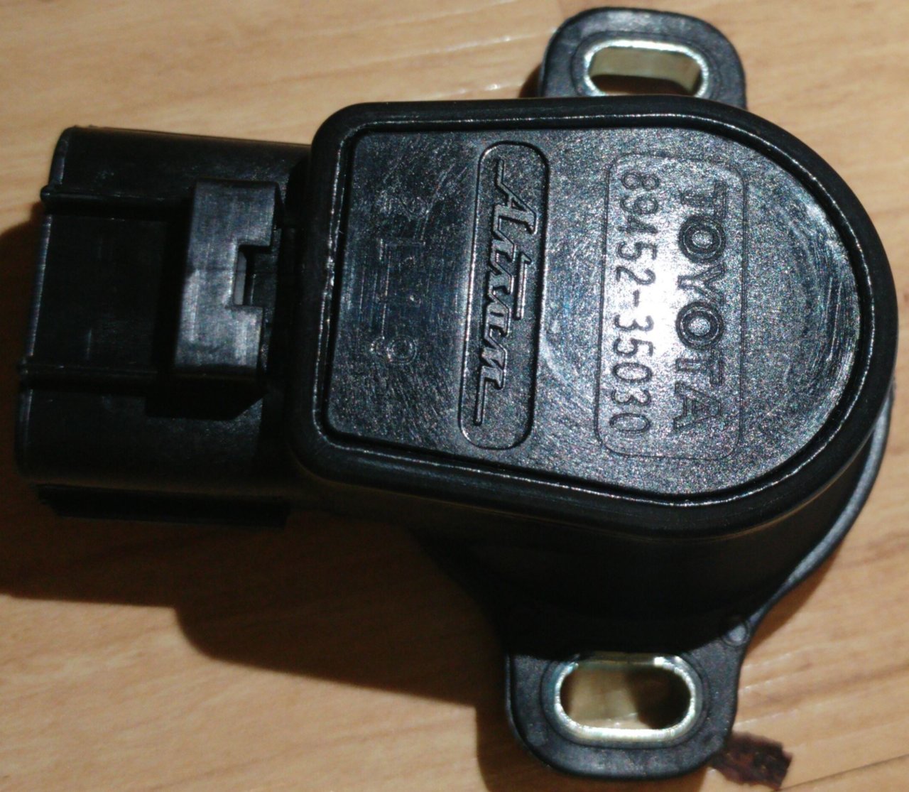

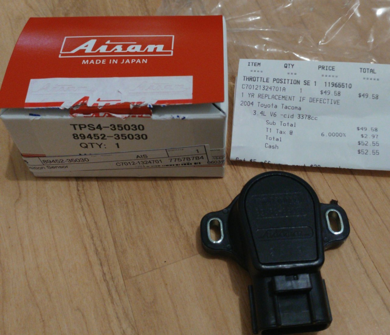

    Before I read these responses, I found a part that's supposed to be compatible here in town for just $50. Sold by Advanced Auto Parts, Definitely keeping the receipt handy for this one. Here's picts of it and the receipt with some ID#s & the box. Might as well screw it on and see what happens. What should I expect? Nothing but idling? Nothing but red lining? Flames?

    Just switched in the new TPS and took it for a quick spin. All seems well ... just like it does 95% of the time with the factory TPS. Going to take some time to know if this helped.
    One thing though - the Check Engine light's now on. Any guess as to what's going on there? I'll run it by an auto parts store to read the codes sometime soon.
