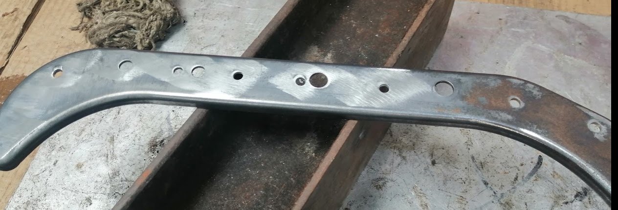

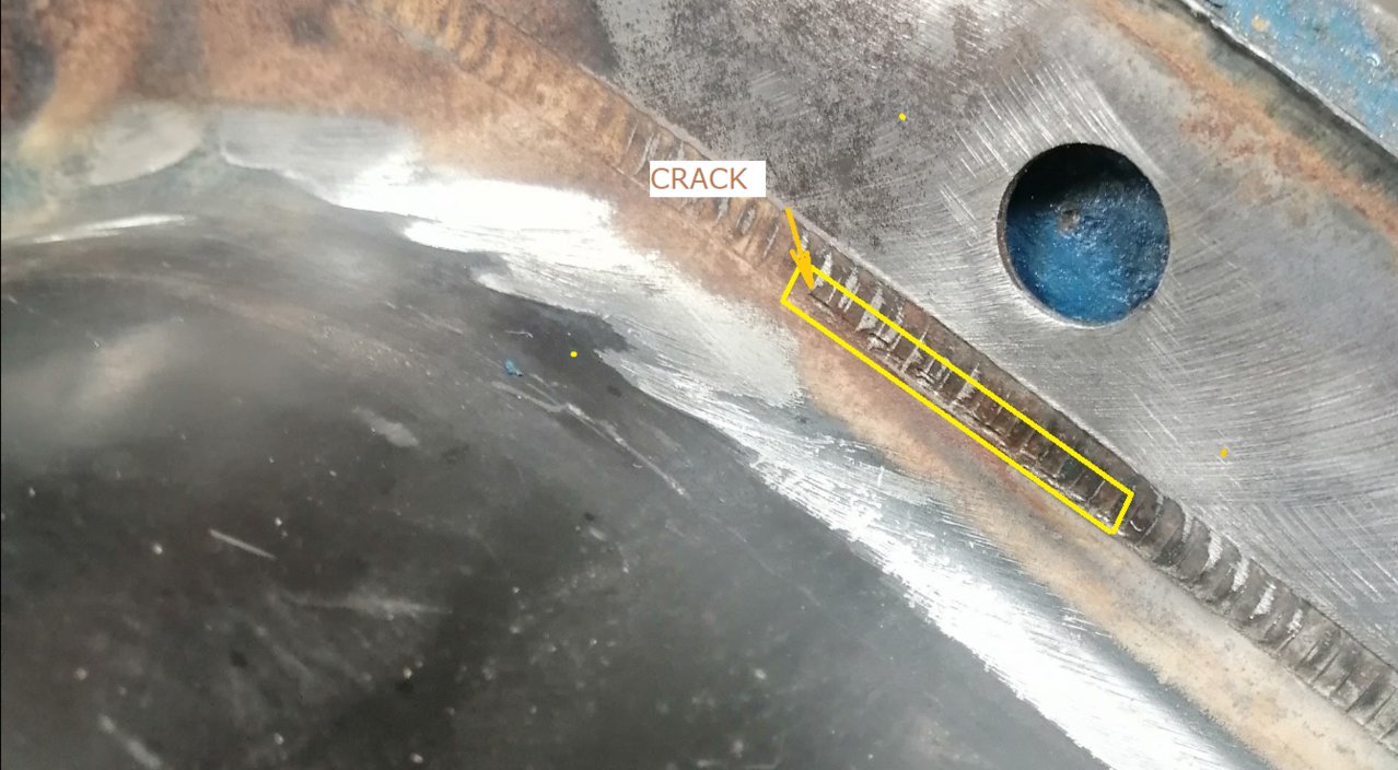

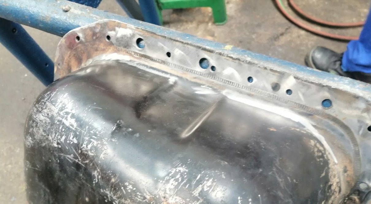

    UPDATE: I had to give up on trying to fix the leak myself. Tank removal needed to be done on a lift. So I took it to a highly recommended shop for repair. After 3 trips back, they gave me my money back and I looked somewhere else. 2nd shop same result - 3 trips still leaking. The 4th time back I asked if I could work with the mechanics and help find the leak. After about 3 hours of looking we could not find anything. I suggested that we put some soapy water in the tank, pressurize it, and see if any bubbles showed up. Finally spotted some bubbles coming out from behind a bracket spotwelded to th e tank. Removed the bracket and found a very small crack in the tank behind where the bracket was mounted. Welded the crack, reinstalled the bracket, and now the tank is leak-free.
    A real hassle, but finally done.
