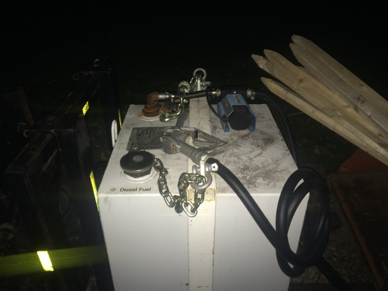

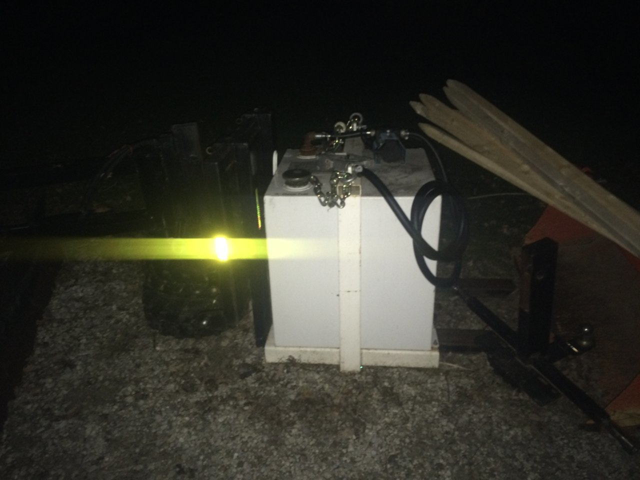

    Here is my setup. I couldn’t find pics from building it so I took these just now. I built a platform with fork pockets to move with my tractor or it can be lifted by my bucket with the chains / hoop that goes around the tank. Small 12v diesel pump from HF was $99 on sale but the gasoline version is way more expensive.

    That’s a nice set up. How many gallons is the tank? Also how big is your tractor? I have a small B series Kubota with clamp on forks. Not sure it could lift to much.

    50 gal like I linked a few posts above. I have a B1750. It has an newer loader but it barely lifts the tank full.
