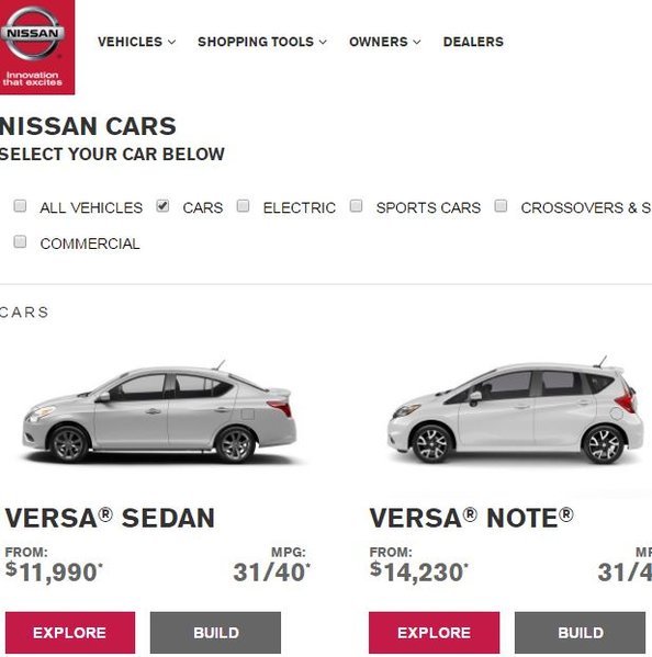

    In this day and age 24k is cheap. That will barely buy a commuter car.

    Barely.

    I said car. Not matchbox
