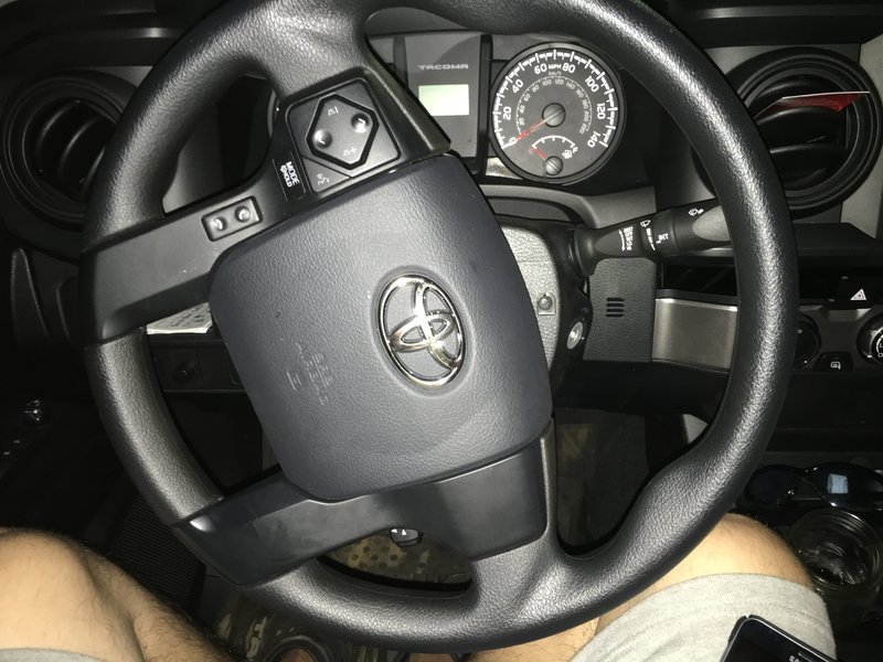

    Left and right plastic panels on my steering wheel are black. Stereo controls on the left, blank on the right.

    I believe the urethane wheel in the SR is the only one that has the black accents. Which is also the only setup that doesn't have the right hand controls. Looks like both sides would have to be swapped to silver.

    Here is my wheel

    Same as mine
