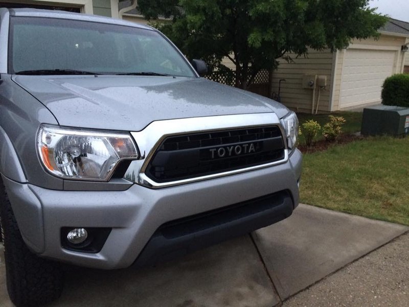

    I haven't decided if I want to color match or not. I feel like the paint will get scratched and/or chipped a lot easier. Plus I'd rather spend the money on other functional upgrades...

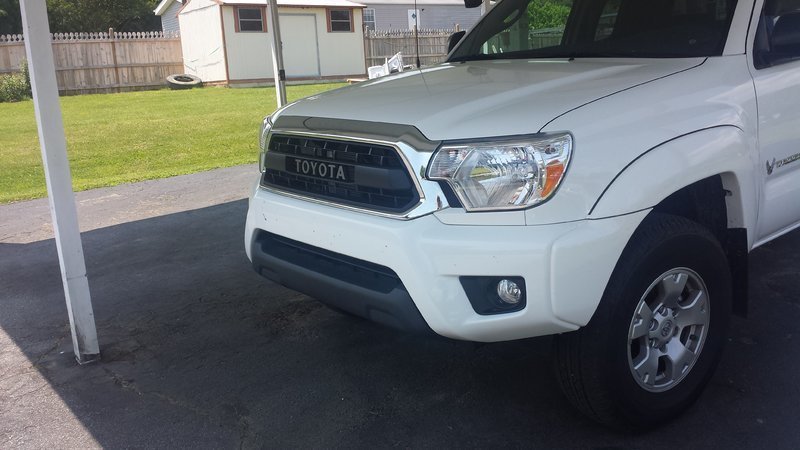

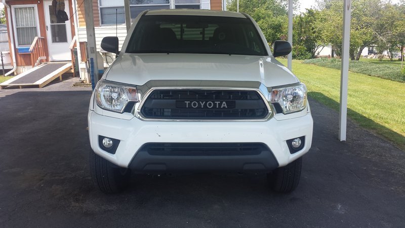

    It wasn't terrible. I did break a tab on the grille surround when removing the grille from the truck though. I found a write up online somewhere with some tips and followed that but it wasn't clear on how to work the grill out. That's when I broke the tab. Basically just a couple screws and a few clips and you push the grille assembly out.
    Getting the insert out is a bit more difficult. They way it's in is overkill. 12 Torx screws and a shit ton of tabs. Good luck

    I just did this on Sunday. I used a small common screwdriver to pry the tabs away from the plastic post at first and when it didn't come loose I realized that there were more tabs in the center of the grill, just gently push the center tab in on those. The other problem You may have if it doesn't start to separate is the foam piece at the top of the surround. The heat from the engine and summer temps may have let the glue seep from the foam and the two pieces will stick together. One last thing to also remember is to remove the rubber seal from the top of your old grill and reinstall it on the new grill. TAKE YOUR TIME and DON'T force anything, you don't want to break too many of those tabs. When I did mine it took me about an hour from start to finish.
