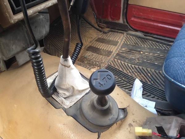

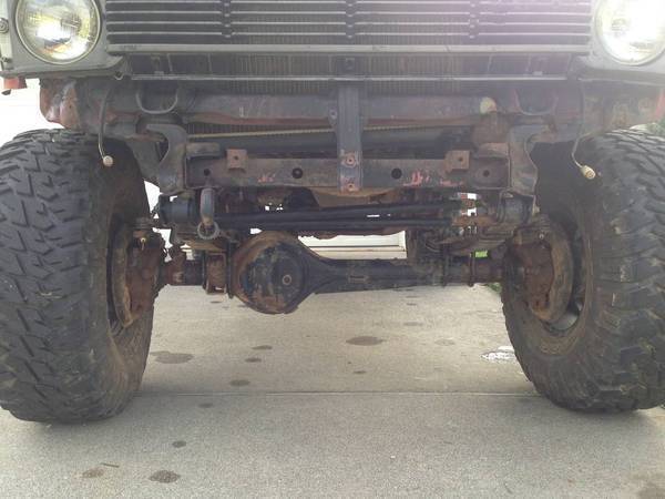

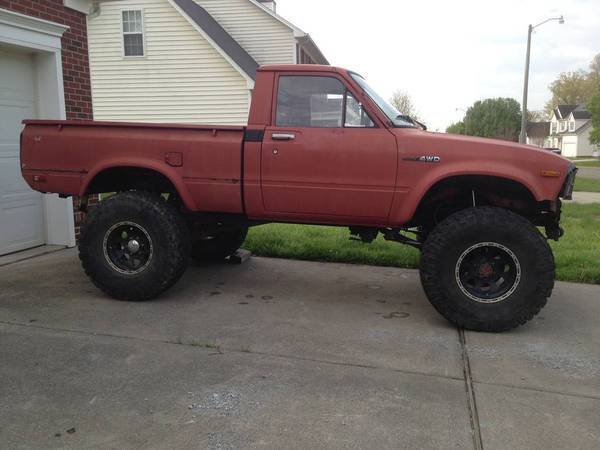

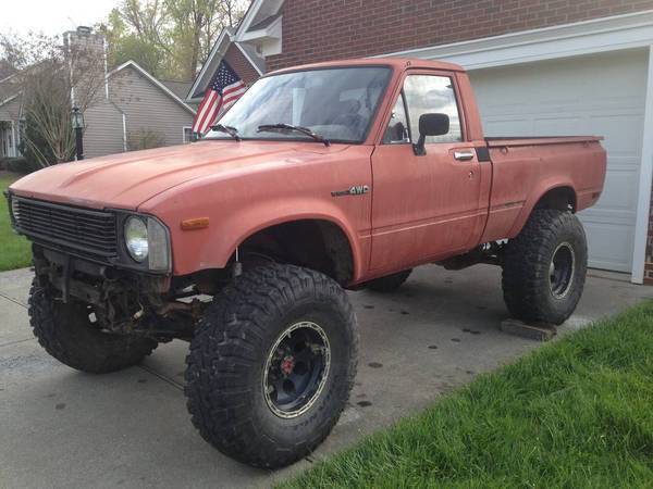

    Specs:
    1982 Toyota Pickup
    22R
    5 speed
    4.70:1 trail gear transfer case gears
    Front:
    Rear leaf springs up front
    2" Skye off-road banana shackles
    Rough country shocks
    Trail gear stainless steel brake lines
    Trail gear ubolt flip kit
    Lock-rite front locker
    79-81 round headlight swap
    2" wheel spacers
    Custom front drive shaft from universal automotive
    Triple drilled flanges
    Trail gear hi-steer
    IFS steering box
    5.29's
    Solid spacer
    30 spline longs
    Chromo inner and outer hub gears
    TG Truss
    TG driff guard
    TG knuckleball gussets
    ARP hub studs
    Rear:
    Chevy 63's
    Ballistic joint shackle hangers
    Custom 6" shackles
    Rough country shocks triangulated in
    Welded differential
    2" wheel spacers
    5.29's
    Solid spacer
    Wheels and tires:
    37x14x15 Iroks
    15x10 steelies
    Misc:
    CB radio
    1987 4runner bucket seats
    Future Plans:
    Bumper
    Winch
    Sliders (DONE)
    5.29's (DONE)
    37's (DONE)
    Chevy 63's (DONE)
    14" Bilsteins(DONE)
    8" Bed bob(DONE)
    16" Dovetail(DONE)
    Some pics
