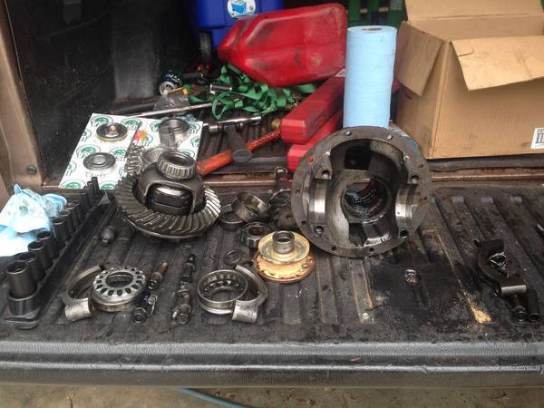

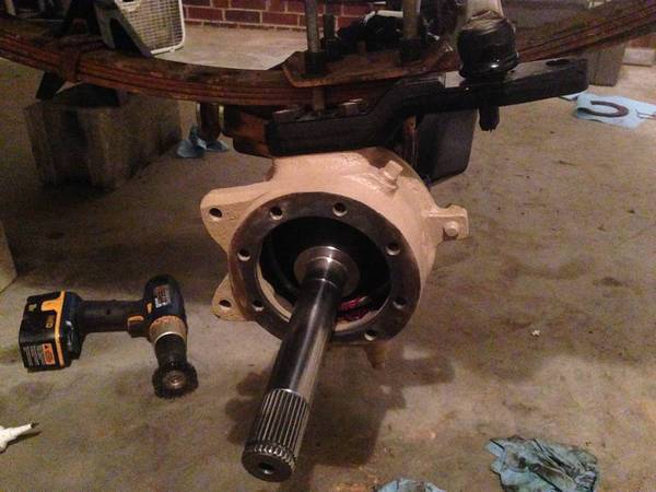

    So the local auto parts places didn't have the right size spindle nut socket but I ended up getting them out with a little lovin from a hammer and flathead and judging by the gouges in the nuts not the first one to do this. My neighbor works on tractor trailers for a living so he's bringing me a 2 1/8" socket for reinstallation.

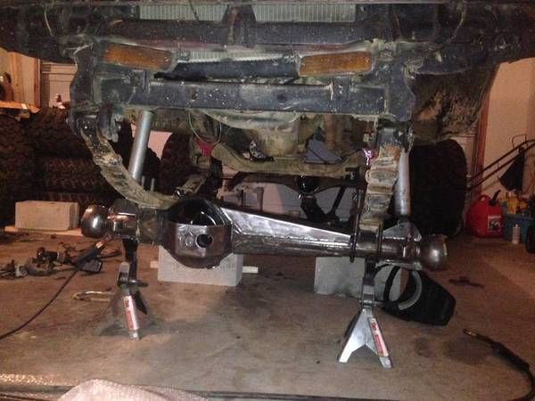

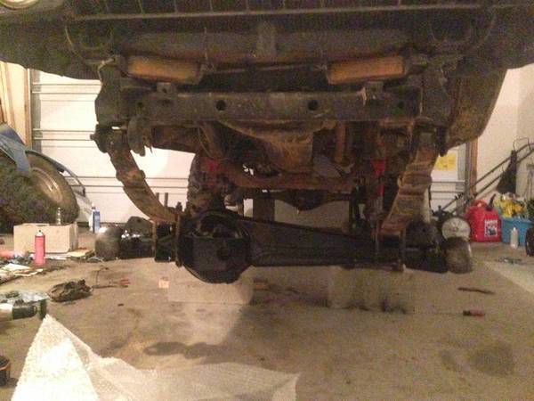

    Update time. Making progress slowly but surely. Last of my parts comes in Thursday and I only work one day next week so *fingers crossed* I should be able to take it for a spin next weekend. Here it goes....

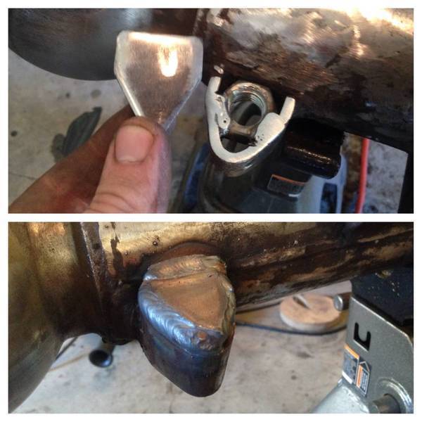

    Bombproof steering stops

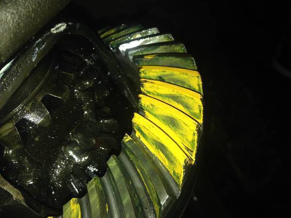

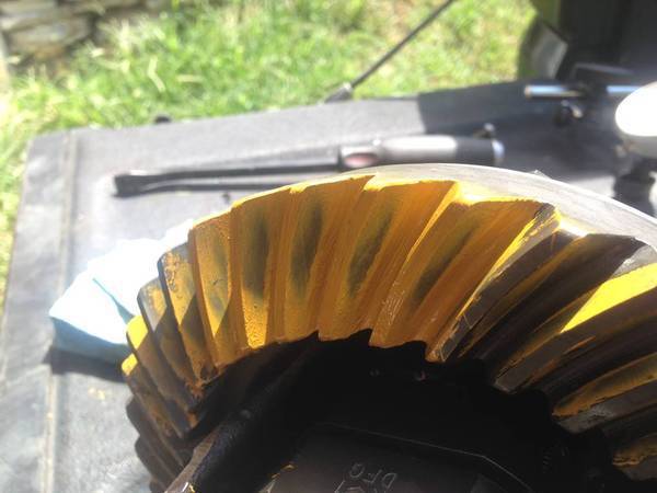

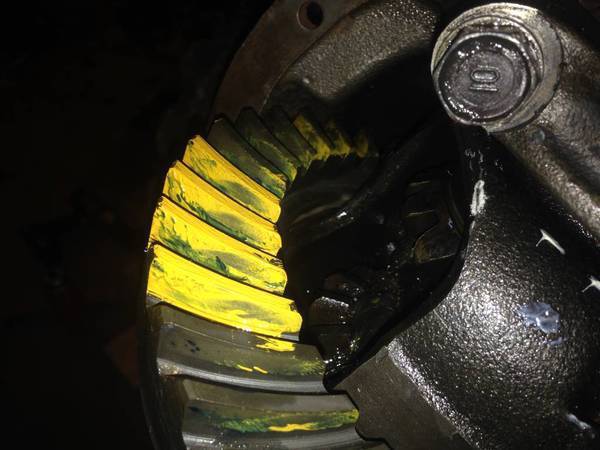

    Got 1 third member done. Took about 4 tries to get it right but the big issue is that I didn't keep my pinions separate so idk if I have the motive or the yukon pinion in there. I have the yukon ring gear on the one assembled diff and I don't know if I'd be ok to run it or not. I'm going to call ECGS Tuesday and ask.
    Drive pattern
    Coast

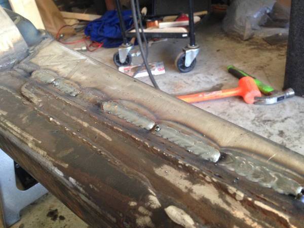

    Some of the welds on the top truss
    Hung it to make sure I was welding the upper knuckleball gussets/shock mounts at the right angle

    Burned the shock mounts/upper knuckleball gussets in

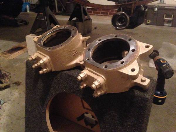

    Ring gears generally have a really tight fit when putting them on the carriers so by throwing them in the oven it expands them just a bit so it drops right on, no hammering involved :cool:

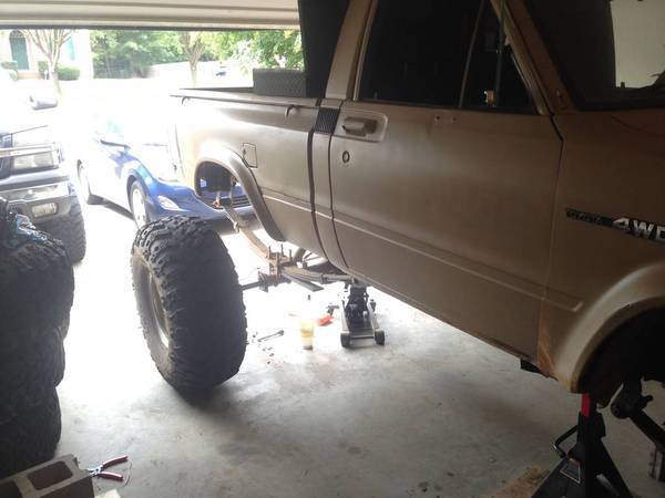

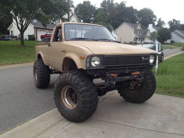

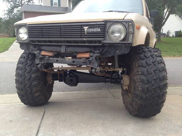

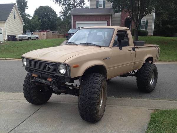

    Time for more pictures! Finally back running and driving. Still have a few things to do here and there. Need to trim the upper knuckleball gussets some more, need new front shocks, carb needs a little work, need to put the front driveshaft in, and bobbing and dovetail is still on the to do list as well.

    tires look super BEEFY in that last pic!

    Ha tell me about it! They are slowly growing on me

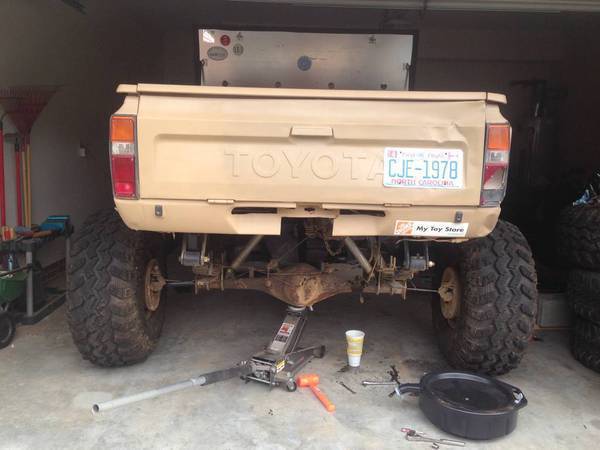

    Bobbed 8"
