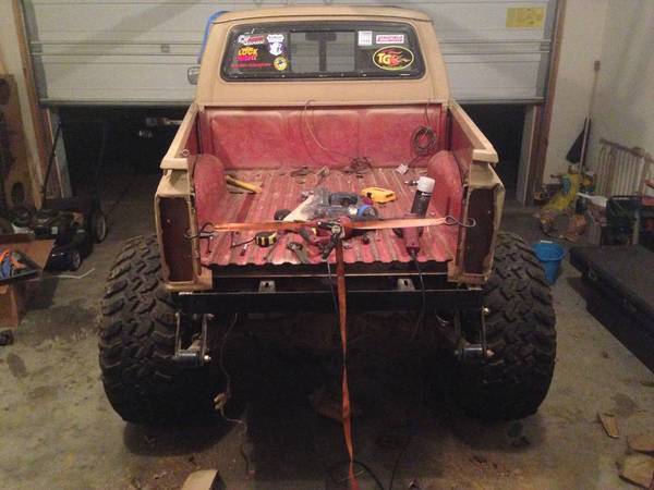

    Got out in the garage for a little bit tonight.

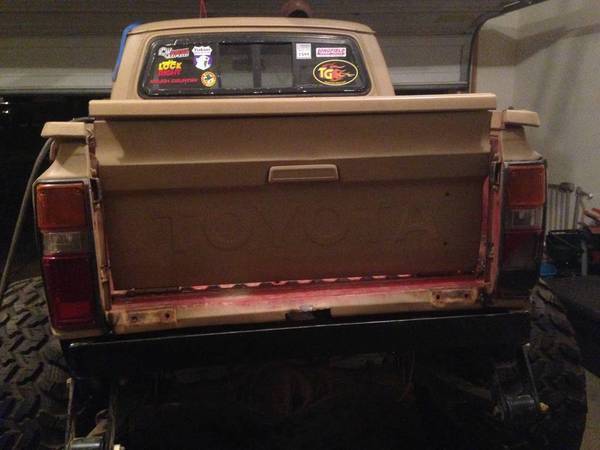

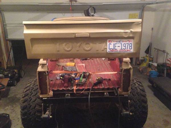

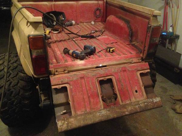

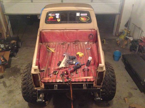

    Damn I hate welding sheetmetal with a passion... I'll finish up the bedsides tomorrow.
    I have to figure out the tail gate but it's looking like quite the challenge.

    Northeast Georgia
    2015 Tacoma TRD OR & 1985 SR5 4Runner
    Can you take the guts out, measure how much needs to be cut, divide that in half to cut each end of the tailgate by, and cut up the linkage in the tailgate to fit?

    I'd try to keep the toyota and cut out the rest . Of course you would need to measure and see if that would work . Bedside look awesome .

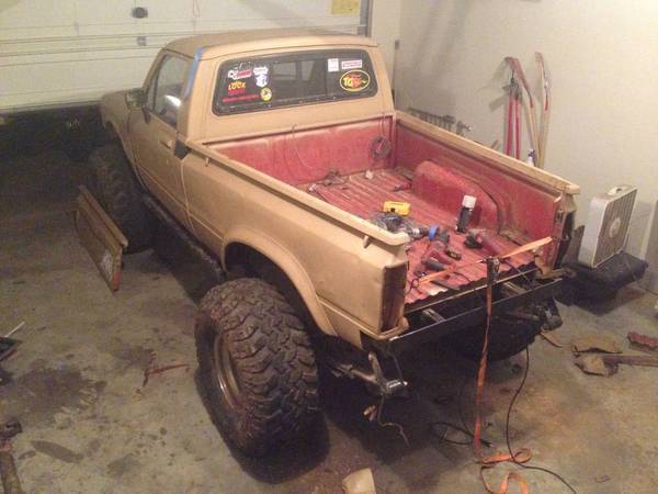

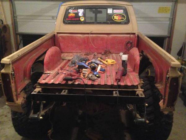

    If I wouldn't have doved so much then yes, that would be the way to do it. There's not enough room between tail light and the hinge to weld the outer section back on. I have already cut the tailgate to width and I'm going to notch the inside and put the latch section behind the skin. I have it worked out in my head haha.
    This is what I have so far.
