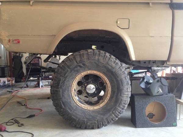

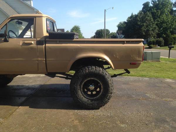

    Got the pickup back on all 4's to check shackle angle and tire position in the wheel well. I'm pretty happy with it but I wanted to get some more opinions before I weld it solid.

    Might be a tad too flat especially if you decide to add constant weight back there i.e. a bumper w/ spare tire. But if you don't plan too then it should be okay.

    The spare tire is actually in the bed in this pic, I never take it out lol. I downloaded a bubble level app on my phone and it said 62* but there's no way that's right. I need to go buy one of those magnetic dial angle finders. I looked at harbor freight last time I was there but didn't see any.

    Looks good to me . Did you run those tires before the swap? Might just be the pic but looks like you might need to trim alittle front fender to stuff them up .
    I have Chevys on my runner and they flex very well .

    Yeah same tires that were on it. I measured the wheelbase the best I could and it looks like the axle is a slight bit forward of where it was (less than 1") but the shackle angle is as flat as I'd like and the shackle hangers are as far back on the frame as they can go so if I move the front hangers back the axle will be more centered but my shackle angle will be wayyy too flat.
    The only way I can think to move the front hangers back and keep a good shackle angle would be to make longer shackles and move the shackle hangers to the vertical portion of the rear bumper. But obviously I haven't made a rear bumper yet and I really don't want to make another set of shackles.

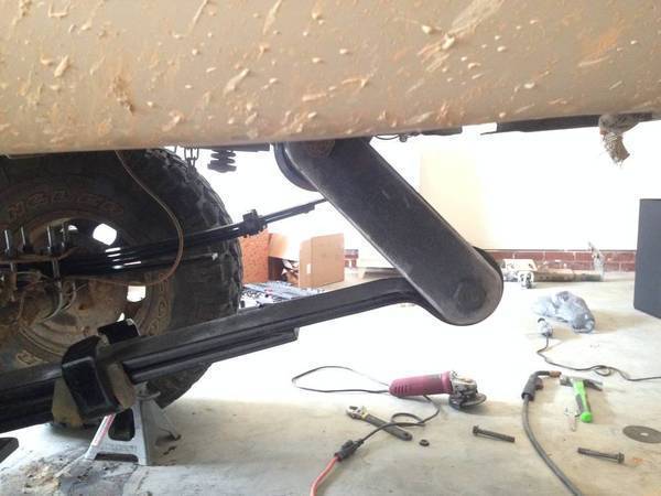

    Like in this picture of the 63's on my Tacoma:

    The shackle would have to go completely in line with the spring for it to have the potential to invert. This pic is at full droop and as you can see there's still a slight angle between the spring and the shackle and since the axle will move towards the rear on compression, it should never invert.

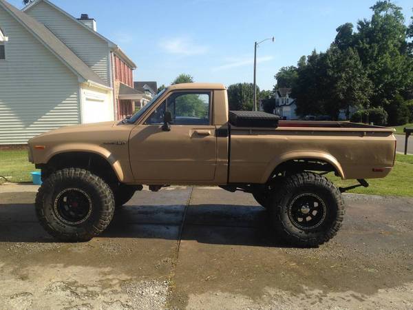

    Took the pickup out for a spin last night! I'm really happy with with how it rides on the street. I may take it to my cousins farm today to dick around but we'll see. Had to bleed the clutch from where it was sitting so long, guess I have a small leak somewhere. Still have some things to do to finish up. Need to hook the e brake up since the lift blocks that were on it were blocking it from being able to be used, going to cut the bpv arm and zip tie it up to the bed, and need to make a hanger for the exhaust. I cut the muffler off because my only hanger had broken and the exhaust tubing bent over against the driver spring hanger and it actually sounds really good with just a catalytic converter. Not nearly as loud as I expected it to be and it has a ton more get up and go.

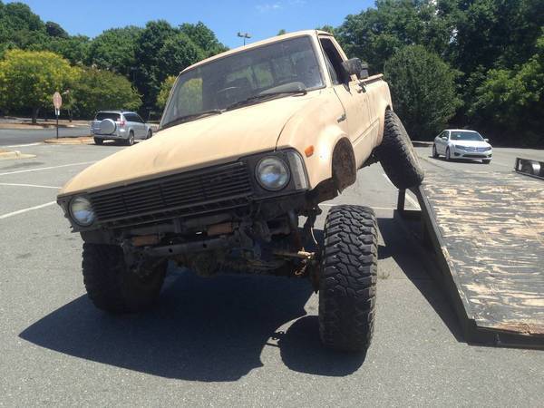

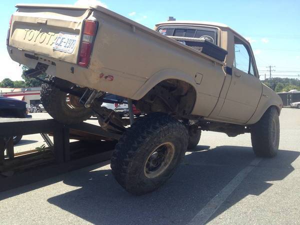

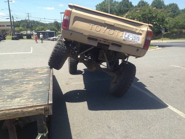

    Went to an atv/motorcycle dealer and used their loading ramp haha. These are pretty much full stuff in the rear but there's still a good bit of droop left according to the shackle angle. The shocks are only 12's and I'm not sure if they are maxing or not. I didn't have a tape measure with me to check
    Ballistic joints

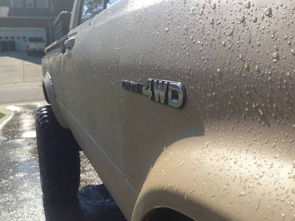

    Washed her up today

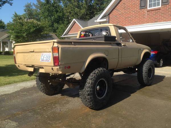

    Shot of the new 63's
