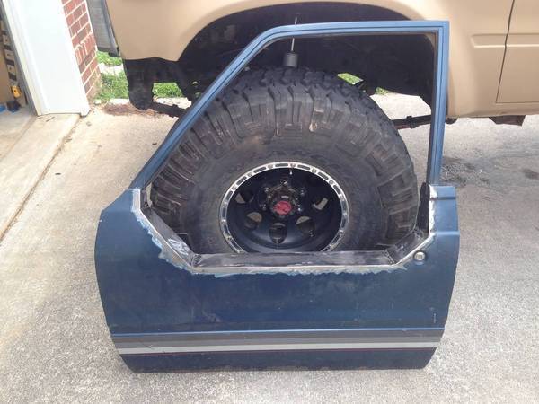

    Finally finished cutting my half doors. Also cut the pins out of the hinges and went to Tractor Supply to get some quick pins but they didn't have the right size. Going to try Lowes tomorrow

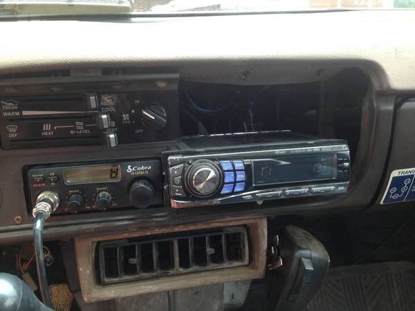

    Finally got some tunes. Whipped up some quick boxes and mounted the stock speakers from the tacoma.

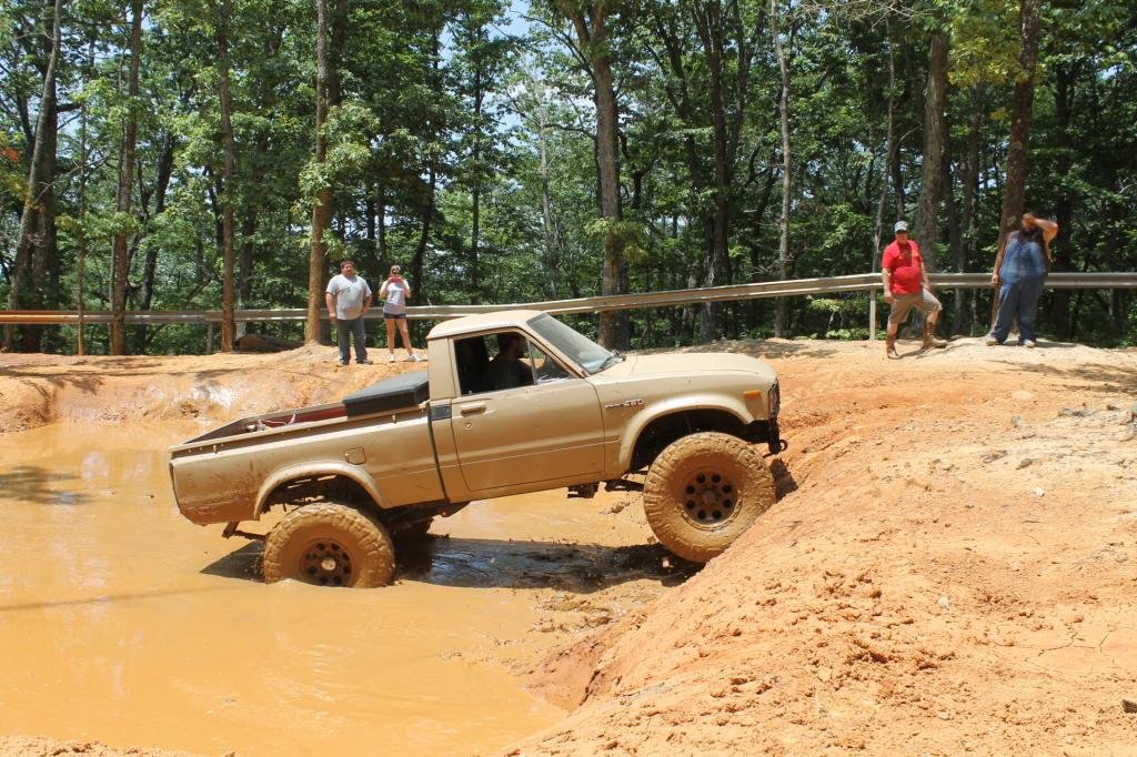

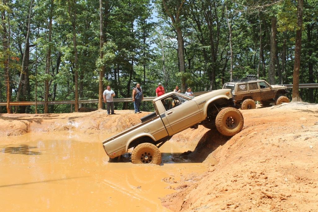

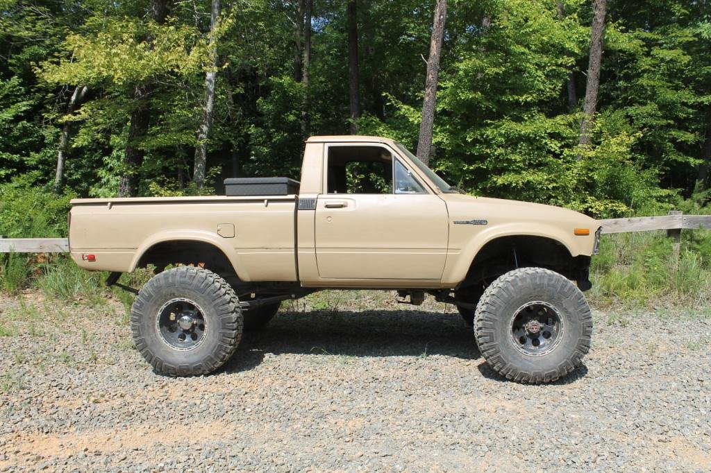

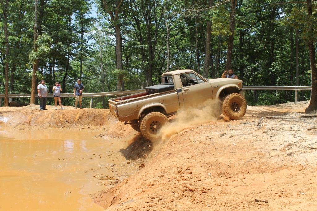

    Went to Uwharrie this morning and played some. Paulo has some good pics I'll post when he uploads them

    A few more pictures that Paulo took yesterday.
