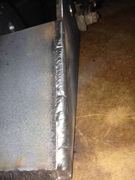

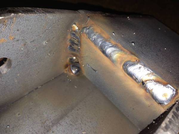

    Went to my buddy's house to work on a few things this evening. Got one of my hangers made and wire brushed and painted the chevys. My friend laid some pretty nice welds.
    These things are stupid beefy.
    Still have to cut the chevy shackles and shackle hangers off the main leafs lol.

    hanger looks good. Personally I would have made it a little longer so the slope is even more gradual. Since you're moving the hangers forward on the frame they are more prone to get hung up on rocks in that new position. Making the hangers longer allows for almost a flat transition from the frame so it will slide over rocks instead of getting hung up.
    But that's getting nit-picky. They look great.

    Thanks man! Means a lot coming from a fabricator like yourself! And yeah the original design I was using was 13" long and while the transition was smooth, I thought it looked goofy :eek:. The ones I made are actually 9" long but that picture makes them look super short. The angle may not be ideal but these things are BEEFY haha. I know they will get beat up which is why I boxed the angled part. Will make it super strong and the hanger wont get tweaked wedging the springs in there.
