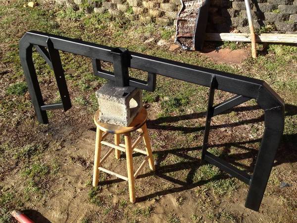

    I've got right at $100 in metal and ~$21 in primer and bedliner
