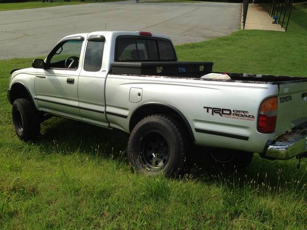

    Here's a teaser till I can get the rest of them up

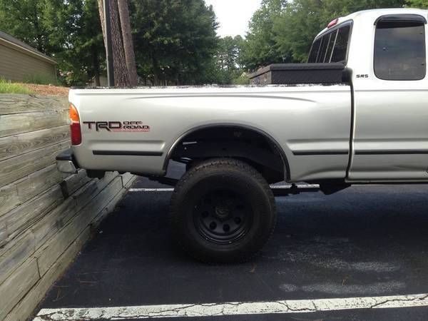

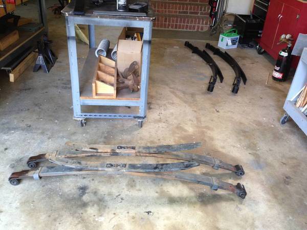

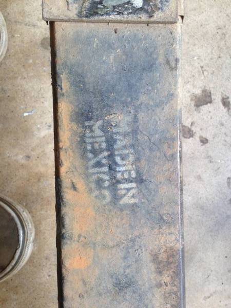

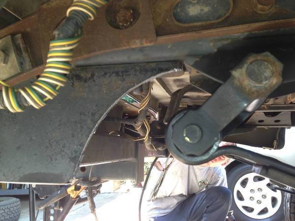

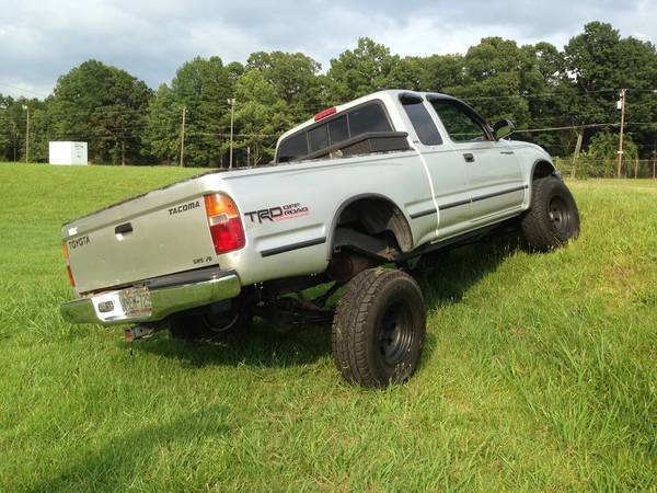

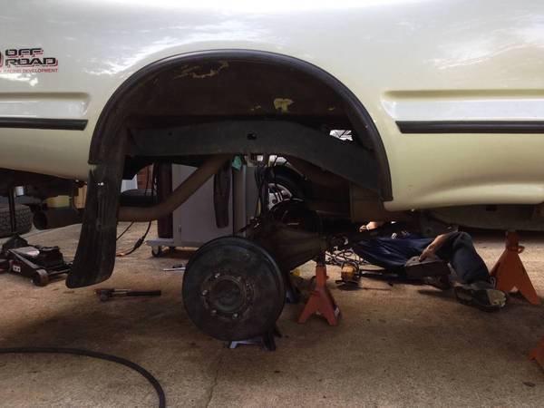

    Here are some pics from today. Only ran into a few issues surprisingly. Had some trouble getting the old brake line out but got it out fine after I cut it in half haha. With the new spring hangers 7 1/2" forward of stock, the axle was too far back and would have serious rubbing issues when at full stuff. Moved them to 8 1/2" forward and it's dead center and stuffs beautifully. The thing I can't believe is that I didn't have a single frozen bolt. U bolts, shackles, front spring bolt, and top nut on the struts all came off with zero problems!
    I did a few other little things while I was at it today. I removed the sway bar, made a BPV extension, extended rear brake line, removed mud flaps, hacked the exhaust, and added a ubolt flip kit.
    Now on to the pictures...

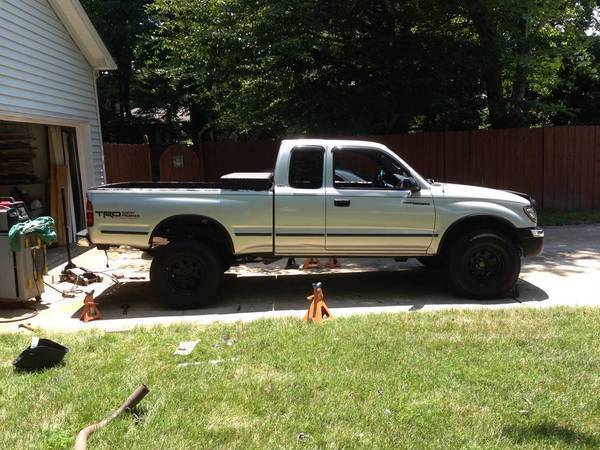

    Some before shots
    Springs out
    Apparently my Jap truck has springs that are made in Mexico?
    Had to clearance my hitch because the shackles was hitting it before it could even settle to ride height
    Rear done

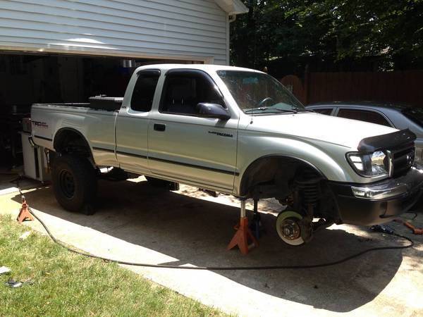

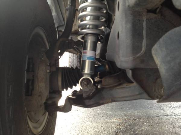

    On to the front
    Didn't get any of the front in progress, my bad! But here it is all done..
    Axle location with hangers 8 1/2" forward.
    CV angle, no diff drop

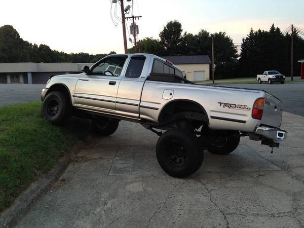

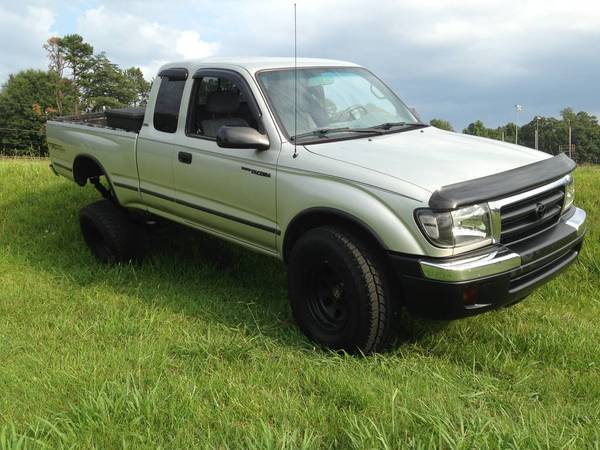

    And some flex shots; Stock shackles and no shocks

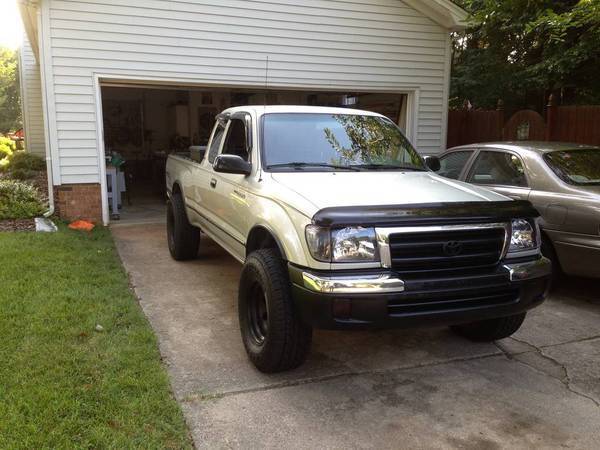

    Before and after shot on the same hill.

    Looking really good with the new set-up! I only moved my hangers forward 7" I believe... Probably because my shackle is 6" long haha :D

    Looks good man!
