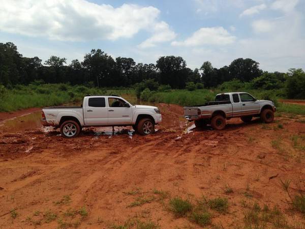

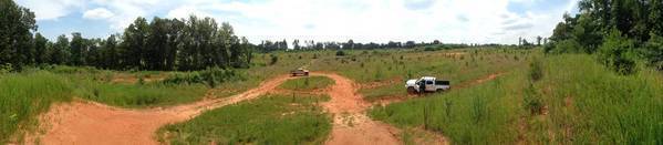

    Went and played around a little today. Wanted to cycle the rear suspension to make sure everything's good. Pretty happy with the droop I'm getting with the stock shackles. I will definitely have to relocate the shocks when I add 6" shackles. In the flex pics I am at 29" eye to eye and full extension is 29.95". A little too close for comfort. I have plenty of uptravel in their current mounting location and am not worried about bottoming out as long as the overload is in there. On to the pics..
    Stuck. He's 2wd but still likes to play haha. Trying to get him to trade in on a 4x4
    Full droop in the next 3 pics. About 1/2" off the ground.
    Full stuff.

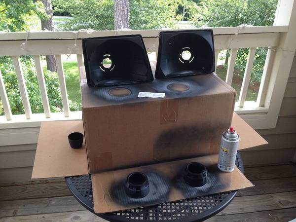

    Retro kit should be here tomorrow so I started working on the headlights. Got the lenses off. Going to black them out but wanna make sure I don't like it the other way first

    Mocked up
    Best I could get it with that dumbass tab

    Well I painted everything flat black. Hopefully it turns out good
