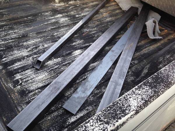

    Bought some metal to build a high clearance rear since I'm off next week.

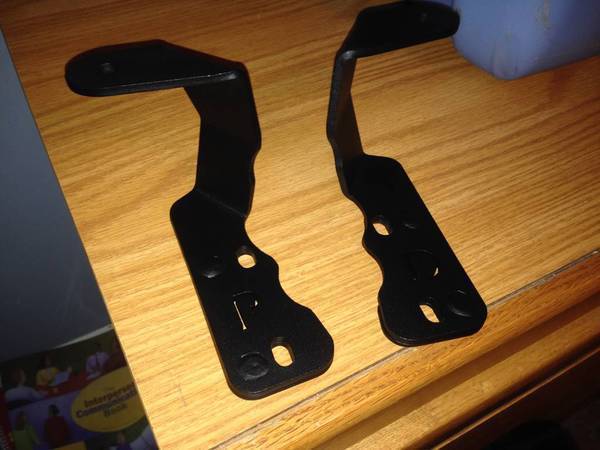

    Worked on the bumper a little today. Eventually will add a receiver, side protection, and a little plating on the bottom but it's about done for now.
    Also got some CBI a pillar light brackets from santa :D
