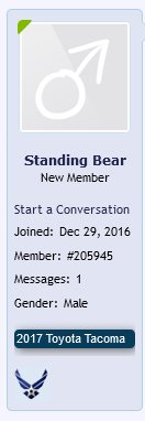

    While you drive a Toyota lol
    And in 1972 we were strong allies with Japan. I'm not quite sure what you're getting at?
    API is an interest group. It's like me saying my tap water is the first household tap water officially recognized by the American Water Institute of kairo. Special interest groups are just lobbying, money, and politics. There's no officially mandated standards for any manufacturer set by the API (to the best of my knowledge). They're big enough that a lot of companies adopt their standards, but they're by no means a regulatory agency.

    Joined 7 years, almost to the day, and the first message is promoting Amsoil lol
