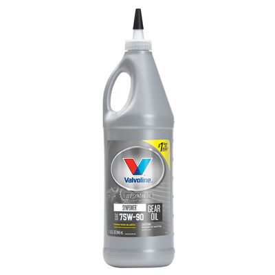

    Well, use the weights recommended in your manual, they might be different.
    This is what I used for the rear:
    This is what I used for the front, I apologize, I guess it was synthetic:
    I want to say they were in the neighborhood of $8-9/quart.
