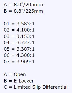

    Found it. Did some research ratio is on the door panel sticker.
    A03C which is (A) 7.5 ring gear, (03) 4:10 ratio (C) 2 pinion limited slip differential.

    Those are for 1994 - 2004 toyota from what I can tell. That generation had the 7.5.
    From another TW post:
    This actually lines up with what is supposed to be in an X-runner, and matches the 03C part of your code. The 3.15 with LSD.

    The "Final Gear" number is the rear end ratio. 3.15:1 is our ratio for all years that the X-Runner was made.
