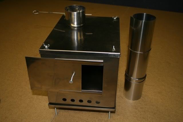

    This review is for a lightweight, packable wood-burning tent stove made by Seek Outside, and can be purchased from www.seekoutside.com. This company is located in Ridgeway, CO, and the product is made in the USA. It is hard to read a review and know exactly what to expect, but I will entertain any and all questions associated with this review via PM, or posts on this thread. This review will be on all of the forums that I frequent. The name of the stove is still up in the air at the moment, but for the purpose of this review, I will call it the VersaStove, which is in line with their single pole, lightweight tipi, named the VersaShelter ™. The 6 man VersaShelter ™ that was used will also receive a review. This stove can be used in a bottomless operation to make a larger burning volume and a lighter product. The stove with accessories weighed in at 3 pounds, 1.3 ounces with a stainless steel stove pipe. Manufactured models will come with a titanium pipe (mine is on its way), which will shave 9 ounces off of the final weight. Seek Outside is still working on shaving more weight from the product in accessories, and the sack that holds the stove. I received a cordura bag for my stove, and I like it this way, so the metal will not puncture the bag.
    Product Review:
    The stove material is almost 100% titanium (ti), with the exception of the threaded legs, wing nuts, and spark arrester. With the stove being made from ti, the weight is lower, and material is stronger. The ti material is up to 45% lighter than most steels, and has a melting point of up to 3000o F, whereas stainless steel material has a melting point of 2750o. When burning the stove, you will still notice the glowing red of the material as it heats.
    This is the stove as a package (I forgot to take a picture of mine, so this is from www.seekoutside.com )
