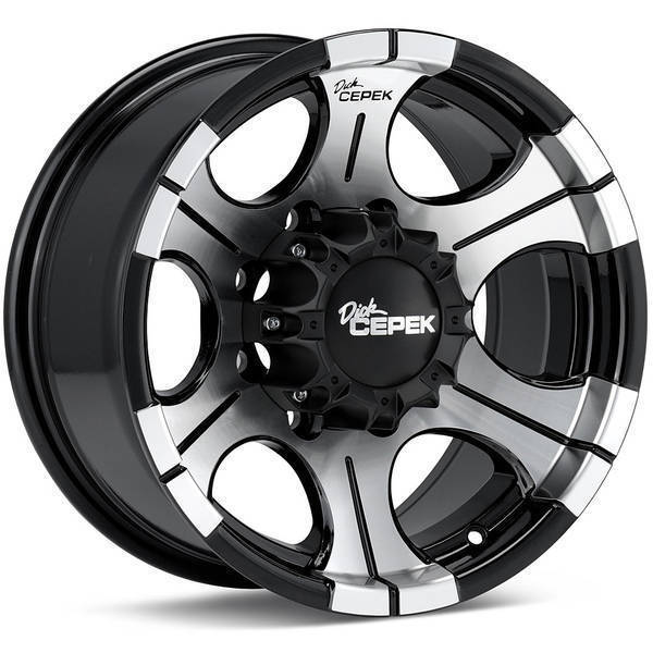

    Dick Cepek DC-2 rims 17X9 and 4.5 backspacing " LUG CENTRIC " If you plan to run these rims I recommend purchasing hub centric spacers in order to get a good balance . The tires stick out of the wheel wells at least an inch and although it looks cool , the additional force they put on the front end makes for a slight wobble at higher speeds . The additonal tire outside the wheel well will throw rocks and scratch your paint . With this said , dont go this way if you are off road .They are difficult to balance and thats using the Haweka adapter ([​IMG] tsu00296.pdf)and road force balancing with hub centric wheel spacers . Keep in mind that our Tacoma,s need a tire rotation every 5000 miles .If you have a lazy or bent steel belt in one of your tires , you are going to hate these
    They are available here for you Canadain guys http://www.softys.ca/wheels/truck/dc2.html

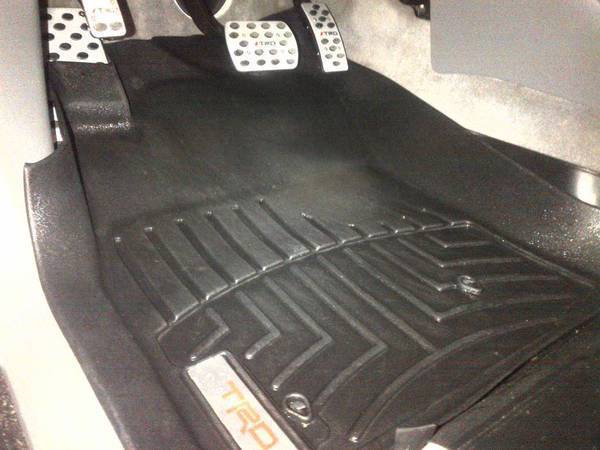

    The above picture shows Weathertech digital floor matts with the TRD logo and TRD pedals .
    These Wethertech liners are the best thing you can do to keep your floor clean .Highly recommended .

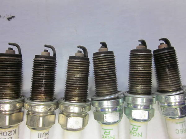

    Spark plugs at 100,000km or 60,000 miles .They are the factory plugs . 3 desno,s and 3 NGK .They were not replaced at the dealer during the 60k service even though I was invoiced for them . Notice the gap,s are far greater than .40,000
