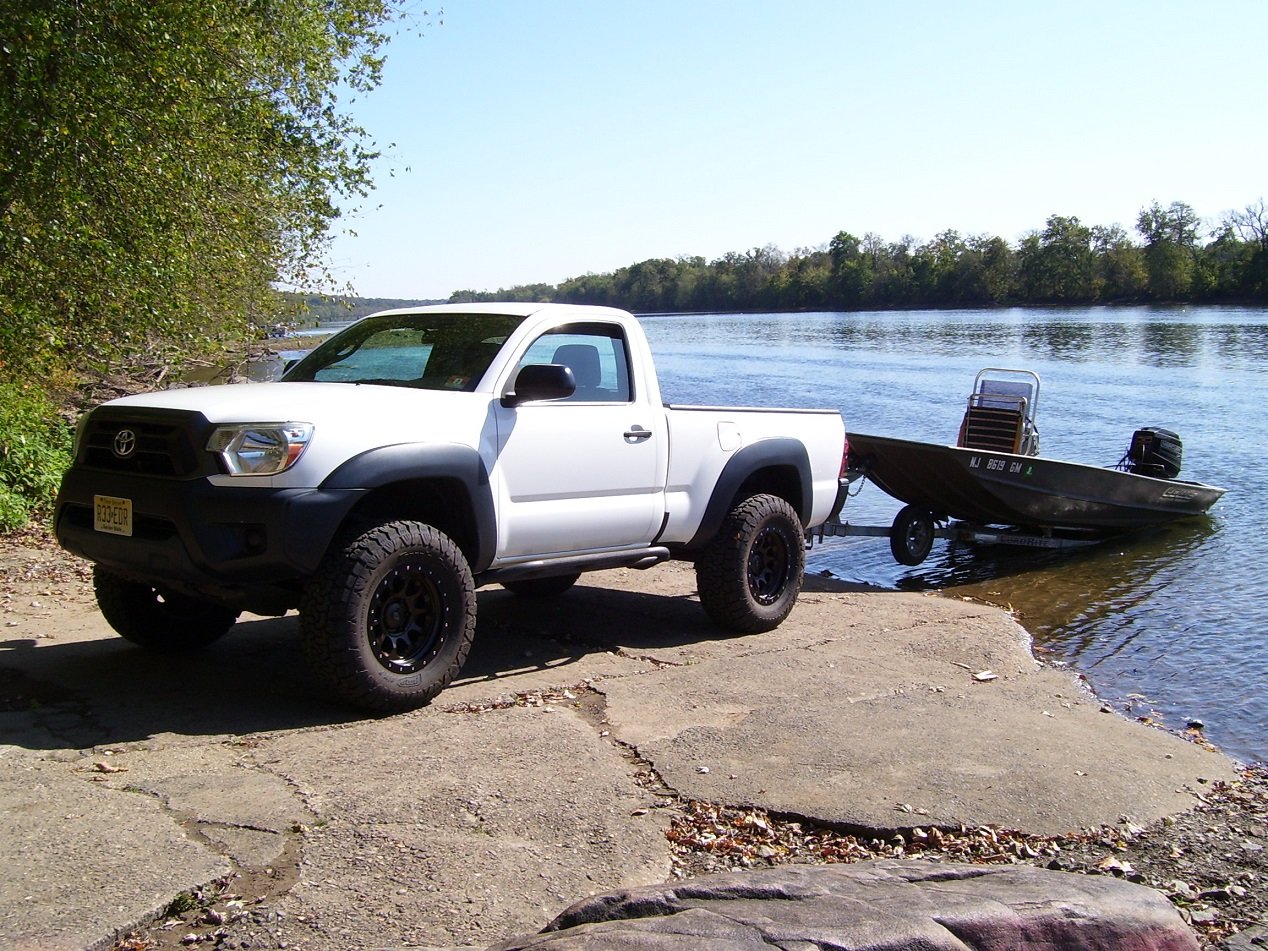

    What are your stock gears, 4.10's? I'm running 305/65/17 which are about the same as the 285's and with the stock 4.10 gears even with the automatic it's fine. But I'm also lighter with the reg cab.
