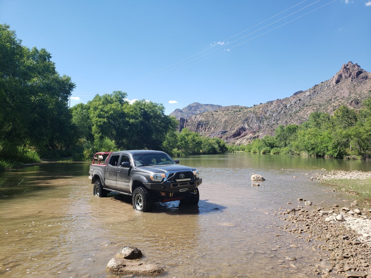

    4x4 sr5 TRD offroad
    Brute Force Fab front& rear bumper with winch, sliders, skid plates by Relentless, tires 285/75/16" , wheels by SCS , CB Stryker SR497 etc

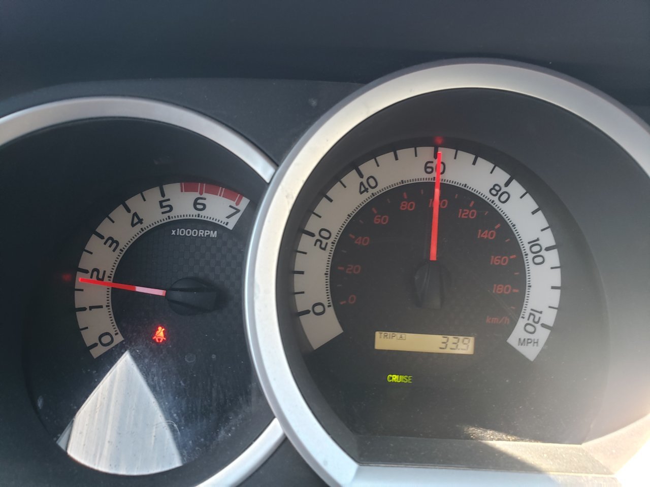

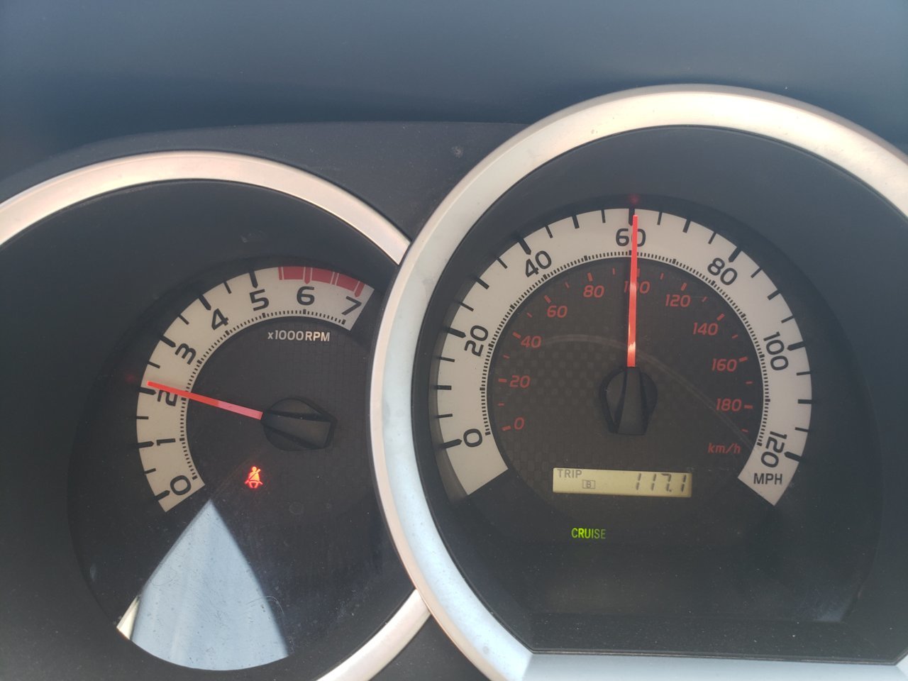

    I just regeared to 4.56 Yukon. I'm on 33's with supercharger 4.0L V6. So far it's a good match. About 200 rotation difference st 60mph witch actually closer to 64mph.
