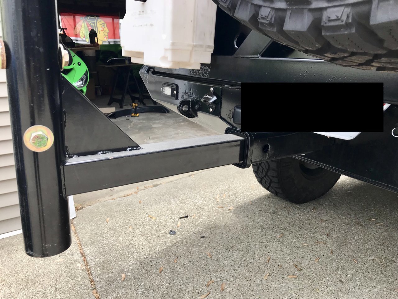

    Few updates from yesterday:

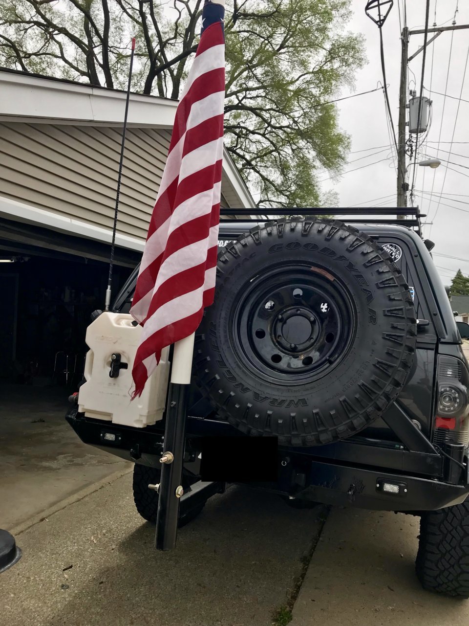

    First up was testing out the hitch extender. This will only be used for the flag mount I have :oldglory:

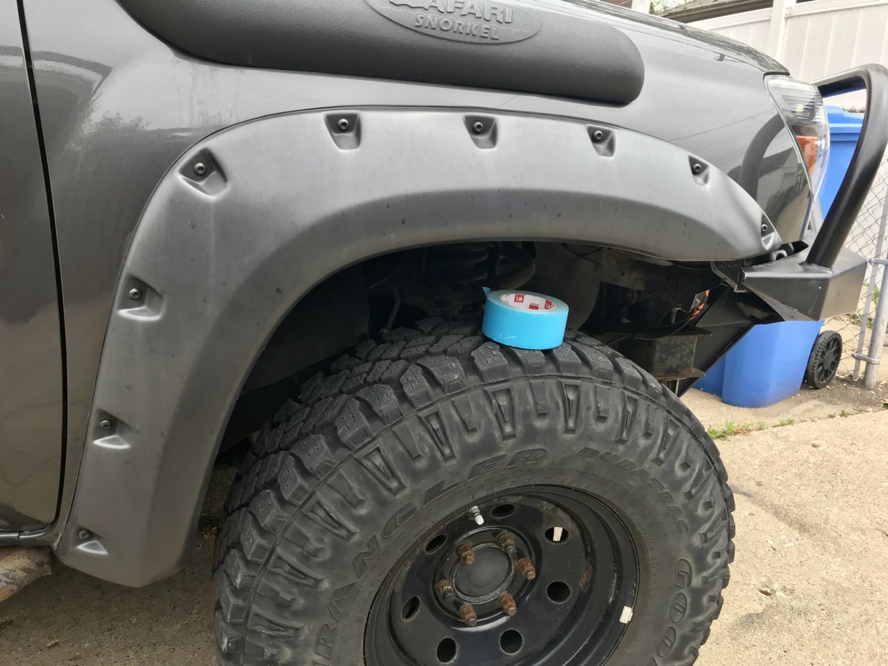

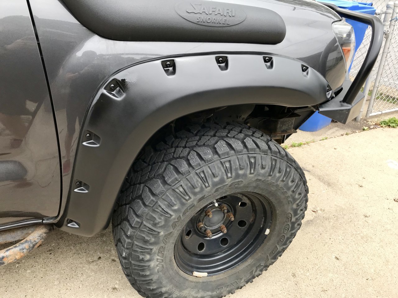

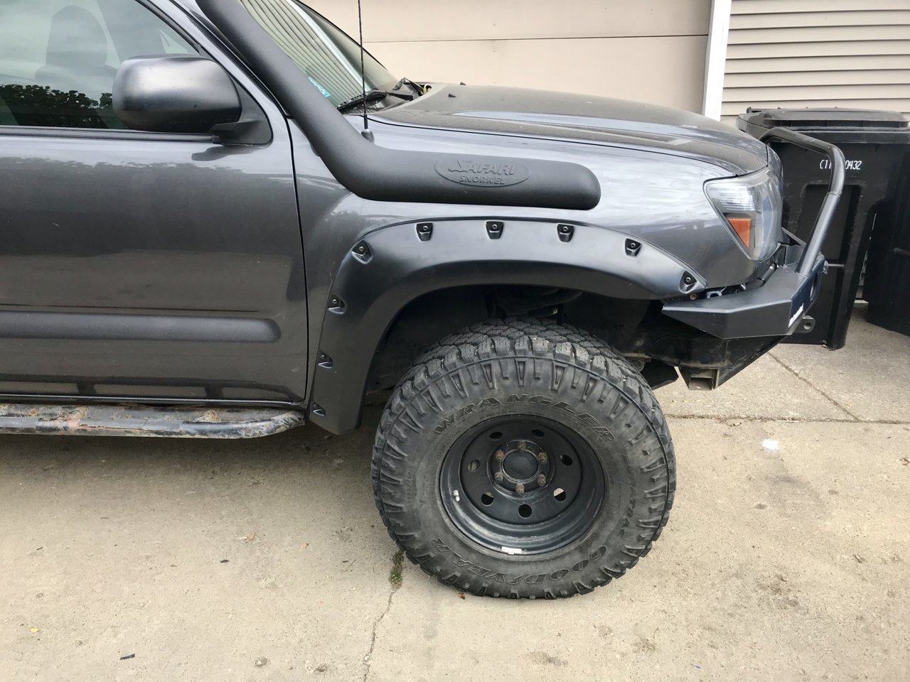

    Next was the fake bushwhackers. The only problem I have with them besides fitment in the rear (none of the holes line up except for two) is the fading. Removed the rear flares to paint them since, again, it's only two bolts and masked off the fronts so as not to have to remove and reinstall ~ 20 bolts:
    WHEN FIRST INSTALLED (then) :
    BEFORE (present) :
    AFTER:
    Used plastidip because haters :luvya:

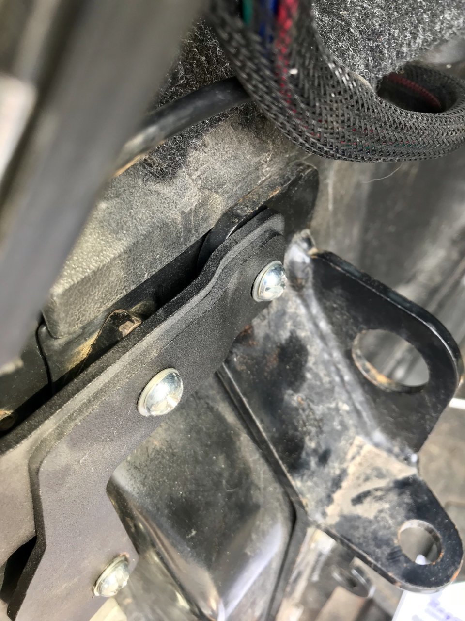

    Next, I tried drilling out the stuck bolt that snapped when we installed the bumper. I'm 95% sure that the replacement bolt I ordered is the right size. Got pretty far but just stopped as I was short on time and was getting frustrated with it.

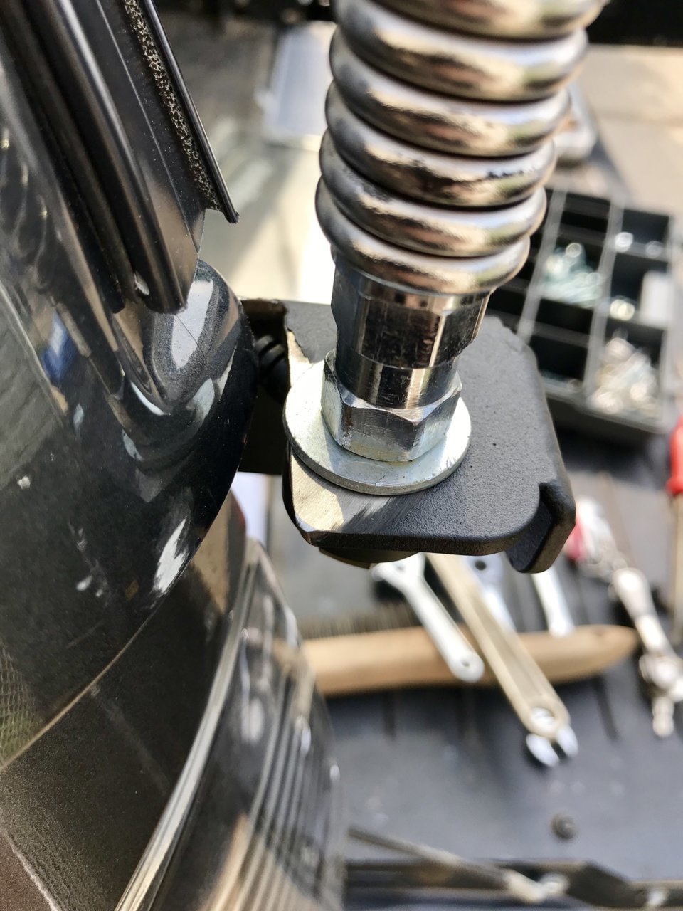

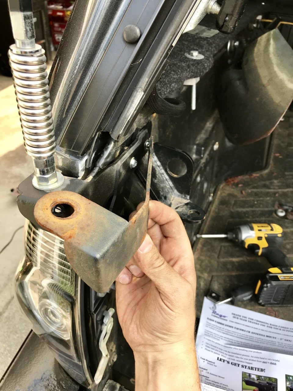

    Next was installing the Rago fabrication stainless steel CB antenna mount:
    Old versus new:
    Took a little massaging with a grinder due to having a camper shell. Luckily it's stainless!!
    Needed to use some longer bolts and some spacers that needed to be removed later otherwise the tailgate would close. This brackets is beefy and more stout than the old one:
