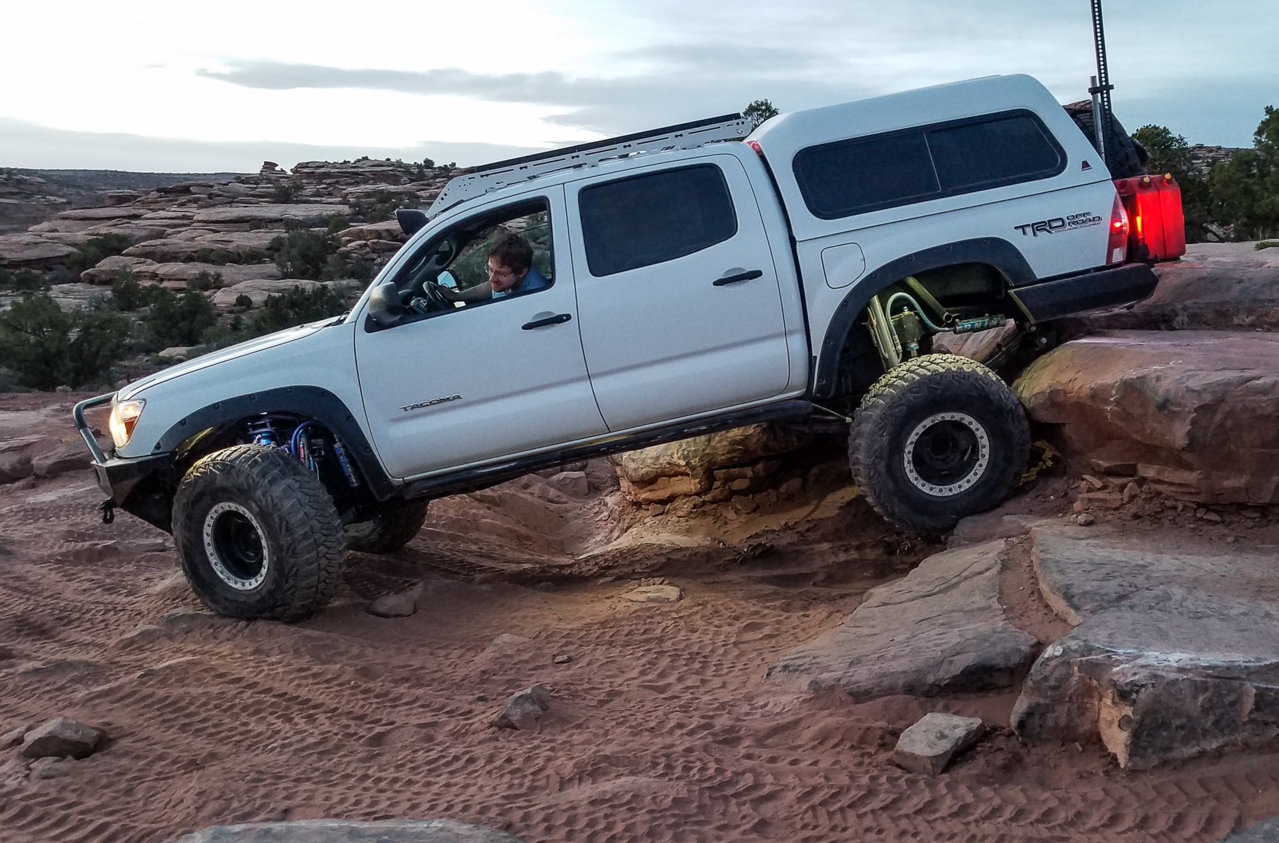

    I'm down with the shackle flip. I never compared my dakars and B110s and stock shackle vs dakars and b110s and shackle flip, but it'd be interesting. I have no driveline vibes having a custom 1 piece driveshaft lol
    here's @Subway4X4 running that setup with a lot of droop

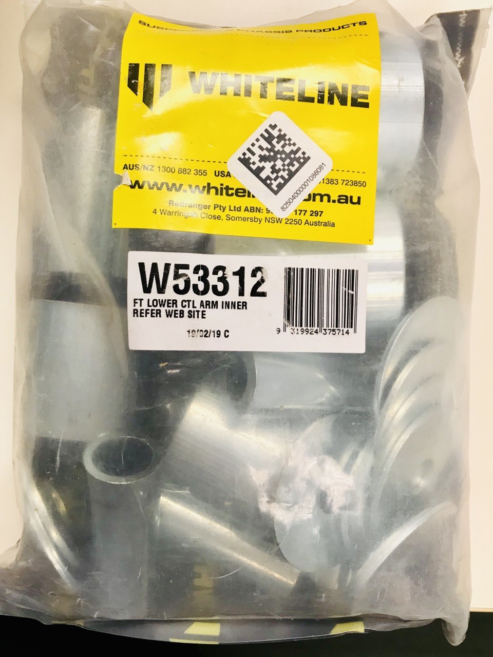

    Got the white line bushings delivered yesterday
    Event/shop to-do list:
    - BAMF brace tacked up; leave for them to weld up
    - drop off LCAs and bushings to be pressed in
    - show off Marlin kit and get a quote
    I have a few feelers out for front ADS extended coilovers, rear 12" KONG RR's and Deaver U402 stage 3's. Front coilovers and the Deavers are the priority; even just the Deavers. Rear Kongs can technically wait as my brother will be selling his, but I can't wait forever.

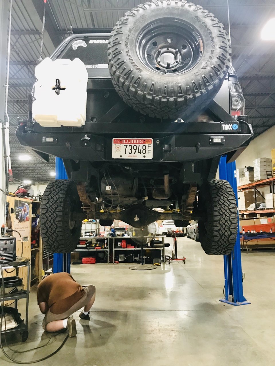

    @jberry813
    "yOu CaN't GeT aNy DrOoP wItHoUt A sHaCkLe FlIp..."
    Flexed perfectly. Had to modify the driver's shackle bolt because it was rubbing on the hanger. No biggie.
    Got the crossbrace finished and welded up!! Just need some paint!!

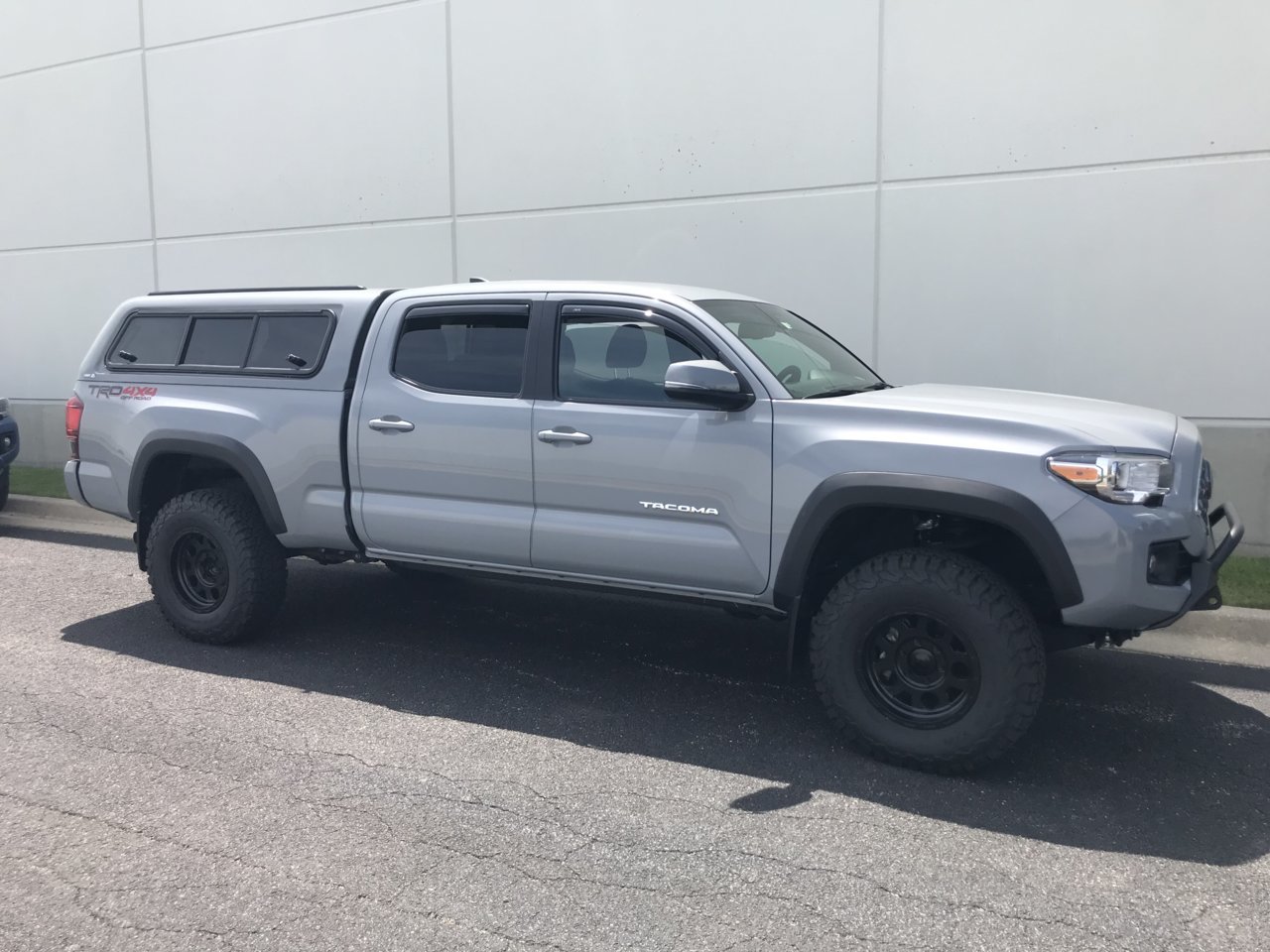

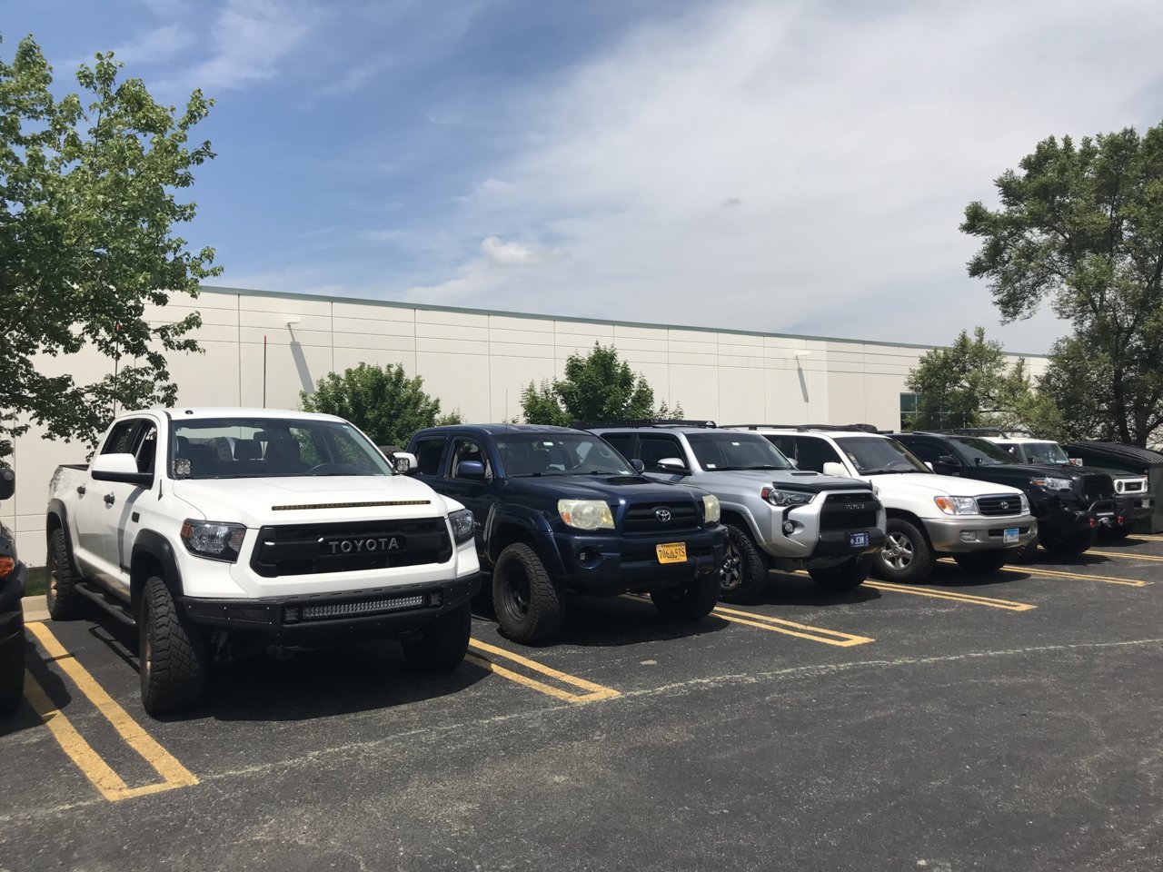

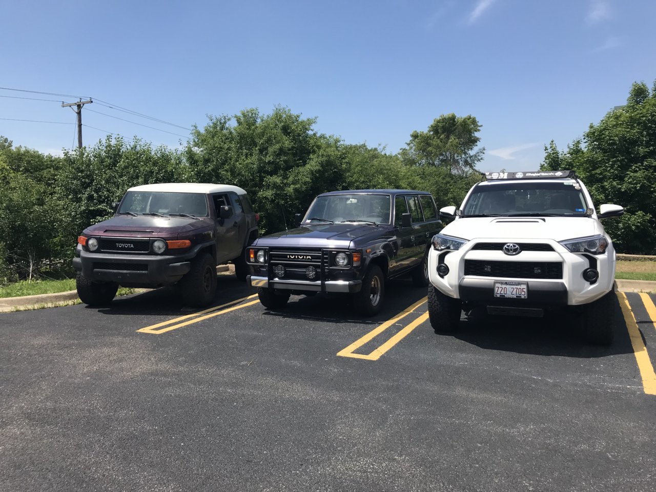

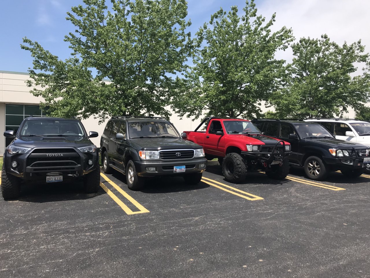

    Open house pics...
